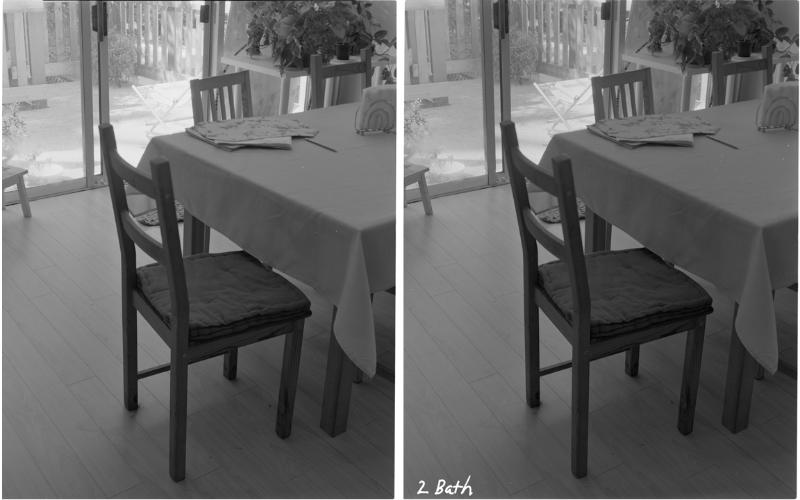

This is an old thread but what the hey! Dug up a test I did comparing 2-bath and single bath. Film was HP5+. Done with BTZS tube. 1+10 for the two-bath. 6ml of A and B, each in their own cap with 60ml water. Temperature was held at 24C. Water presoak was given at same temperature for 3 minutes. Cap A got 5 drops of Drywell (Fuji's version of Photoflo). Film received vigorous agitation in both A and B, 5 minutes each.
For single bath (image on the left), BTZS tube as well, I gave N-7 development, which in my case is 4 minutes at 21C. No presoak was given.
Both negatives look very good. You can clearly see the 2-bath negative's highlight compensation. I should also add that I placed the darkest shadow under the chair on zone V. About a stop higher than normal.
These are straight scans. Only the black and white points were touched in the scanning software.
