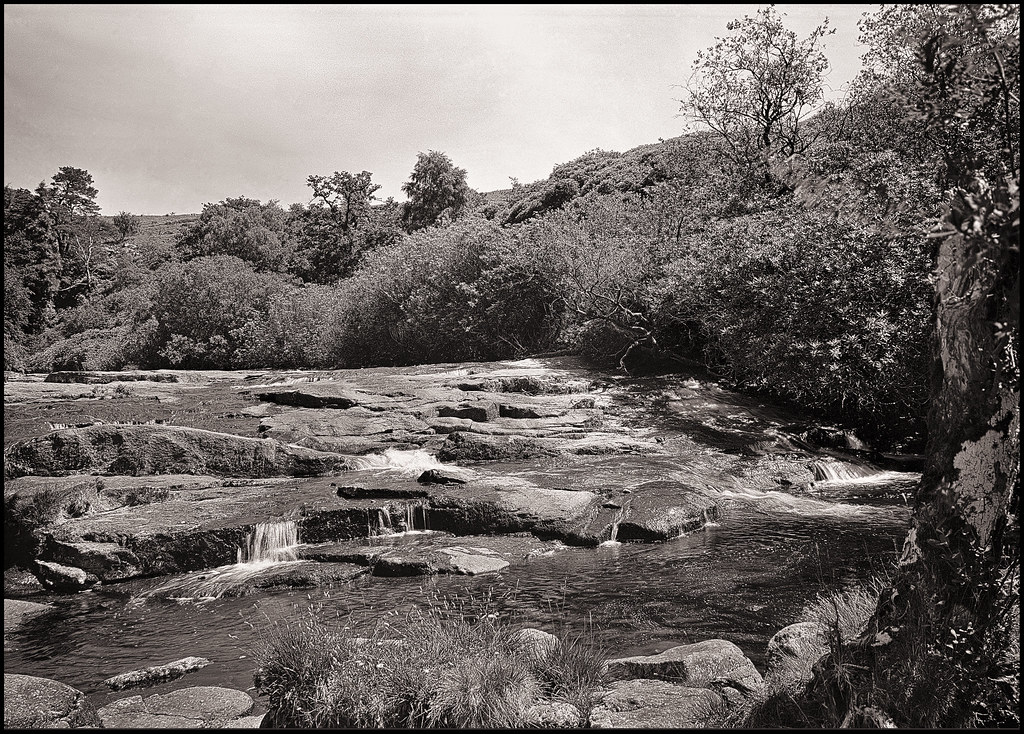

I used Divided Pyrocat HD as I wanted to see if the Compensatory Action would prevent the whites being completely blown out which is normally what happens with this type of image. This actually worked better than expected and I actually had to add a little contrast to give it a slight lift. I metered using my Minolta Spotmeter F from the shadow area in which I wished to retain some detail and then closed down 3 stops from that to get my taking exposure.
5"x7" Fomapan 400 @ ISO250, 1/8 sec @ f32, Divided Pyrocat HD 6 minutes both solution A+B at 25° C. Wollensak WA Raptor 6.25inch f9 (80+ year old non-coated lens)
Steps, Avon River, Devon. by Ed Bray, on Flickr

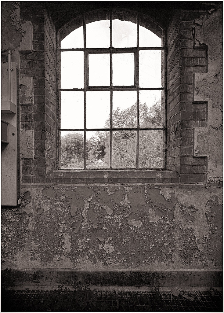

And in the one below the contrast between the outside through the window and the detail in the building was huge.
Window, Old Filter House, Tottiford by Ed Bray, on Flickr

The best range I actually managed was on the internal shot of the Window, Old Filter House looking out of the window, the marks shown in the top of the window are from the skylight best seen in the Redundant Filters Image above it. The dynamic range of the grating inside to the outside was amazing and with most other developers would certainly have been too much for them to handle.
