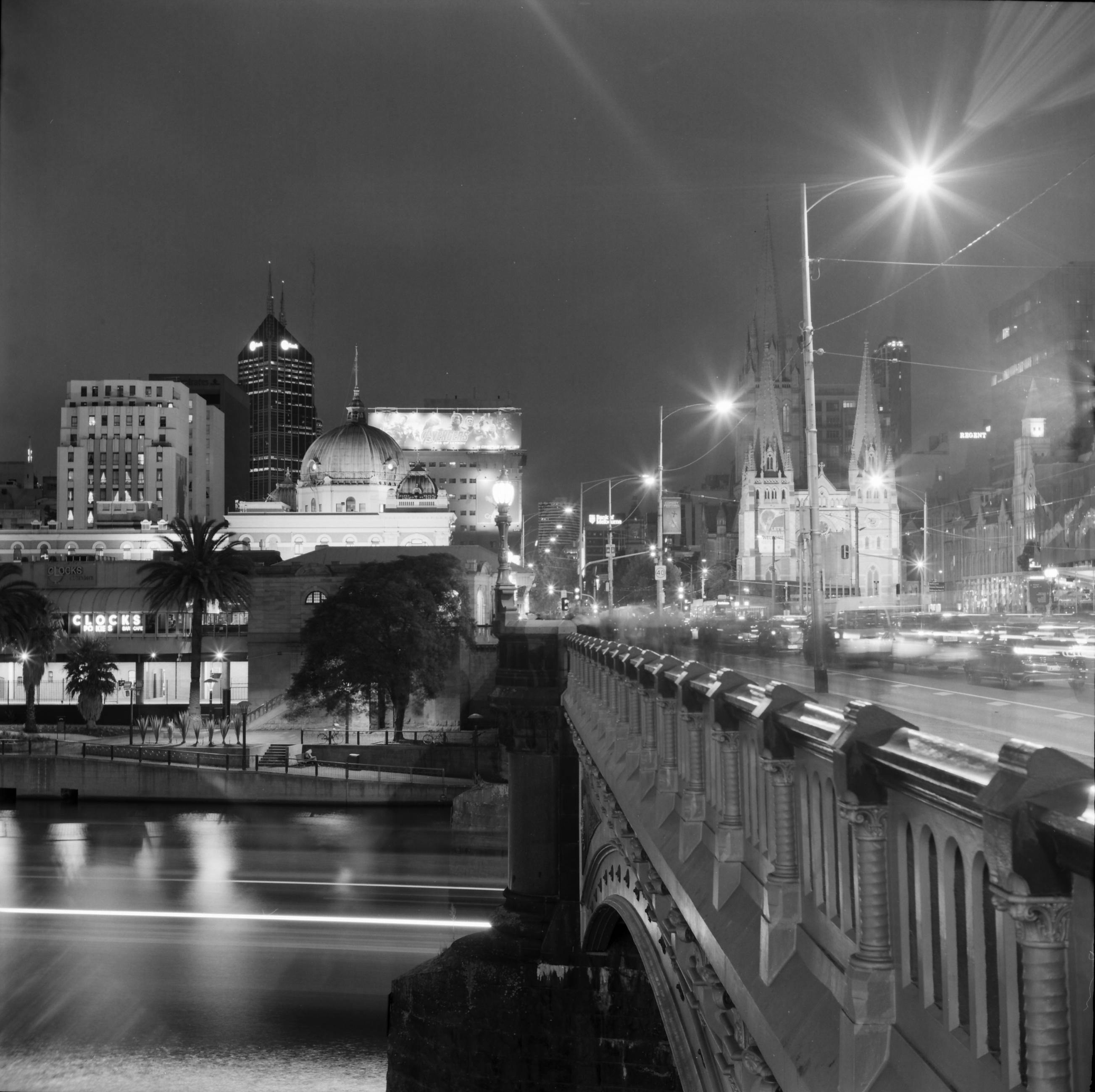

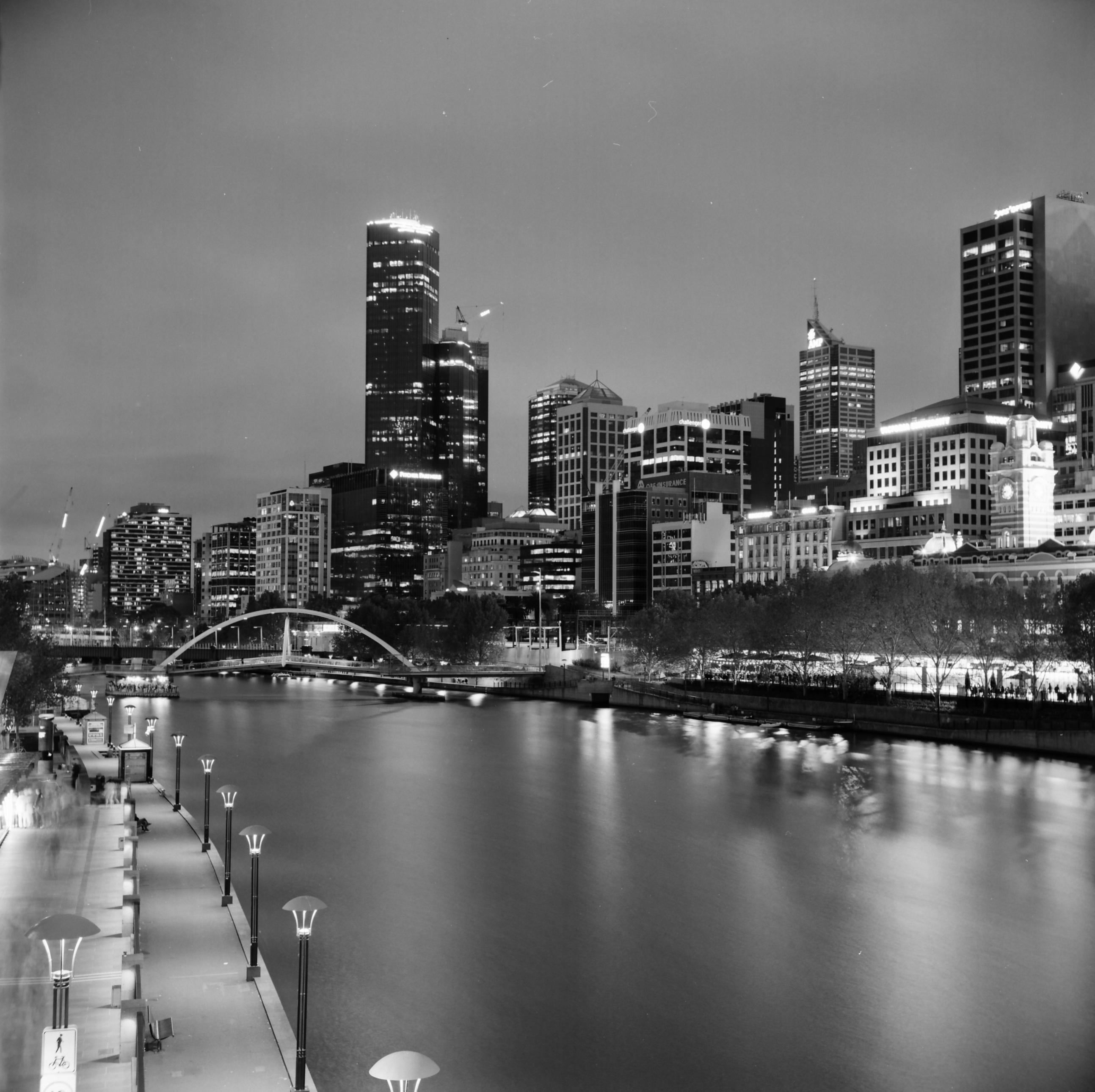

I have tried Divided D23 as per the Anchell recipe (Solution A 100g sodium sulphite, 5g metol) with 4.5g of sodium carbonate in solution B, with Fuji Acros 100 120, EI 100. I gave 3 minutes each bath continuous agitation. I was quite happy with the results, as it seems the give good shadow detail, and the highlights were overblown. I have attached two example below:
attachment.php
attachment.php
As I understand it, changing the accelerator in the second bath to a more or less active one will increase or decrease contrast, and the time in either bath affects the overall density. I read somewhere else that with this developer, bath A will develop the highlights, and bath B the shadow areas.
My question is, which of the variables would allow me to increase the EI of my film? that is, primarily increase development of the lower zones? I am wanting to see if this developer can push TMY 400 to 800 or 1600. Has anyone tried pushing with this developer? In the past I have been pushing TMax films using TMax developer using minimal agitation at 1:7 dilution, but even then highlights can be overdeveloped. I am not greatly concerned by an increase in grain.

simgrant,
I would say no, don't look to push TMAX400 to 800 or 1600 when doing this kind of work.
The photography you are showing, night photography with mix of natural and street lights, isn't the kind of photography where you "push".
Do what you are doing here, exposing adequately to make the scene visible allowing additional exposure time to overcome reciprocity law failure, while developing in divided developer to prevent the highlights getting too well-developed (because relatively-speaking, highlights didn't get affected as much by reciprocity law failure).
Push processing is for a different style of night photography, where you don't care about how dark the scene looks because there is a dominant subject in somewhat brighter light.

Thanks Bill,
Yes, I probably misled you about my intentions by showing this photo. For ones like this I would always do a very long exposure with small aperture on a tripod. The long exposure hides people walking into the scene a bit. BTW I used Acros due to low reciprocity failure for this photo.
However I usually only push when I want to shoot indoors handheld, where I am not concerned about grain or depth of field. I was more curious than anything else with regard to how Divided D23 might be pushed, as you can push with most other general purpose developers such as D76 by developing longer and/or warmer. I seem to recall something about D76 giving greater film speed when developed longer and diluted, with an increase in grain also.
