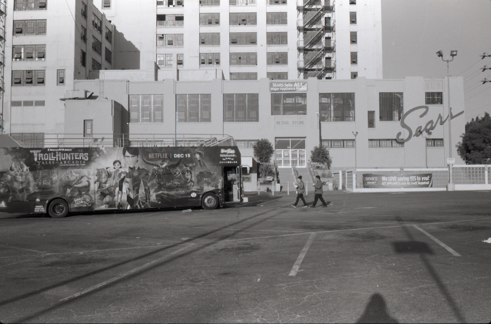

Hi, I'm a recent rangefinder user. All I could afford for a first lens was the Voightlander 35mm 2.5 pancake, which is fine for 90-95% of the pictures I make. However when I am photographing close, say 5 to 20 feet away, objects with straight lines near the edge of the frame are being curved like the below examples. I'm considering burning my tax return for a pre-asph summicron. Would anyone be willing to post images similar to these below taken with the non asph summicron and showing how it handles straight lines close up such as these? I don't think Sean Reid's test images show this...Thanks in advance.

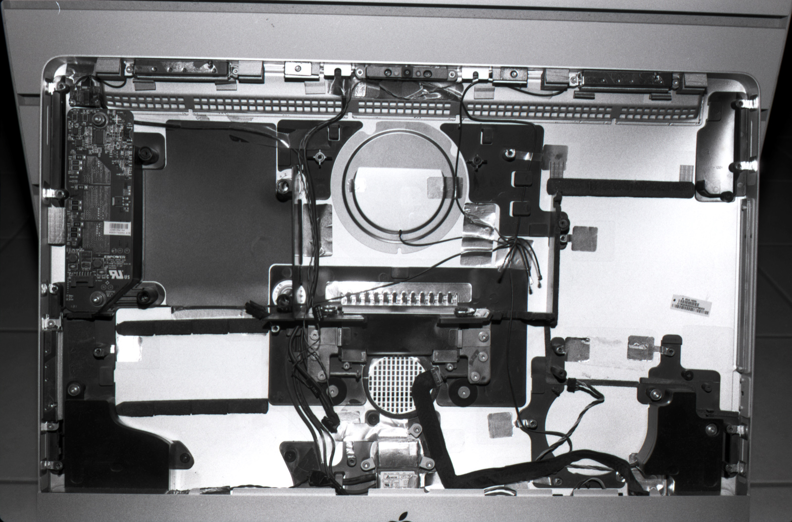

Eric, wasn't sure if your initial comment was mildly condescending. If I was mistaken and overreacted, I apologize. The pitchers below still show some tilt, (seems nearly unavoidable w handheld rangefinder) but are a little closer to being straight. I know I shouldn't worry about it too much, and that none of these pictures would be transformed from humdrum to masterpiece without the curvature, but it does bug me a little. I'd almost adjust my initial #s and say it seems to effect 10-15% of my shots. You're right I should just not worry about it and be outside exposing film instead of resizing scans to post here! But as I said, I can't help but wonder if the summicron would make me sleep better at night.
Oren, Thank you for the comments, going to try and buy that book.

If you are planning some copying work in the future, get a macro lens, those are corrected better for distortion. Otherwise, I don't see anything wrong with the posted images. I kind of like the second one. Reminds me of my last week, rebuilding my last computer that will still run 10.6 and all the software that won't run on the new machines.

Firstly, the distortion you are seeing is "barrel distortion", it has nothing to do with parallax and it isn't curvature of field. The converging or diverging is caused by the film plane not being parallel to the subject plane.
That seems like a fair bit of barrel distortion for a modern 35, more than my 20mm Nikkor which is a 50 plus year old design.
One RF 35mm I have used which displays virtually no distortion is the Jupiter 12, an FSU clone of the prewar Zeiss Biogon and a non-retrofocus design.

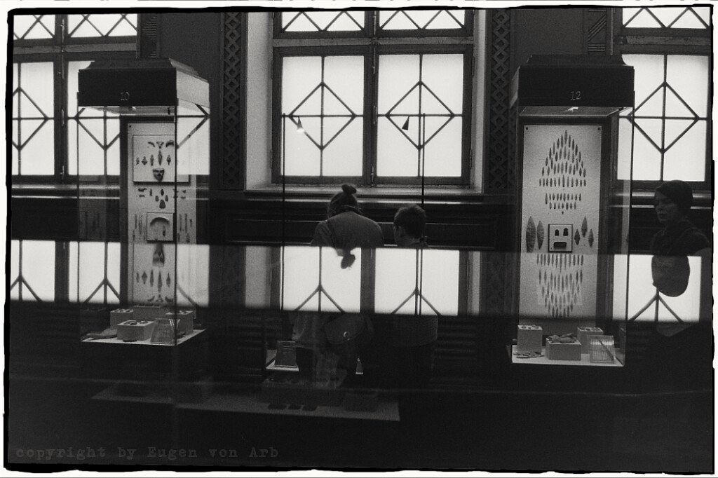

This looks like your's on the left edge:
000040 by nan wang, on Flickr
I wonder if there is quite a bit of variation between examples of this lens? Quality control issues maybe?

I wonder if your lens was made with digital in mind? Because I have noticed large amounts of barrel distortion and lateral chromatic aberrations in later digital lenses, particularly zooms. These issues are easily corrected in the processing software, but are real problems when that lens is used on film.
One of the advantages of using a rangefinder is that retrofocus wide angle lenses are not necessary, hence far less distortion.
Your lens shows more distortion than any Nikkor WA I use, from 20 to 35mm, all of which are retrofocus designs from the 60s.

I would say that the item near the left edge of the example you posted is a mirror, and may not be parallel with the wall behind it.
There are so many sources of potential distortion in that scenario - I don't believe you can reliably glean anything from it with respect to the performance of the lens involved.

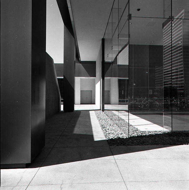

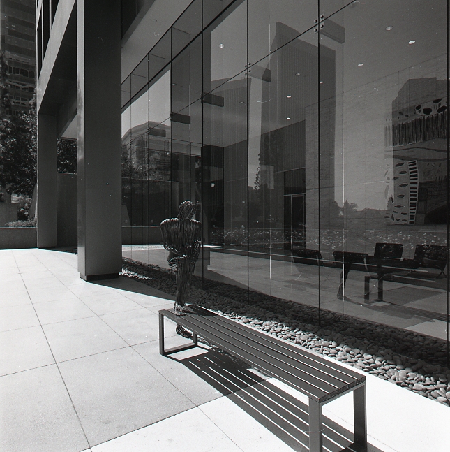

I see some barrel distortion. If I am concerned about distortion for a wide angle photograph I use the Zeiss Biogon 38mm lens which is not available for your camera. When I am back to my main computer and if I remember I will post one of its photographs.
Here are two examples of this lens which is rectilinearly correct.
If I am not mistaken the 35mm Zeiss Biogon f/2 has super low distortion. I just looked at images from mine and it doesn't have any that I can see. I used to have a Summicron which I think was V3 (the one with the tab for the aperture) and I compared them after I bought the Biogon. Wasn't even close. Sold the Summicron.....
