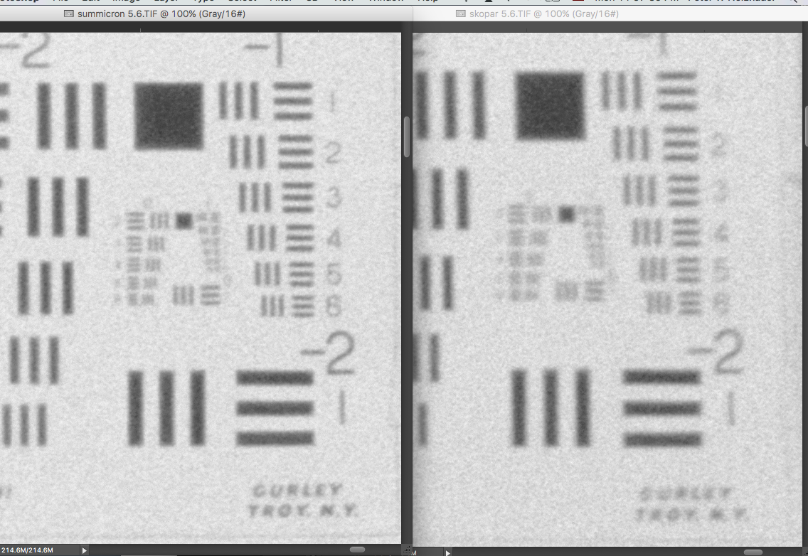

in case it's useful to someone someday here's a comparison of the 35 skopar 2.5 and a summicron 35mm v4. Both at F 4, from an 8000 dpi drum scan.
I was mainly testing for resolution here, not distortion but if you look closely you can see the summicron has less barrel distortion.
Interestingly, when really pixel peeping on my resolution targets, the skopar out resolved the summicron at all apertures in the middle of the frame. Not by much but it won every time in a side by comparison. BUT as expected the summicron blows the doors off the skopar in the corners through F8, not even close...the second screenshot is from the upper right corner of the frame at 100%

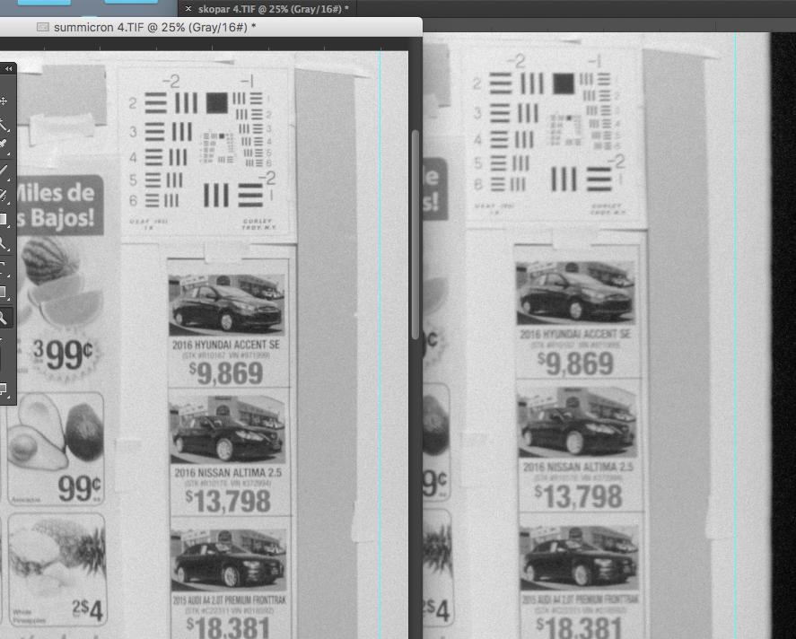

full image, and center crop showing middle left target

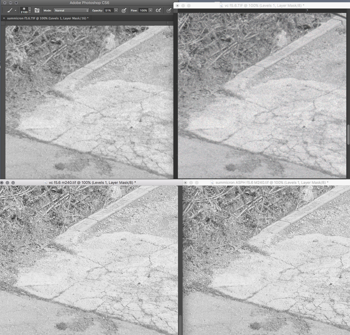

summicron f5.6.jpg Screen Shot 2018-05-11 at 4.47.34 PM.jpg a less scientific test using the same VC lens and a friends borrowed 35mm summicron Asph F2. curious if mods will take this down. some small rocks seem to evaporate on film version. However real test would be to make side by side full sized prints.
