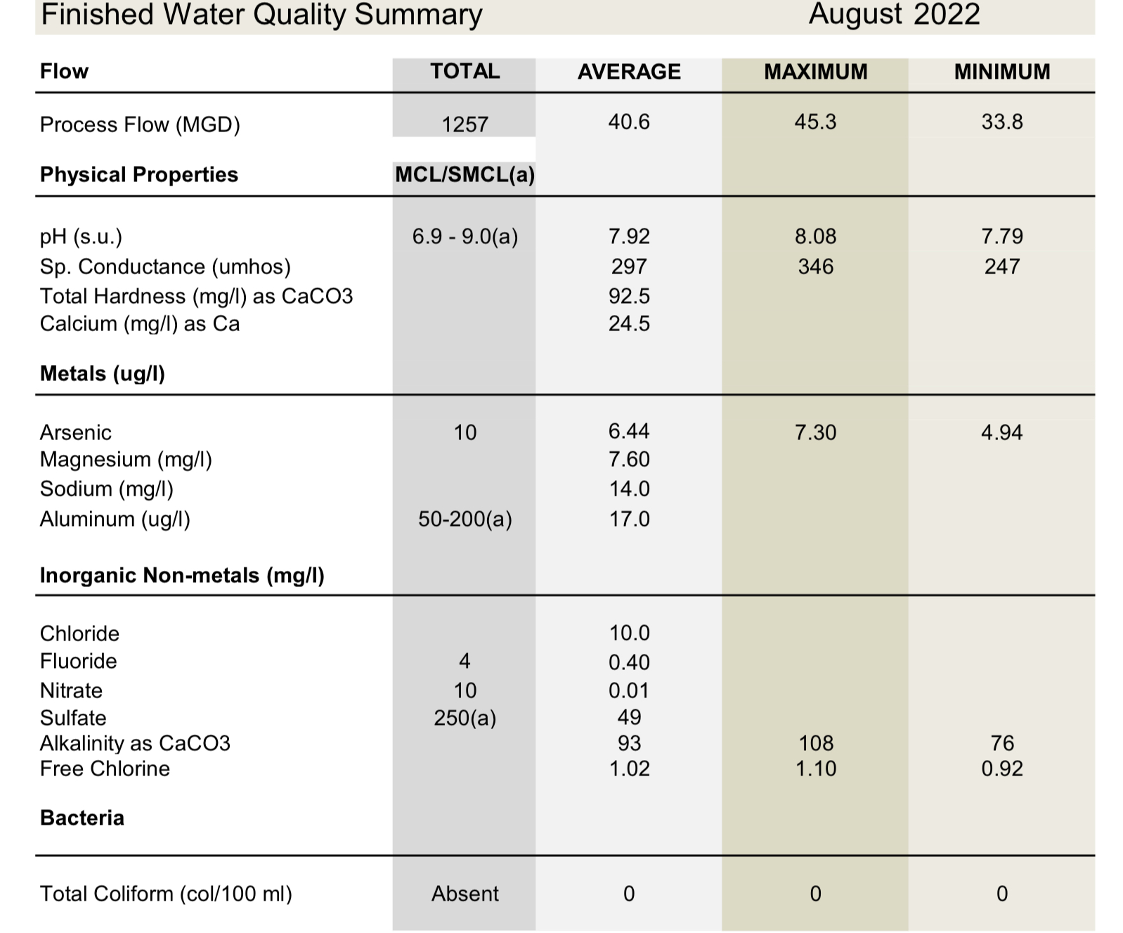

One thing you might look at is if your water supplier provides monthly test results of the water it supplies. Ours gets it water from the Yellowstone River and provides monthly reports like this one. They do vary over the year.
That is a very useful tip. When I started checking it I realized how good my tap water was and stopped buying deionized water, not even for final rinse.
