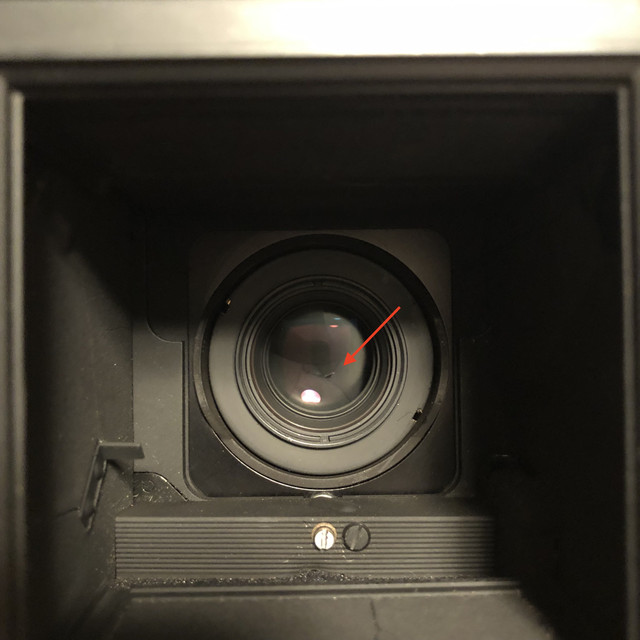

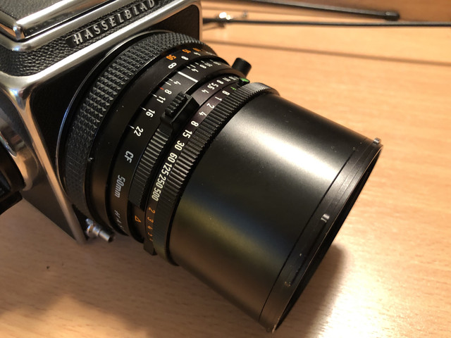

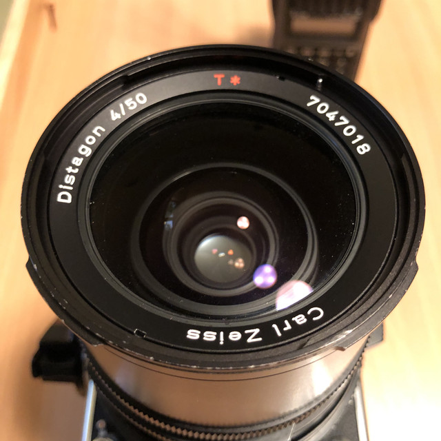

Lens showed up a couple of days ago. Looks great. Didn't come with a lens cover though... d'oh! Small thing to get one, but I didn't realize that it was not included in the listing.
However, I did notice what appears to be a slight bit of oil on the tip of one of the shutter blades (red arrow pointing to it). It doesn't seem to affect anything. Should I be concerned about this? If it is oil, I'm sure it will be taken care of at its next CLA.
BrianShaw

Look closer. To me that looks like an (intentionally) bent tip. Exactly as designed.

Its difficult to say for sure from your pic, but that looks more like the upturned tip of the leading shutter blade. This was normal for the CF lenses and nothing to worry about. Of course you need to be sure: wind the advance knob to cock the shutter, take the lens off the camera, and fire the shutter using the tiny collared pin on the lens bayonet. The leaves will close again, allowing you to get a closer look. If it isn't the folded tiip of the shutter leaf, and really does seem to be oil or debris, try to get a better clearer pic.
IMPORTANT: after examining the closed shutter, immediately use a coin in the round key slot to wind and re-cock the shutter so it locks open. This can be a little tricky, you may need to turn the lens and coin in opposite directions using both hands. Don't stop turning the coin until the shutter latches open (this point is inevitably just a little further than is comfortable without contorting your hands). Hasselblad lenses must always remain cocked when off the camera body.
The lens looks to be in beautiful condition overall: congrats and enjoy!
Upon inspecting my two other CF lenses (which were CLA'd just a few months ago), I can confirm that what I was concerned about in the above photos is indeed the upturned tip of the leading shutter blade... it just looks more pronounced.
There is a screw driver tool that is built to recock the lens that is safer and easier to use.
