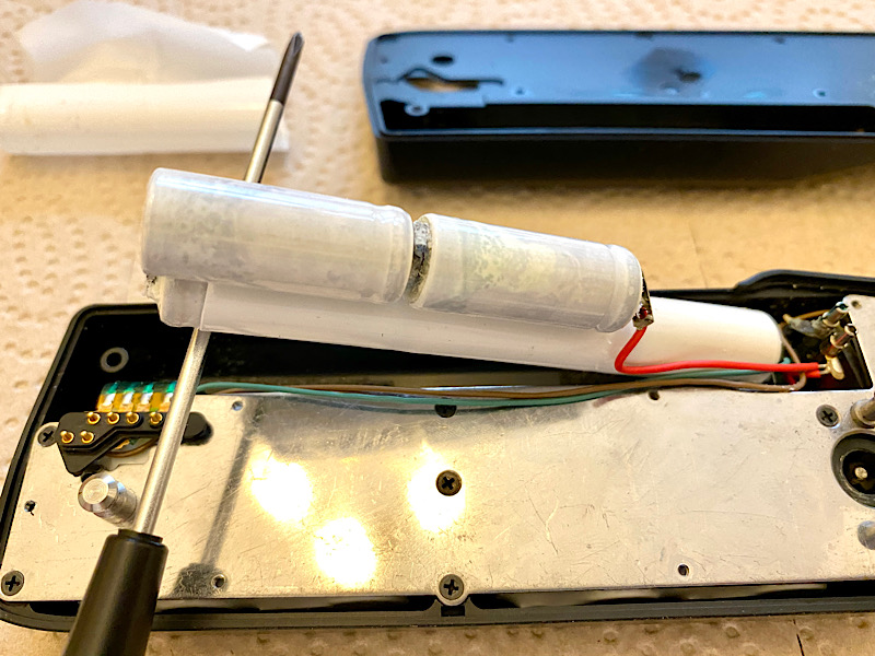

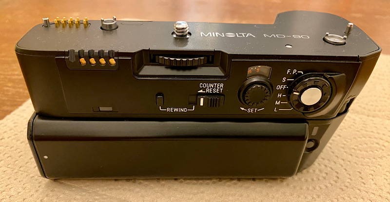

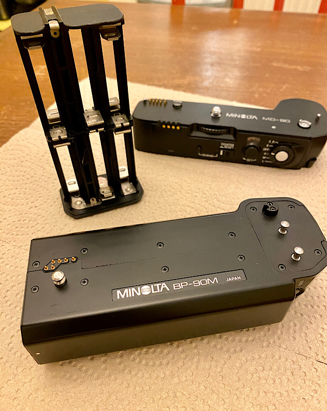

The Minolta (Maxxum) 9000 comes with the Motor Drive MD-90 as an accessory, which can optionally be operated with the rechargeable NP-90M battery pack.
This is a high-quality part that is electronically connected to the motor drive and provides a portrait format shutter release.

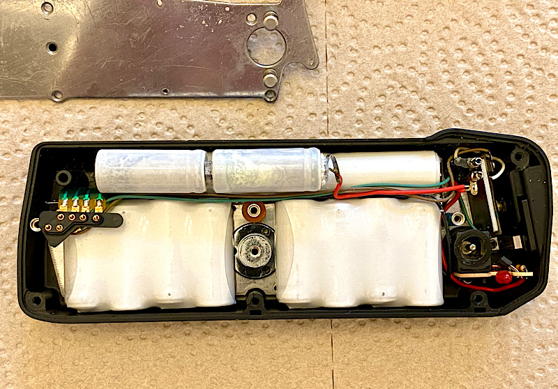

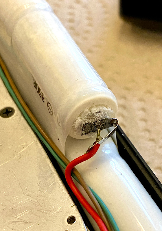

The NP-90M contains nickel-cadmium batteries that have leaked over the decades.
I wanted to take a look at the inner workings of the battery pack with a view to replacing the batteries.

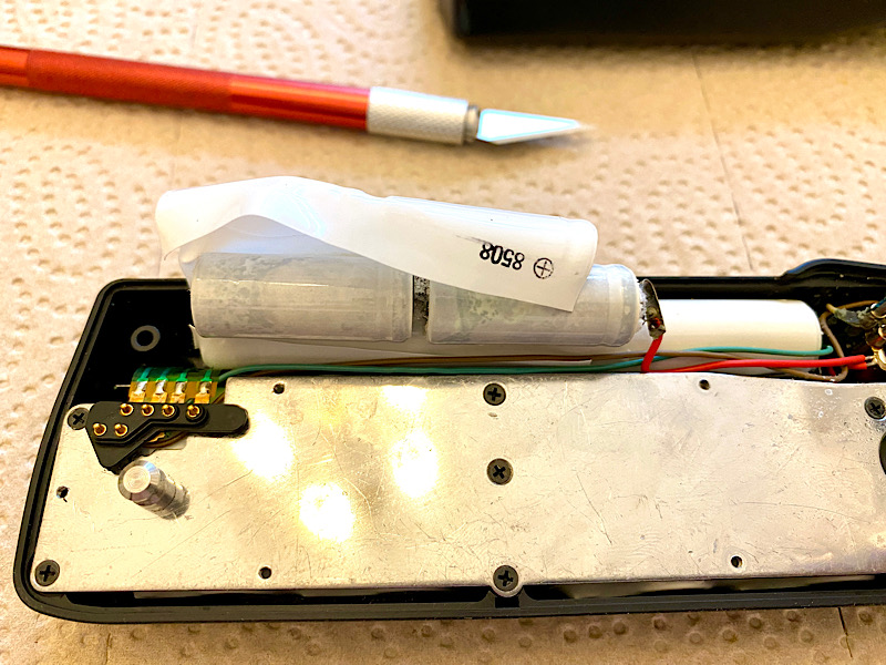

Loosening the screw connections.
The battery cells have leaked.
There are no nominal values applied to the battery cells below the plastic cover which I have sliced.

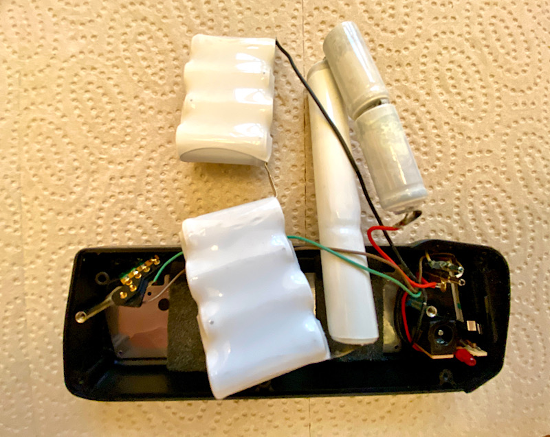

13 battery cells of 1.2 volts each are connected in series and soldered together.

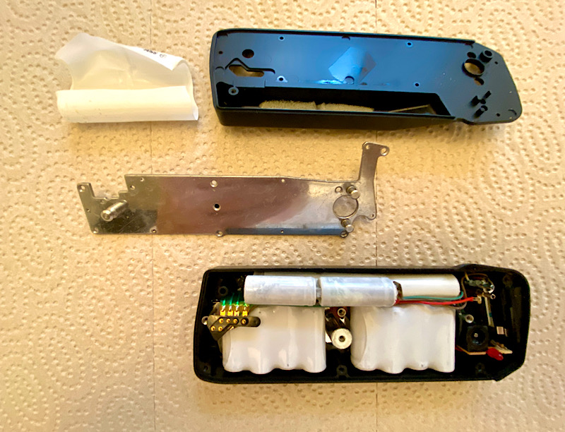

Overview
The battery cells are only electrically connected to the NP-90M circuit via the red plus and black minus connections.
Switch, a small circuit board with a red LED, resistors and probably a transistor.

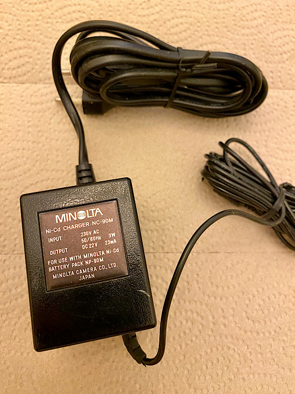

The corresponding charger NC-90M.
The question that arises with all old battery packs is which batteries can be used as replacements.
As far as I know, nickel-cadmium batteries are only available in the EU for certain applications and while stocks last.
Optionally, the MD-90 can be operated with the BP-90M battery holder for 12 x AA.
This means that the motor can still be used today.
The MD-90 is one of the most valuable accessories I have seen for SLRs.

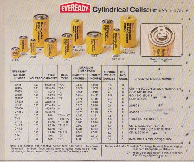

It's a shame no literature seems to state the expected mAh capacity of the NP-90M itself, but looking at search engine results for an old catalogue...
"N" at 150mAh when the 2/3AAA NiMH cells I just ordered claim to be 400mAh. Which I doubt is true but even if it's exaggerated by as much as half, it'd still be more capacity than a nominal NiCd cell of the era.

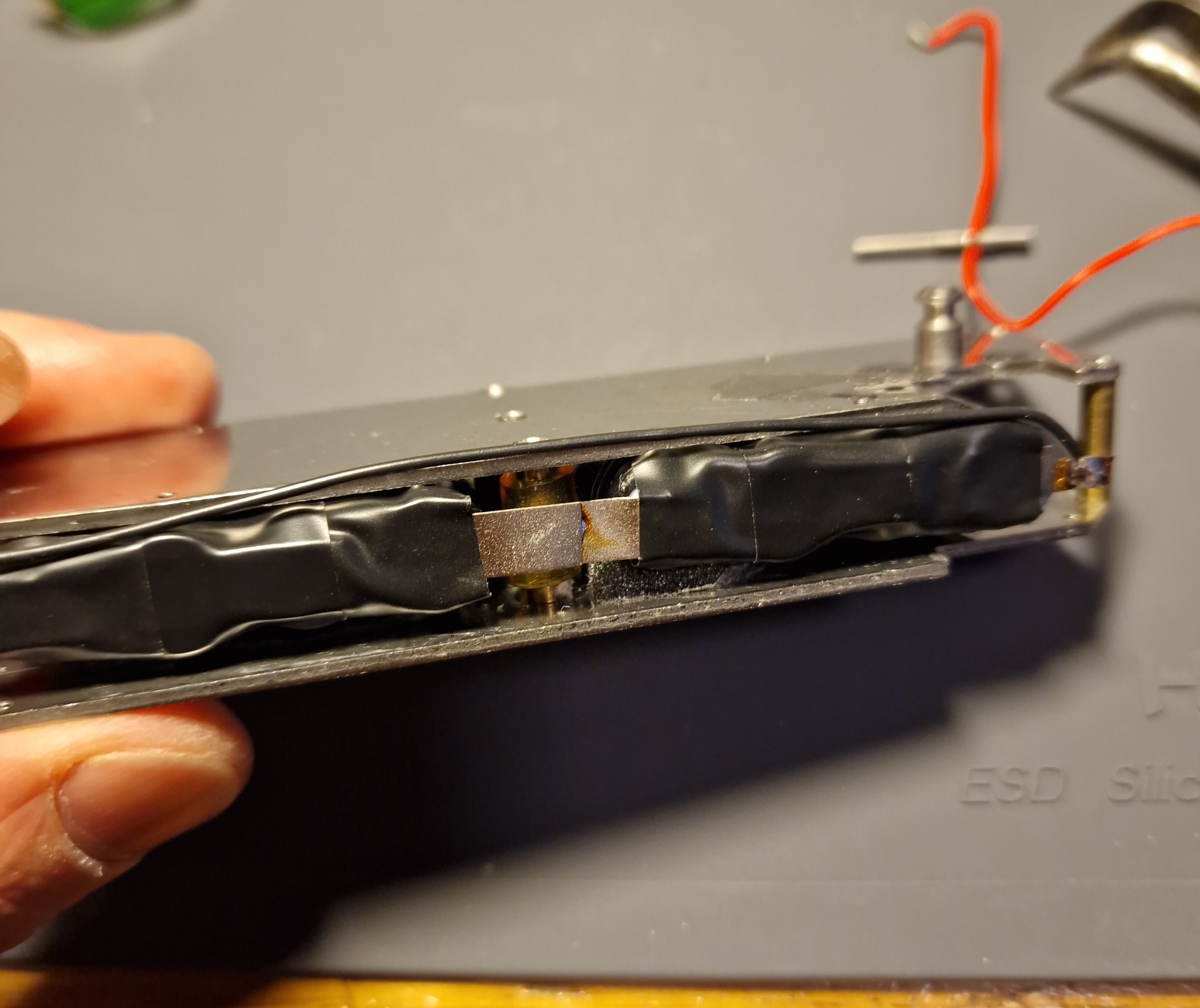

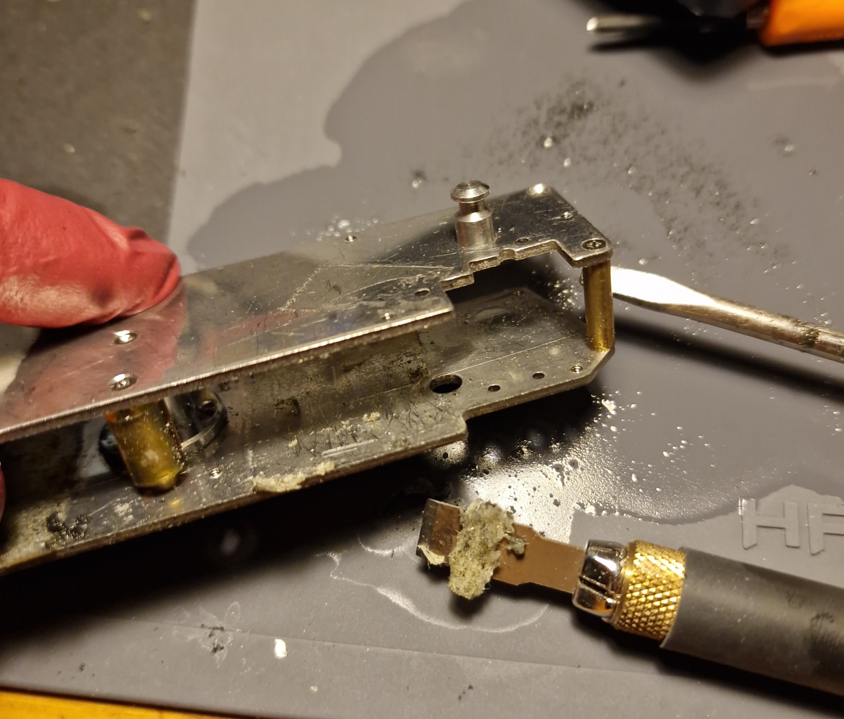

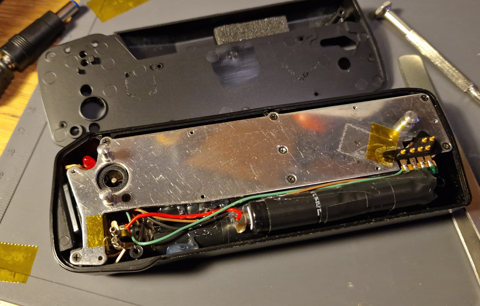

Alright, I got it working!

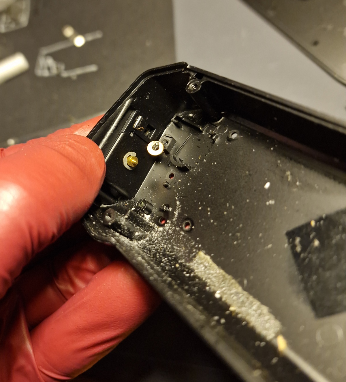

First step was cleaning the old stuff out. I removed everything including those contact posts that connect it to the camera, which were just press fit into plastic holes and could be twisted a bit to loosen them and then pulled out.

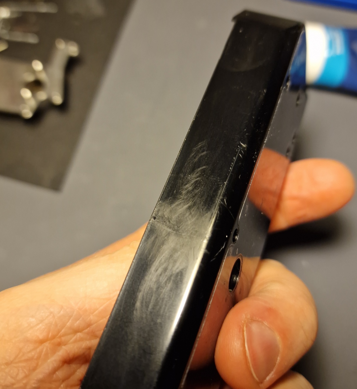

Cracked the case unfortunately trying to get the metal insert out. I thought it was held on with double sided tape but it was just the foam tape under the cells overlapping, but I flexed it a little to try peel it off the imaginary adhesive.
Half assed attempt to hide the glue repair. I might come back at this.

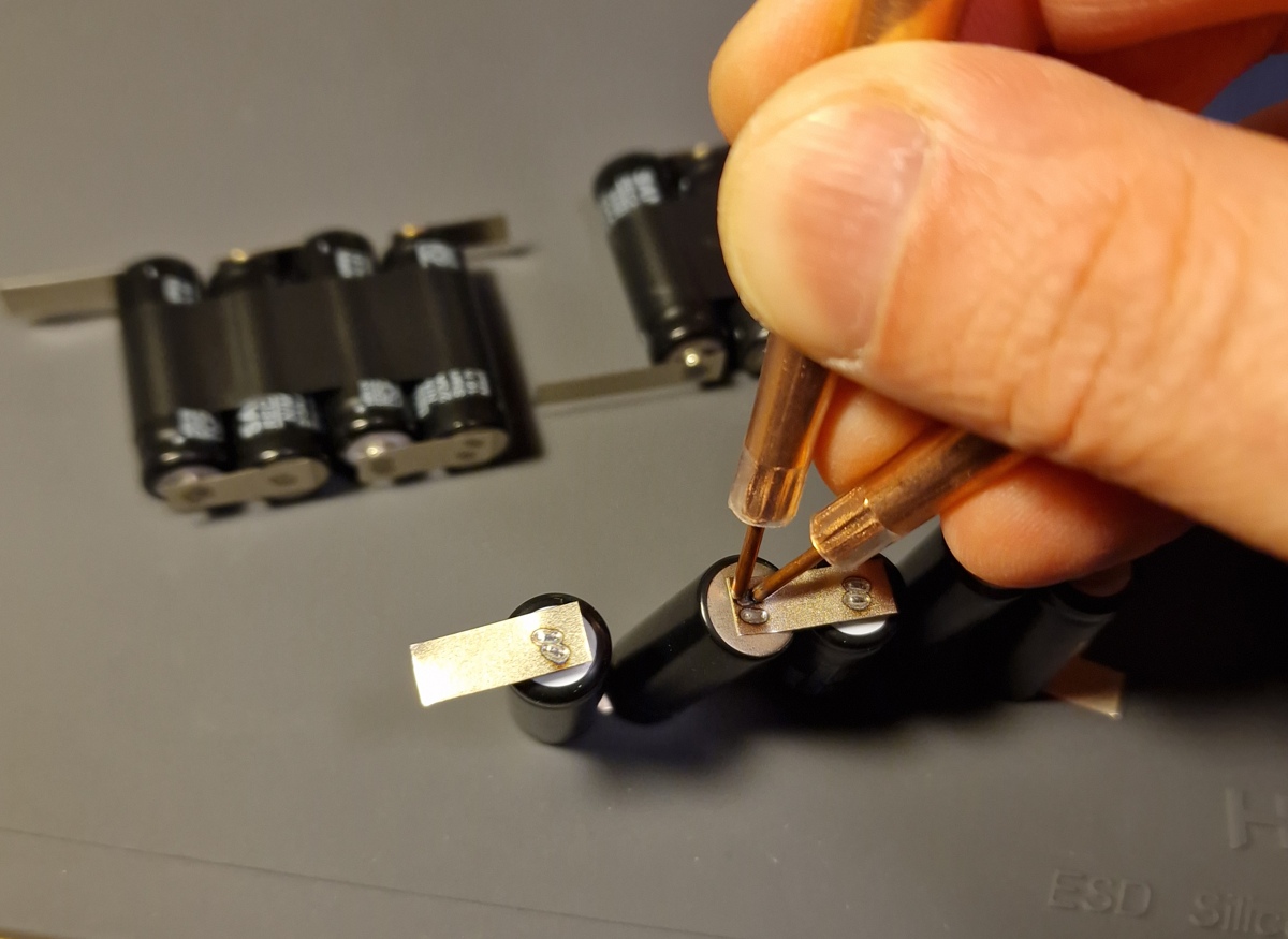

Spot welding the cells. I bought the battery spot welder a while back and the thing makes me nervous. Just a big old lithium battery you directly short out. They're vape batteries and designed for it I suppose, but I still don't like it.
Once everything was soldered back in place and tested working, I applied a few dollops of hot glue to hopefully prevent it sliding around. The new cells are a bit narrower and looser, and while the foam holds them in place, some sharp bumps or dropping it could have the packs slide and possibly short something. Also the removed and reinserted contact posts were glued in to hopefully prevent them rotating since their tabs could touch and short.
If you can get the top metal cover off there's little reason to dissemble it as much as I did.

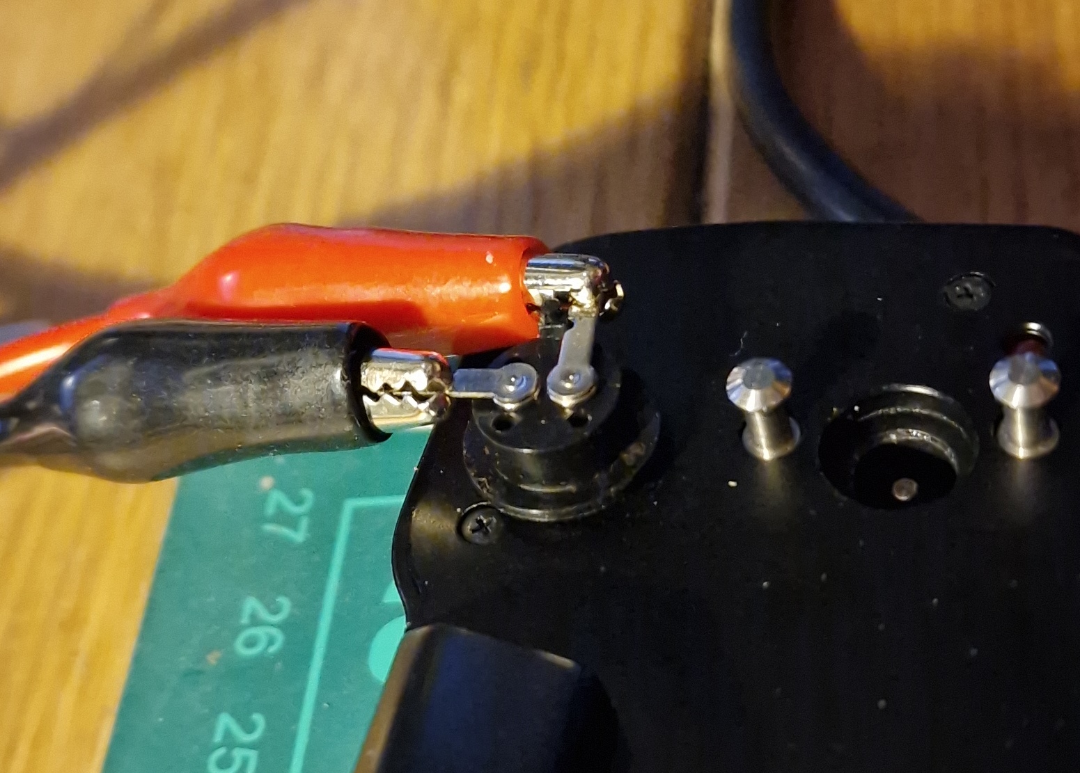

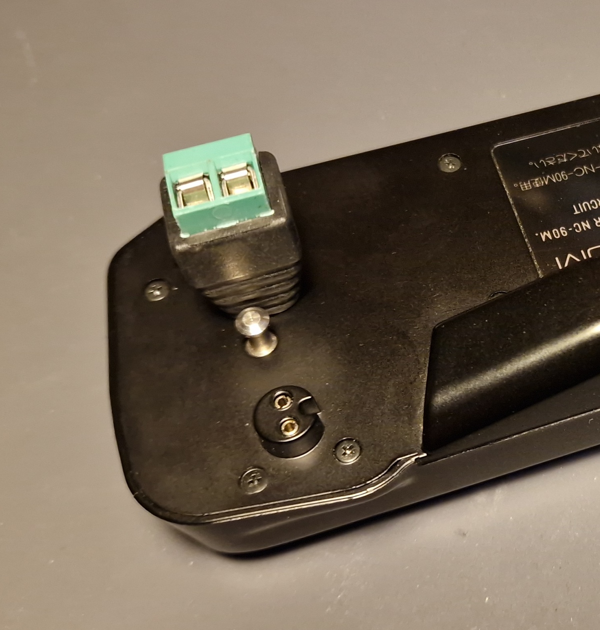

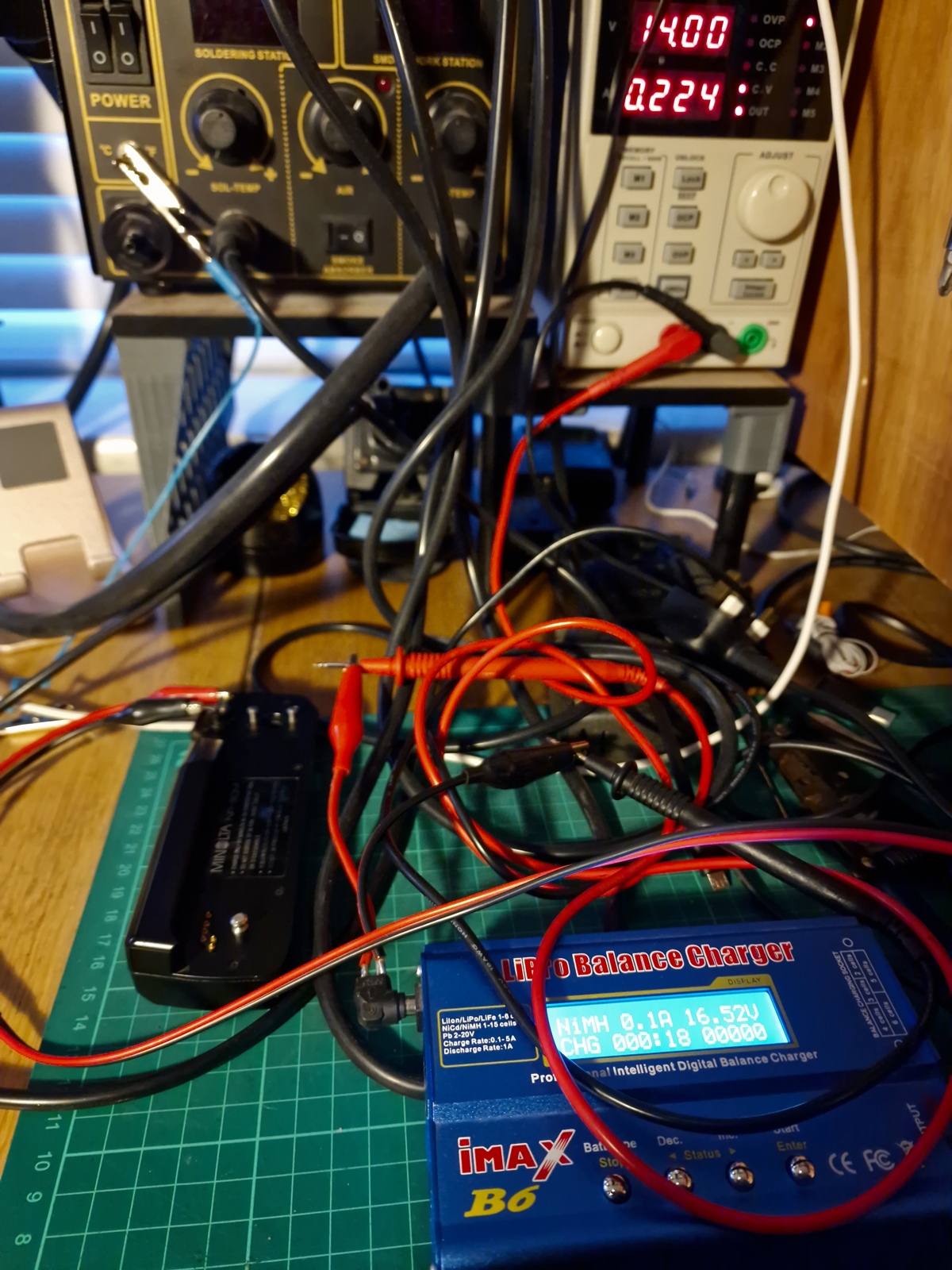

The charging setup is quite crude, using an old RC hobby charger and the connector from a particularly busted motor drive. I'd hoped i'd be able to charge it all neat and properly through the DC jack but the hobby charger didn't like that, complained about over-voltage. Probably because there's a diode in the way or something... I think I forgot to take a photo of the top side of the pack's PCB, or i'd try trace it out. But yeah the two power pins are just directly connected to both end of the battery. I'll probably try make something a bit neater at another time.

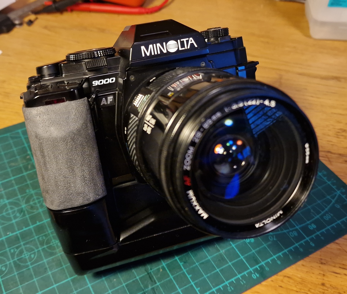

But yeah, glad that's working now. The rechargable battery looks alot less silly than the huge tall AA one, although I think the AA one looks good with the control grip. Since they're quick detachable from the motor drive it might make sense to just keep the control grip always attached to the AA pack. You could use battery packs as a weird tripod quick release.
View attachment 389293View attachment 389294
View attachment 389296View attachment 389297View attachment 389298

Soldering directly to the battery ends can heat damage them, but you may be able to find them for sale with solder tabs already welded on. Here's an aliexpress listing for exactly that. The 800mAh claim is silly, but the one review says they measured out to 150mAh. If I remember right 150mAh is still slightly higher then the capacity of the original cells. But yeah you might be able to find a better or more convenient deal on a website local to you.
