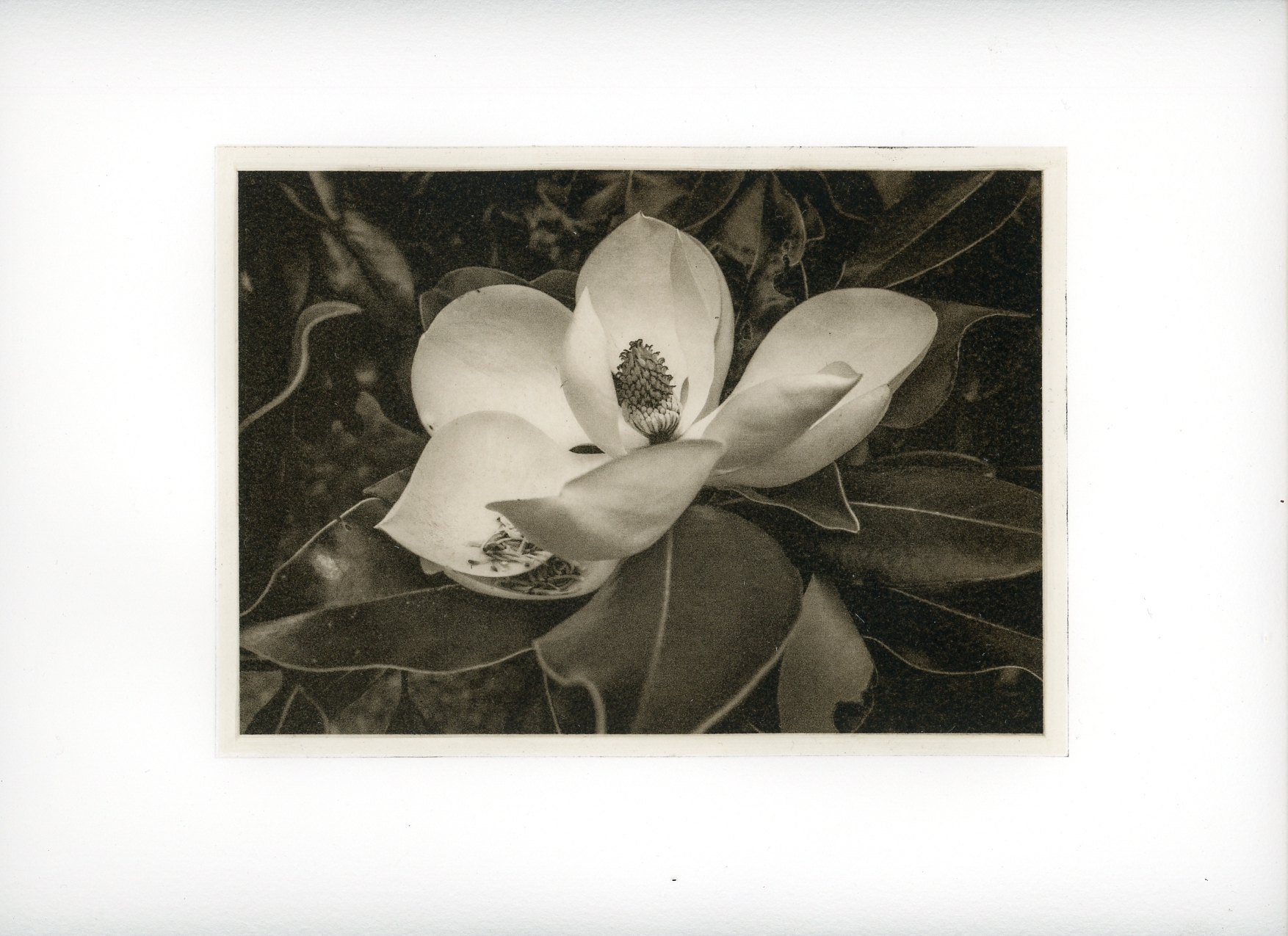

Mr Hyam,
Here is quick summary of my experience. I learned the Direct to Plate (DTP) method from Clay Harmon in Asheville NC at a workshop he offers several times a year. Despite the fact he wrote the book you reference, the state of the art has moved on quite a bit since the time he wrote it. Although, as Koraks has pointed out there may be some technical issues with this approach, I have been able to produce beautiful prints at the scale of 8X10 inches. In the DTP method - the positive is printed directly on a photopolymer coated steel plate using a high end Epson printer that can print on thick, flat loaded media. exposed to 365nm UV and then "developed" in water to produce "relief" and subsequently re-exposed to UV to fully harden the plate. No aquatint or intermediate "positive" is used.
Clay has a extensive blog he maintains and contains some instructions for getting started. (https://clayharmonblog.com/posts/dtp-quick-start). Please note that his instructions have been updated as he and others have developed the DTP technique. Nevertheless it contains a wealth of information. As I noted the DTP approach is based on the the use of Epson printers and software called Quadtone RIP and QuadToneProfiler-DN, I should add, both are Mac oriented ( I was able to make some prints using a windows based computer - but it was painful and I just ended up buying a mac)
Clay runs workshops at his studio each year, however they are in Asheville NC which may not be practical for you. If you look at his studio business which supports people who are interested in polymer photogravure - it is called Mountain Intaglio ( https://mountain-intaglio.com/) and sells plate material and other sundries. Jon Cone also has a studio/Workshops/supply business in Vermont USA.... https://shop.inkjetmall.com/Historical-Process. I would surmise there may be others in Europe offering workshops in polymer photogravure but I really don't know.
To actually make polymer photogravure prints, besides a printer, plates and software, you will also need a UV box with 365 nm sources. The UV lights sold on the internet are mostly 390 -405 nm and while they work fine for Cyanotypes/Kallitypes etc, they will not work for photopolymer as I have learned. The other limiting issue for many is the intaglio/etching press - they tend to be expensive, heavy and take up a lot of room. I have solved this problem by joining a local print making studio which are found in most large cities and has several presses. Also, most university art programs have intaglio presses and access can sometimes be negotiated.
Sorry for rambling on so long, I hope this may have been helpful. Attached is a print I made recently, when everything works the results can be very satisfying.

Thanks Dave. Lovely image.
