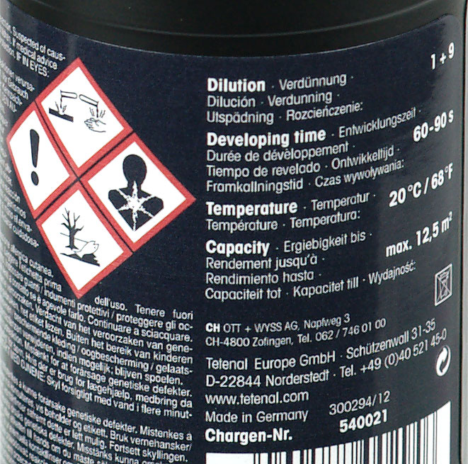

Well, yes, things have changed and, in my case, I'm working with someone else's child too. I will be asking his parents for permission first, so I want to inform them properly. I wonder if there's a comparison I can make (in terms of potential toxicity) to make it more understandable or maybe I should just focus on the safety precautions in place...

Safety goggles and nitrile gloves! This is health and safety gone mad. Black and white film and print chemistry consists of mild alkali and acid solutions that will do no harm.
So you're saying that you'd happily spray your eyes with it? :D What about all the warning labels, especially this one I have next to me:
Again, this is about safety for a child with impulse control issues and explaining to the parents what precautions I'll take.

7,632
I am not saying they should spray their eyes, or swallow it, or inject it. What I can say is that the thousands or so students I taught put theirs hands in dev, stop and fix without any ill effects.
