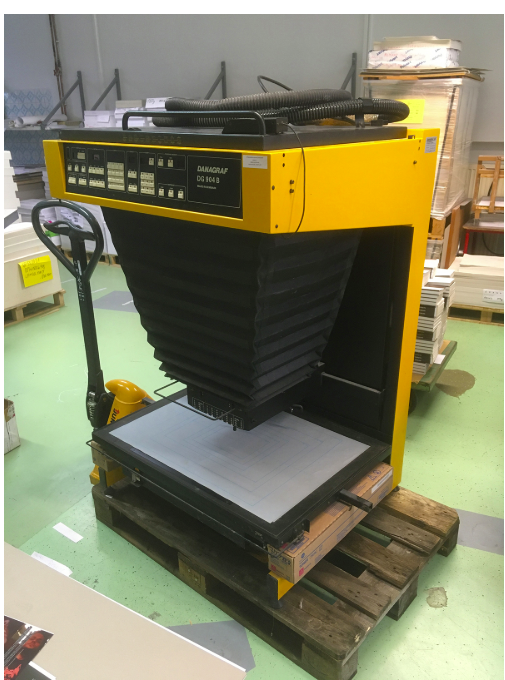

Lithography film was designed to fit into some film holders at the time of exposure, but those film holders weren't the type designed to fit into portable cameras.
They were designed to fit into the big process cameras you would find taking up a room at your local graphic arts shop.
But yes, many/most of those cameras used a vacuum frame instead.
Here is an example of a fairly small version of one of those cameras:
https://www.photrio.com/forum/threads/22x28-enlarger-from-lithographic-process-camera.205233/
The one I worked with was about 2-3 times that size.

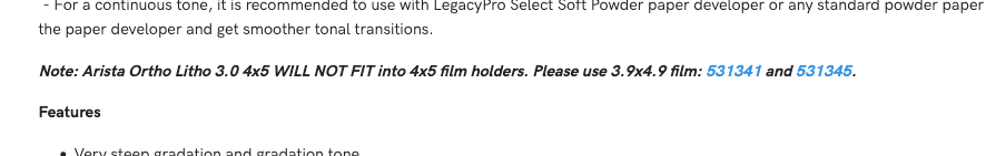

Why its setup that way I don't know, but you should see something like this in the item description of Ortho Litho:
that screenshot is from Freestyle. B&H isn't as helpful:

Arista sells Ortho film made for both 4x5 and 5x7 regular film holders. I seem to recall they notch those as well but I could be wrong about that.
Thanks! I just ordered a pack.
I didn't link the particular SKU, hope you scrolled down far enough to see the ones for film holders:smile: Please let us know if it is notched.
Yeah. I got it from B&H and I got specifically the one that says "4.9x6.9 ... For 5 x 7" Film Holders". The label recommended LegacyPro Select-Soft developer for continuous tone, so I grabbed that too.
I will let you know if it is notched.
