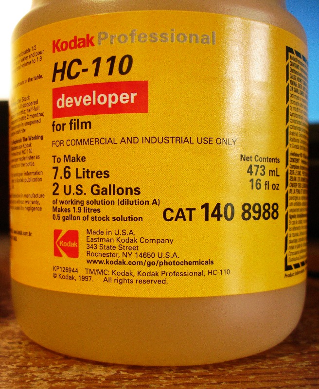

Interesting thread. I have also diluted my chemicals using the part to part method. I tend to use Kodak HC-110 and mix from concentrate. Well, the Kodak literature states that dilution E is 1:47, but they also stated the amounts of each.
http://www.kodak.com/global/en/professional/support/techPubs/j24/j24.pdf
828mL of concentrate to 39L of water.
39828mL divided by 828ml is ~48.1. The 828mL of concentrate is 1 part within 48.1 total parts.
So, 1 part concentrate to 47 parts water sounds alright. That is how I have done it and never had a problem. My Ilford fixer stated 1+4, 1+9, etc, but my Arista fixer states it like Kodak.
Edit: I don't mix that much, it was just one of two different amounts Kodak uses as an example.

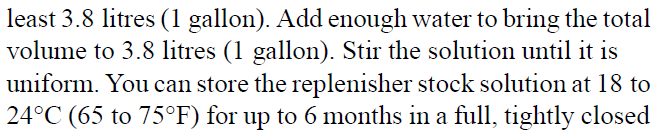

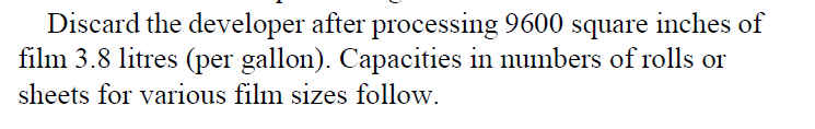

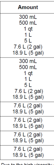

Unfortunately since what I learned in math class about ratios and their notation doesn't apply to a laboratory I agree they should be explicit about their use of the colon.
I am curious about what literature from Kodak is so vague. I haven't had much experience dealing with darkroom chemicals but the stuff the literature that I have needed to use has been quite explicit. All of the literature that I have come across is similar to the examples below, taken from documentation for D-76 and HC-110.

While it is true that there are some inconsistencies within the Kodak documentation, in most cases there are both long form descriptions (i.e. "You can easily mix smaller volumes by mixing one part of the concentrate with four parts water.") and abbreviated descriptions (i.e. "Concentrate mix ratio 1:4") within the same document - both examples taken from J86 - the T-Max developer technical data sheet.
In many cases though, if there are tables in those documents, or in the product labels, they just use the abbreviated versions.
In the tables for HC110, Kodak uses 1:31 (as an example, for dilution B), but explicitly states at the top of the column that this refers to the "Ratio of Concentrate to Water" (not ratio of concentrate volume to total volume).
As for the US gallon vs. Imperial gallon question, it has been a long time indeed since I've seen any Kodak volume measures that didn't include the metric equivalent as well.
The 2 examples actually do and they don't, it's only specified if you already *know* that a US gallon is 3.8L. Suppose we take a fellow in the UK who has never worked with metric, they don't know that 3.8L refers to a US gallon, so they assume, because they are in the UK that it means an Imperial gallon, but it doesn't, and an Imperial ounce is smaller then a US ounce (by about 4%), yet an imperial pint is larger, so is the quart and gallon, so if your mixing up a quart, you better darn well know whether it's imperial or US. If you need to consider metric to define an ounce, pint, quart or gallon, then might as well use metric measure. Which is what I did...
I see your point. I've never ran into any issue as I always measure using the metric system as there is very little figuring to do.
