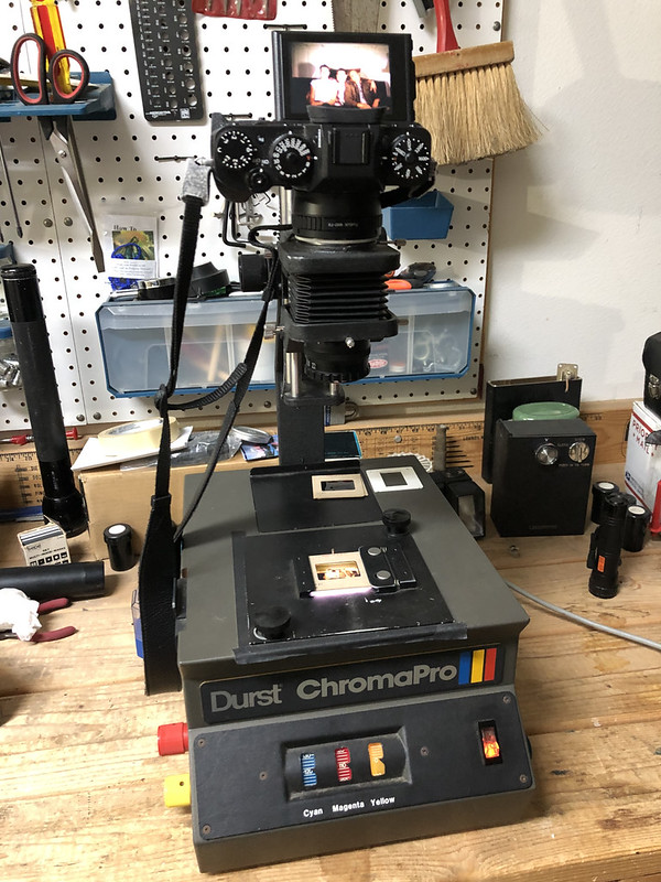

Here is the Durst set-up. In this case I was copying slides, so used the standard Durst slide insert.
Nice. I didn't google the Chromapro but that is pretty much perfect for the job :smile: Based on lens distance I assume that is 90mm on full frame?
I am using 80mm on APS-C. I suspect full frame will use 50mm (for a 35mm negative).
