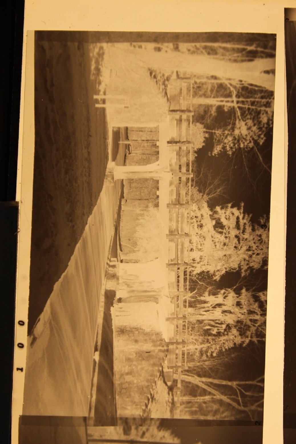

@jnantz Hi John. I've gone back over my OP to check that I've worded it correctly, and it looks OK to me. The negatives are not (to my eye) over-exposed. In fact, they look pretty 'robust' with a good range of tones. When I digitize them, they still look OK (see the digitized image of the neg). It's when I reverse the curve in Lightroom that they seem to gain at least a stop to two stops over exposure.

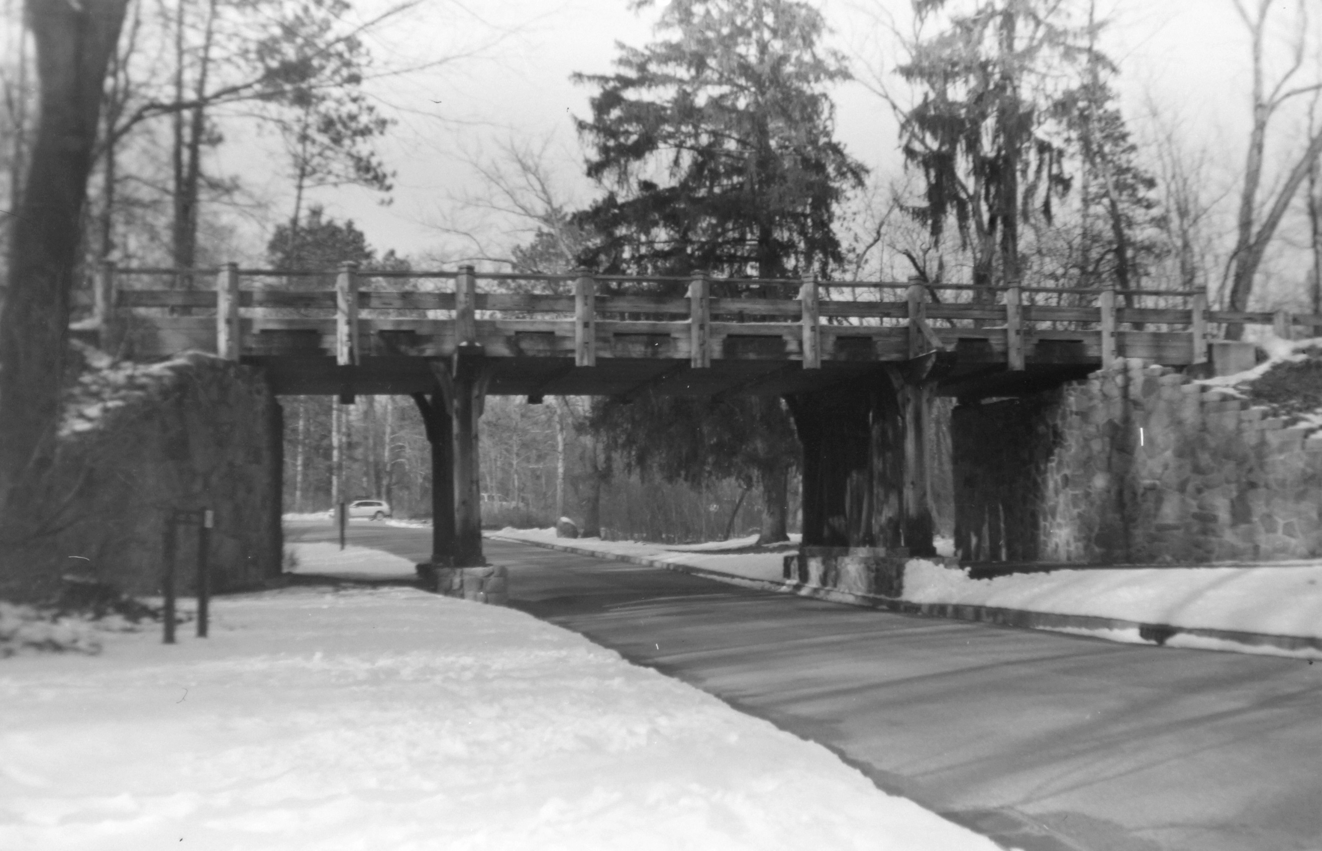

@Chan Tran If you mean the reversed image, they histogram is definitely showing over exposure (a gap on both ends and especially on the black tone side.) I'm not printing to paper yet, but the finished positive is below - with exposure and contrast adjustments. I just think that the reversed image should be closer to the negative. But do you think it's OK?
I think it's OK! Perhaps more contrast is better. The fact that the histogram didn't hit any border and it's closer to the right that is good. You have all the tonal values that was in the negative and you have less digital noise overall than if the histogram is centered. You just have to expand that range to what you like.

My point (and the point of the thread), is that I was (am) doing that already. Although I tend to do it with the histogram directly in LR or the Levels sliders in PS. What I was asking about was why there was so much clipping from what appear to be correctly exposed negs. My guess is that (as @Patrick Robert James suggested) I'm not exposing the negs correctly at the digitizing stage.

I don't believe I have ever camera-scanned a negative that did not fit on the digital camera histogram with room to spare on both ends. Transparencies, yes, but not negatives. Your inverted image (the third photo in the first post), looks similar to what I see at that stage, before making the necessary adjustments for levels and contrast.

I modified my moms 1940 Asnco box camera to take 120 film. I did not have a way to enlarge the negatives, so I placed them on my 4x5 contact printer, dimmed the 7 watts bulb and shot the negatives with my Canon T6 on a tripod.
Now we are not talking fine art here, just seeing what mom's 80 year old camera could do.
The negative was shot at F5.6, 1/80 sec. 320 ISO at 55 mm.
The positive was post processed in Picasa, a simple PP program.
