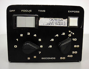

Analog timers, like the classic Omega Solid State Precision Timer, are easier to repair. Less components, no integrated circuits, etc. This one uses discrete components consisting of resistors and capacitors and a single SCR.
