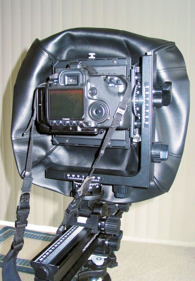

Years ago I had fabricated a lens board mount for Canon EF mount on my Horseman LX monorail. The problem, in part, is that the distance between front lens board and rear board (and the focal plane position of the dSLR) does not permit focus at Infinity, but only at close distances, even with a bag bellows in place of a conventional bellows.
The other problem is finding a short enough FL lens that can be mounted on a lens board, to use the frame size of the capturing camera...24mm for FF body--and having a large enough image circle to permit shifts.
So i wonder about the Fotodiox product, and how it helps to resolve the issues I ran into, with my DIY solution.

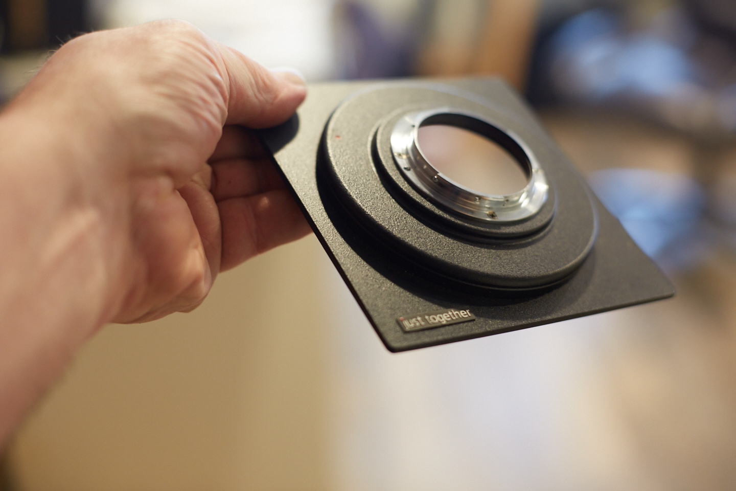

I made an DSLR adapter out of some stiff board (I used 1/16" FR4, common printed circuit board substrate) and some flanges, a short extension tube to clear the DSLR prism overhang, etc. Cost basically nothing and a little bit of time. It has a large back focal distance, roughly the DSLR's flange focal distance plus 10 mm or so. There is a picture of it in the LFPF forum.
If you use a mirrorless camera you could cut the back focal distance down but not eliminate it entirely. You still have to be aware that with significant rise/shift or rear tilt/swing, the throat of the adapter can vignette the sensor, even if you are within the lens image circle.
It doesn't make much sense for a "normal" focal length for 35mm format (let alone APS-C) because most view cameras are hard to manipulate when compressed to accommodate a ~50mm lens, even without the added back focal distance. Where it could make sense is if you were doing tabletop, product, or macro photography and could use a longer lens for greater working distance and movements for perspective/focus control. For example, a 100-150mm enlarger lens might work well with such a setup.

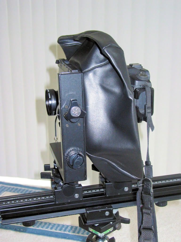

My Canon dSLR mounted to a Horseman LS monorail, shown with bag bellows expanded so as to not obcure a view of the mounted dSLR
I had disassembled an EF extension ring to get the EF mount to attach the body, and simply used boating epoxy to afix it to a Horseman lens board.in a light tight manner.

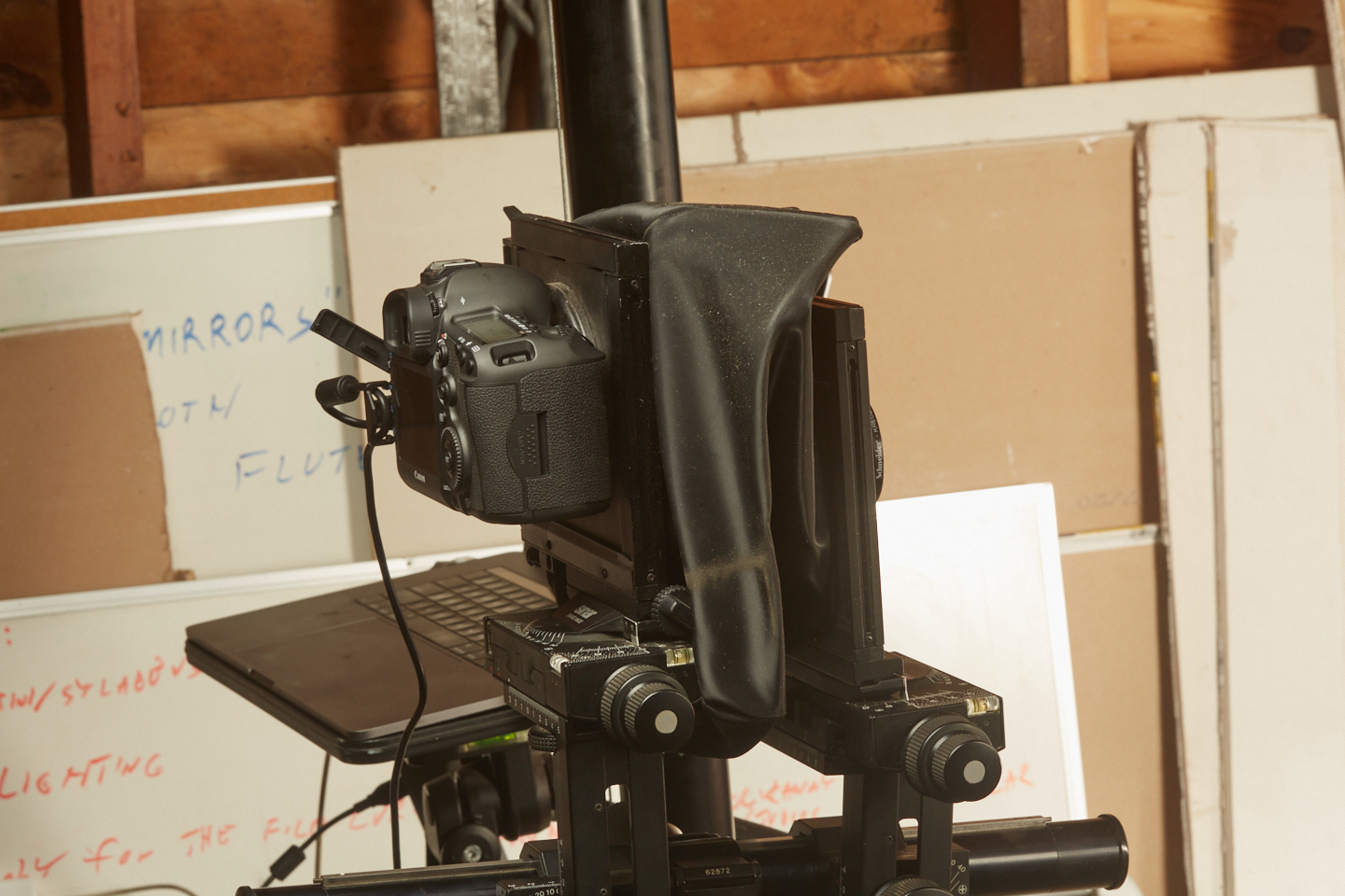

There are a couple of challenges and a couple advantages to using a DSLR. The challenge is mainly that the body itself is 57mm deep, and the adapter takes up another 12mm of distance from rear element of the lens to the sensor. This means that the shortest lens that is practical is a 120mm if you want to use any movements at all. A 90mm is the shortest that I can get to work at all. The other is something that you can bark your shins on when stitching: the lens flange on the body will easily vignette a portion of the image. The advantages are that live view actually works, which is awesome. I just use the focal plane shutter in the body and don't bother with the shutter on the lens other than to set the aperture. Flash sync, if needed, is then on the body and you are limited in shutter speeds available for sync.
I generally tether using Capture One in studio, which is why the laptop is on the accessory tray of my stand

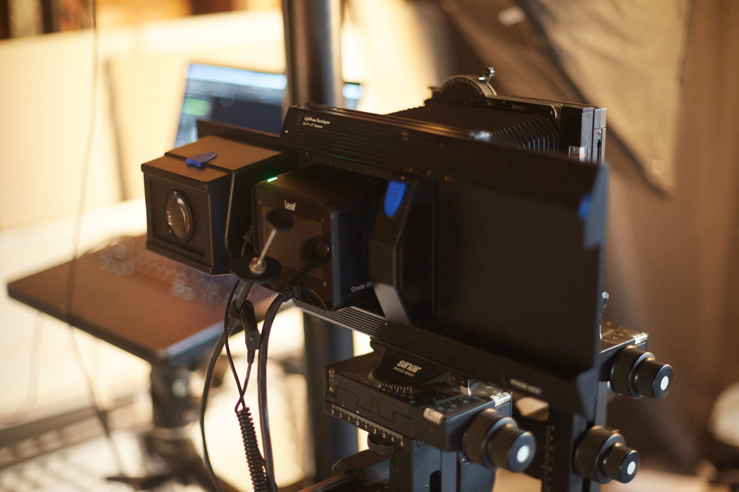

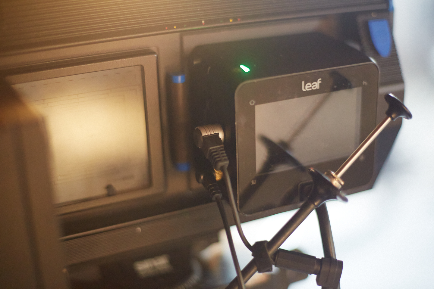

A medium format back sidesteps the body depth and vignette issue as the sensor plane is pretty much right where the film plane would be if using a film holder. Phase One did make an adapter that can be fitted to most major brands, and it is swank - built in magnifier and sliding-stitching movements are a breeze. With this there are some different technical hurdles. Since there is no shutter on the back, you use the shutter in the lens, or behind the lens if you have the auto-shutter and DB lenses. I do and generally like not having to manipulate the aperture from the front of the camera.
However, you do need a wake up cable to activate the back. With an auto-shutter and its special cable release, the only option is the two shot cable. Flash sync from the lens goes to the cable, cable goes to another cable that plugs into the back that also features a small button. You push the button, then release the shutter with the cable release. Actual flash sync cord plugs into the back. I velcro the two together because otherwise I always seem to be fumbling for the cable release. Of course the Leaf Credo 80 is a CCD sensor so live view is not really usable at all, but the quality is stunning. At some point I want to test out a IQ4 back to just get really silly (or sillier) with the technique. I love the quality those old view camera lenses deliver.
Just for grins - here are links to some quicky test mages using these set ups- I am not embedding them because they are enormous. 300 MP image using the Leaf Credo can be seen at this link . 500 MP image using the Canon 5DS (including an example of a stitch failure due to vignetting) can be seen at this link .
