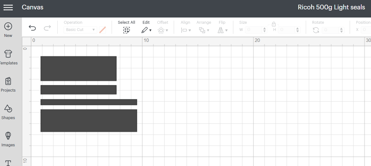

I couldn't find a light seal kit for my Ricoh 500g but I *was* lucky enough to find a blog post on lomography on changing the seals that just happened to include measurements.

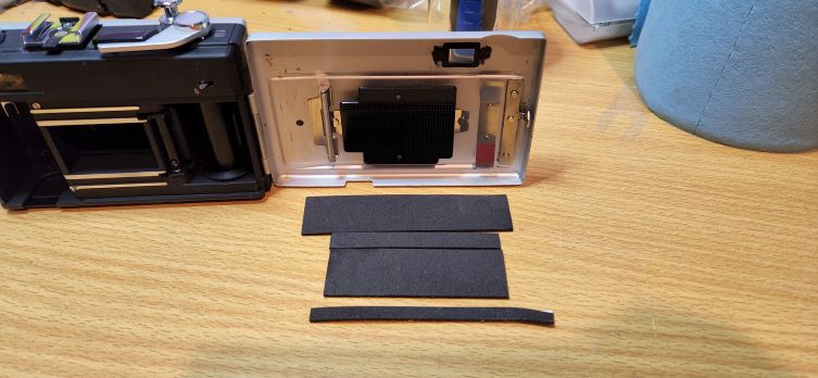

So a few minutes in Cricut design space, a sheet of 2mm adhesive EVA foam from the craft store and a couple more minutes on the cricut maker and tada! I have my own seals without touching an exacto knife lol
(The thin one is just stuck to the backing paper crooked it cut just fine, the foam stuck a bit better to the cutting mat then I was expecting so it smushed a little removing it lol)
If I did it again I would cut a rectangle outline around the whole thing, cover it in blue painters tape and remove it all in one piece then remove each strip afterwards.
Well, good thing I test fit...... 2mm foam is too thick, off to get some 1mm foam and some felt 🙃

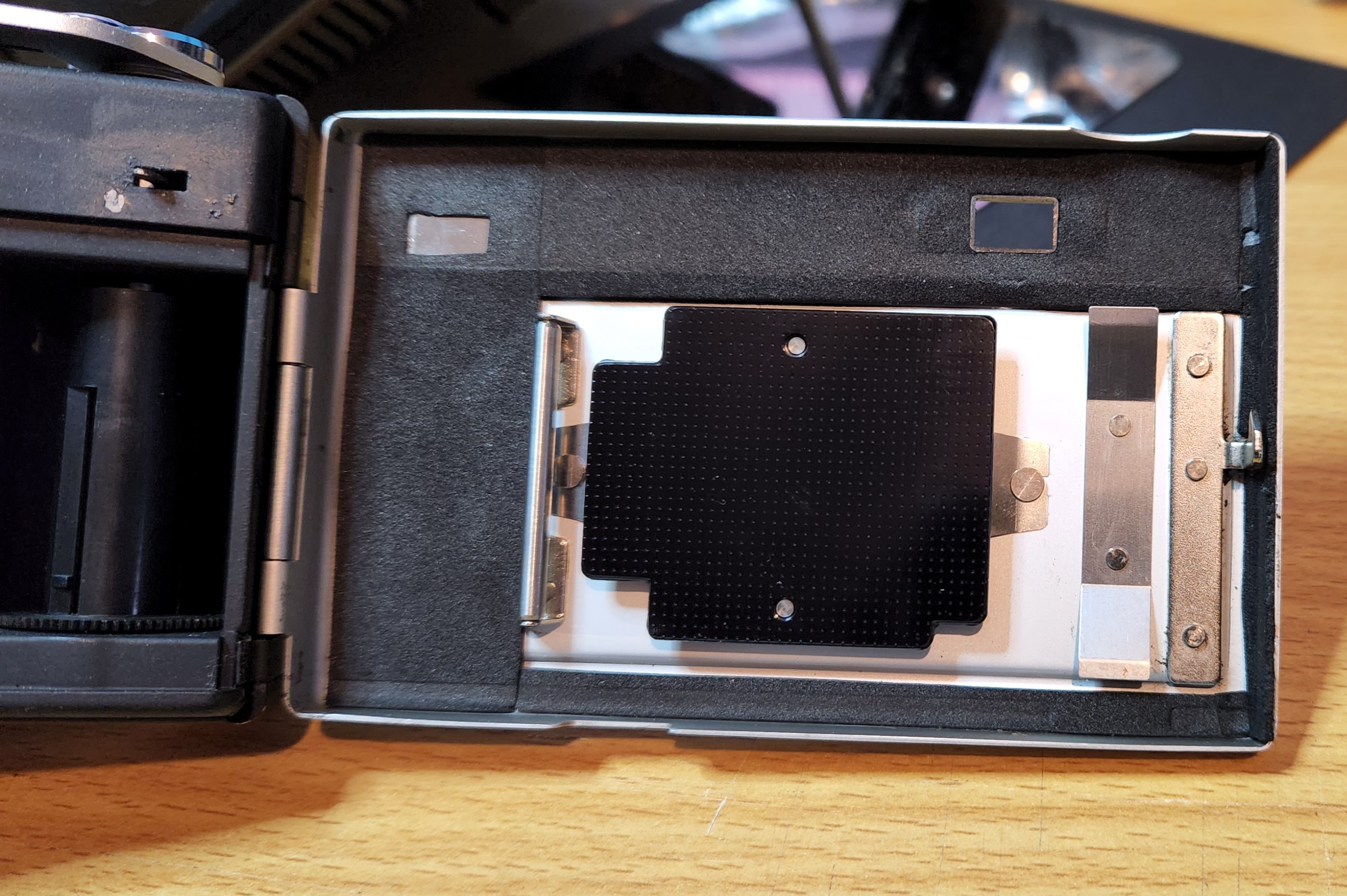

1mm foam and the Cricut worked great!
The felt was a "just in case" extra thin material for the bit behind the latch but trimming the foam around the latch was good enough.
