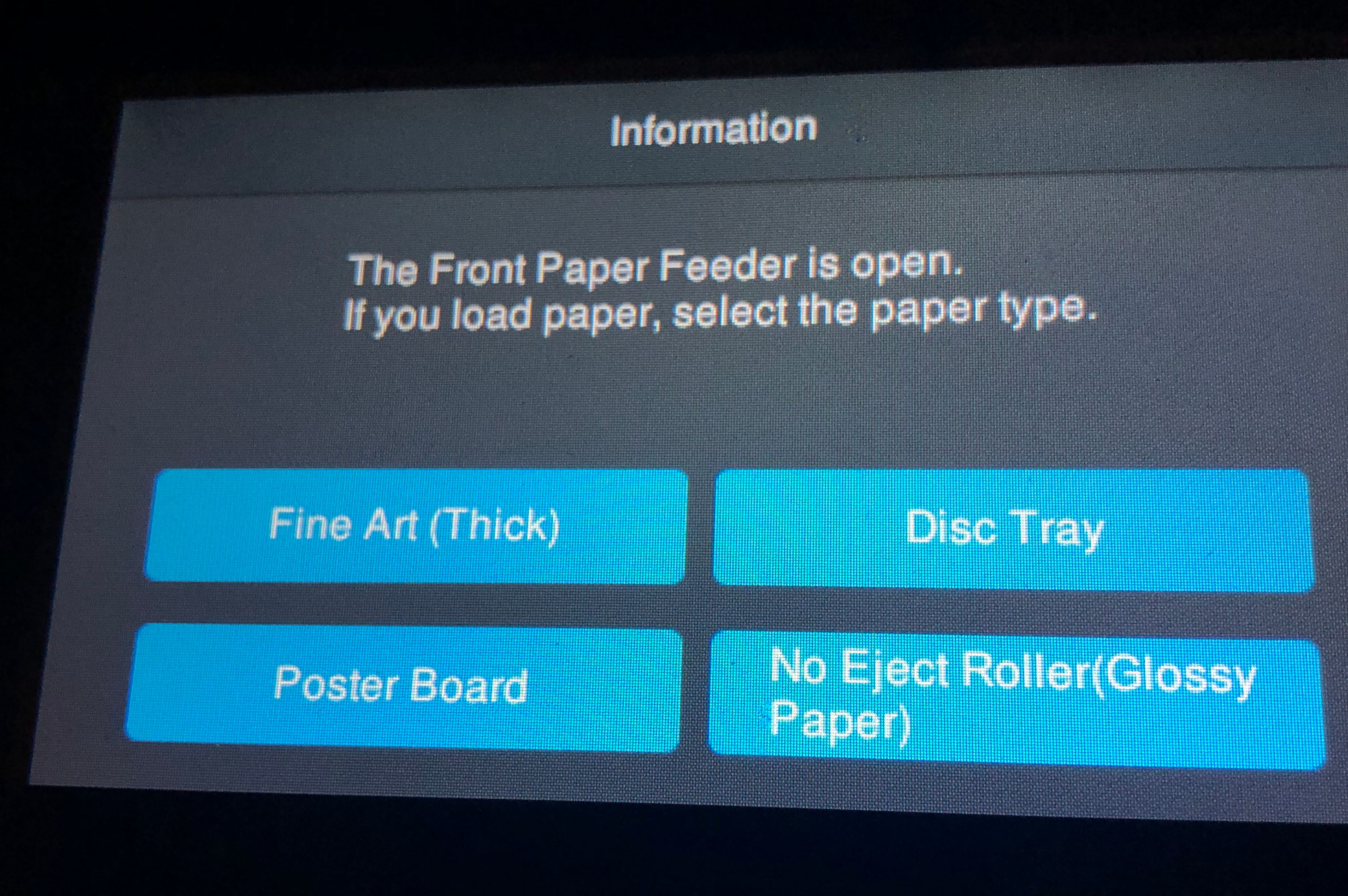

I was so glad to see this post and advice Don. Thanks. However, my P900 will not accept pictorico in front feeder if i select No Eject Roller icon. I get a paper fault message and it ejects it. Did you ever have this? I think I need to use the media installer software to create the proper paper profile for the OHP right? Where do I find this? In EPSON software in apps folder?

I hit the P900 pizza wheel issue while writing the Kallitype, Vandyke Brown and Argyrotype Book. If you are in North America (perhaps elsewhere), the P900 does NOT lift the rollers for front feed. To do this, you will need to go to the Europe Epson support site to download and install new P900 software. You will then see this as the window when you drop the front feeder mechanism. Now you can select no eject roller. You will need to use the media installer software to create the proper paper profile for the OHP.View attachment 353442Here is how you do it:
There was a 2022 firmware update that supposedly added a feature to the panel to lift the Eject roller that is causing the pizza wheels. But not available on the USA support site when I did the update in July.
SO….. A quick surf out to the EPSON EU site, and there it is ….
For P900
https://www.epson.eu/en_EU/support/sc/epson-surecolor-sc-p900/s/s1786
<image004.jpg>
For P700
https://www.epson.eu/en_EU/support/sc/epson-surecolor-sc-p700/s/s1785
<image005.jpg>
It loaded fine into my P900 – took a few minutes. And I am in the USA - it did not affect the P900 or brick it.
For P900
<image004.jpg>
For P700
<image005.jpg>
