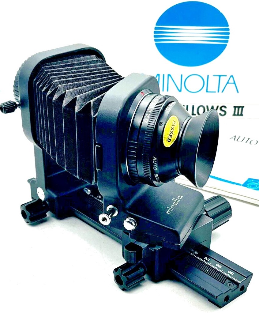

Some of the new models allow tilting the lens, which can boost apparent DOF, very few older models allow this.
While swings & tilts & shift & rise/fall were not the most common feature of manual-focus bellows, there were plenty that had it. My Minolta Auto Bellows III has both -- and with bellows lenses from 100mm to 12.5mm with the extra large image circles that are required. The AB III even allows you to reverse the lens!!! Nikon, Contax (Yashica) and others made these bellows too -- even Spiratone sold one. They were more expensive, of course, so fewer were sold, but nowadays you can get them without needing a loan from the bank.
