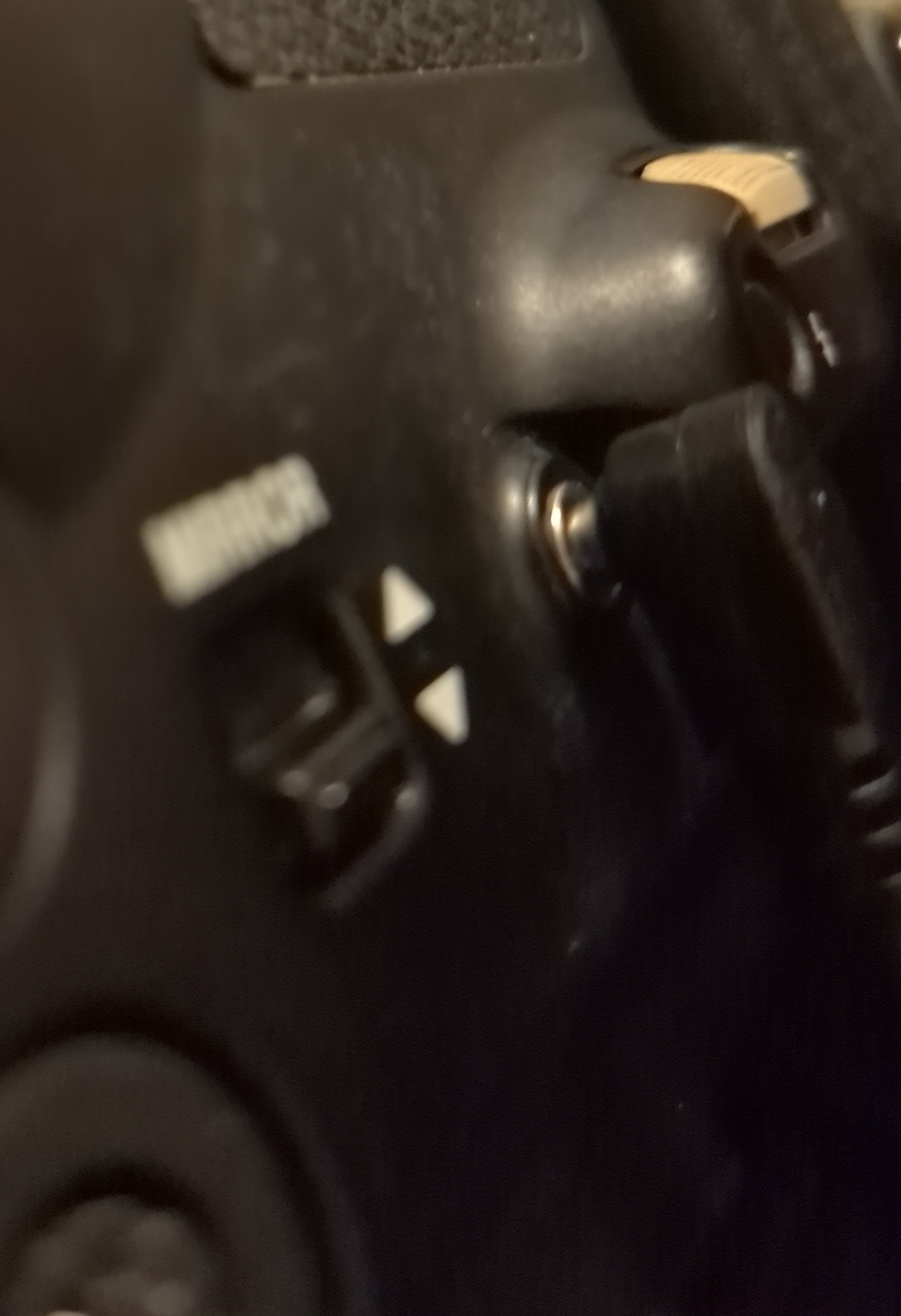

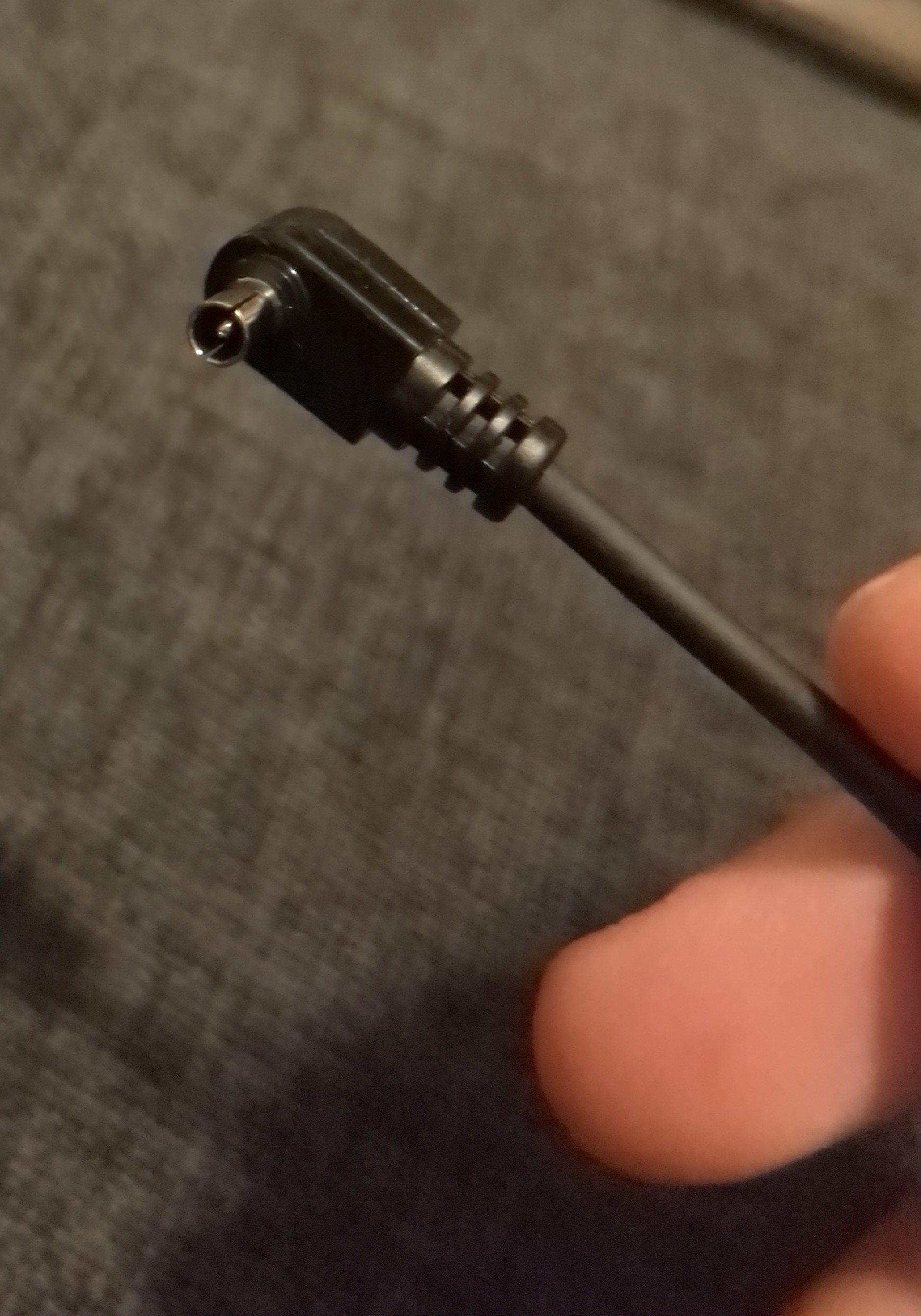

Another day, another update. Got the old cards, they appear to work just fine. So, one problem solved, I think. Got another though and maybe I'm clueless on how this works: the sync cable. On the digital back, it goes all the way in, but on the body, it doesn't. Is it possible my port is broken or I have the wrong cable? Are there different cable sizes? Does it matter that it doesn't go all the way in? This appears to be the cable that came with the back to the best of my knowledge.

Wow, do I have a doozy of an update! So, by some sheer luck, I found a second back in Japan for sale. It was listed as working and I jumped on getting it. Arrived yesterday and put it to the test. And now I'm stuck and need help on where to go/what to do.
So, went to a local camera store and they helped me test the sync port. I used an external flash (not on hot shoe) and used the digital back cable (I thought could be faulty) and the camera sync port (which could've also been faulty). The test button fire the flash off, so the issue is doesn't appear to be the sync cable or the port on the body from that test.
So, what's happening? The digital back (both of them) trigger the shutter, the mirror flips, images are recorded to the CF card. I'm getting black images from both backs, there appears to be no data in the histogram that the body displays. I have the lens aperture wide open, shutter speed matches on the body and digital back. I've tried both short (1/125) and long (4 seconds) and no change in the image captured.
I uploaded the manual here (). I'm not sure what to try to troubleshoot at this point. Any help would be appreciated!

Not sure, why don't you send me one to have a look? Sounds like a kaput sensor, kind of unheard of but maybe not back in the early days.
How could they verify the second back was actually working? Try grab the image data off the card and upload it here, might just be a problem viewing it directly on the camera.
Also, might be a bit silly but worth trying; detach the back but keep it tethered to the body - this way you can verify the shutter is actually opening (leaf?) and the back should be overexposed.
