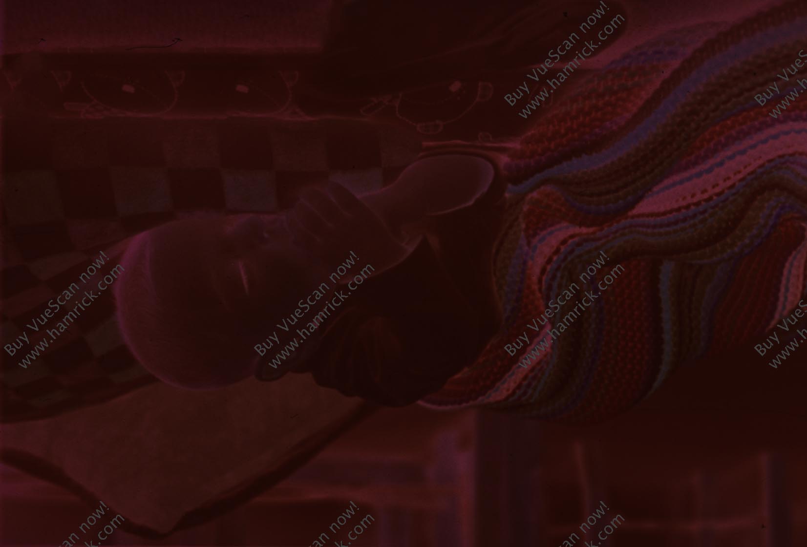

I cannot tell from this scan. I would need an actual scan of a photo of the negatives with back lighting.
PE
I am new to this business, Please ignore the ignorance. I have tried to do one scan not sure if this is is what you meant?
just to add, i did a second roll and it turned out to be the same.

Well, no that is not what I need. I need to see the sprocket holes and film edge markings. Sorry I was not clear.

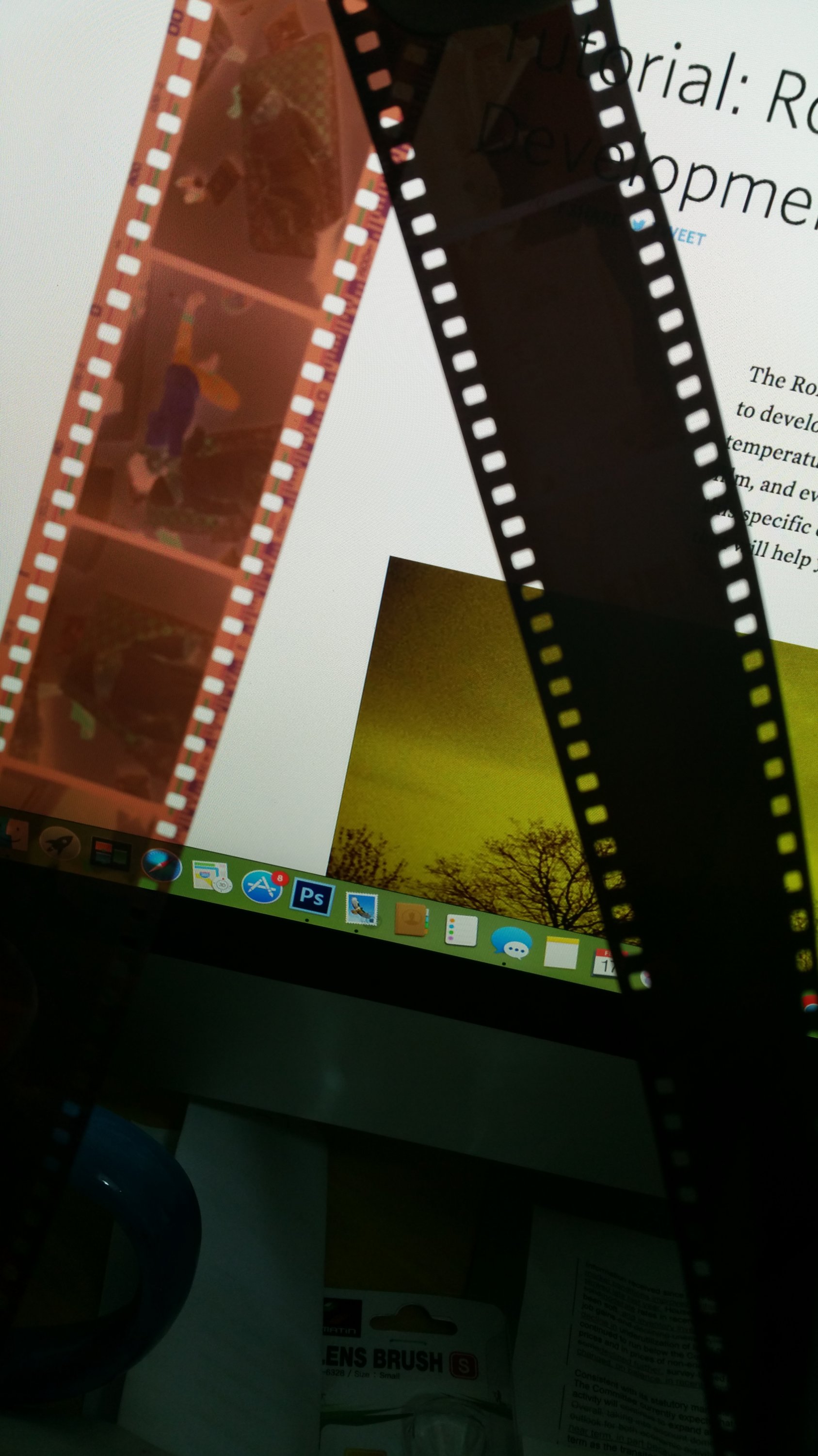

Hi
Left one processed in lab, Right one which is dark at home.

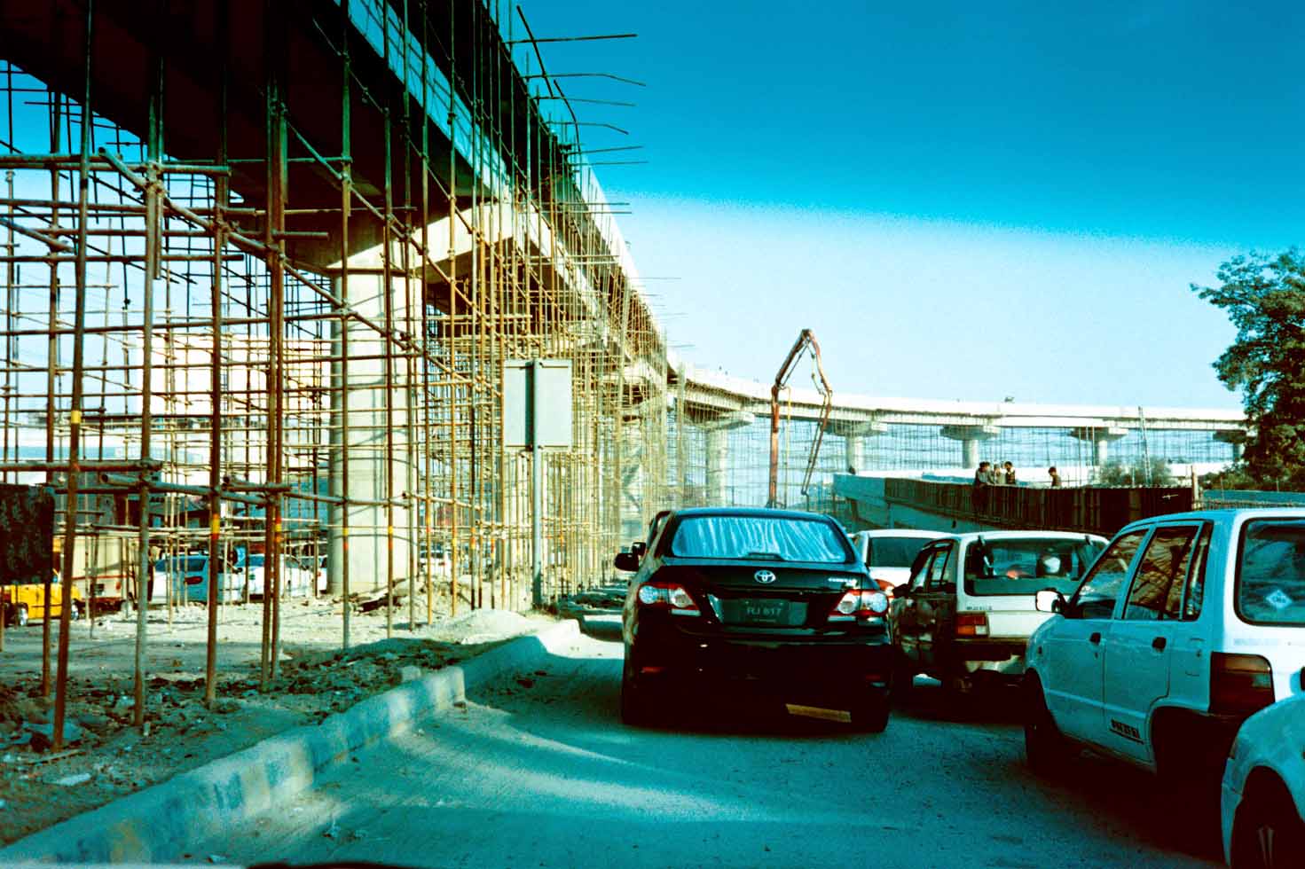

Ok, well that is what I need to do some guessing. First, the roll on the right made the image you posted earlier of the yard scene, right?
If so, something is seriously wrong with the process. Looks like fog overall and IDK what the source is because if it were overdevelopment, then the image you posted would be much worse than it is.

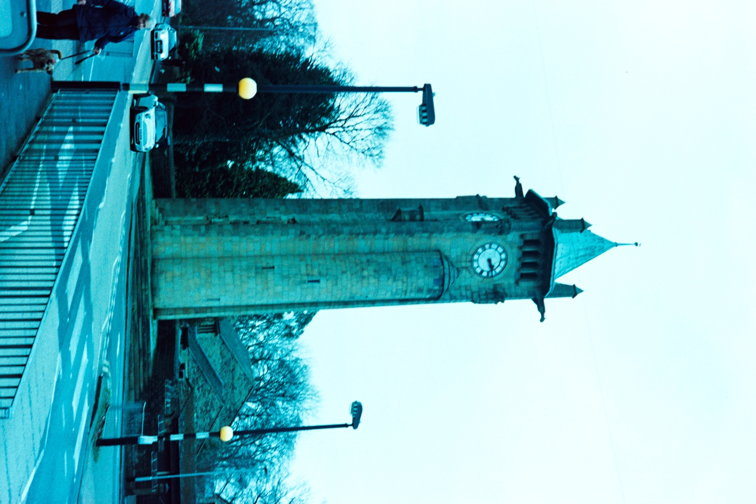

Okay PE,
Some good news, I managed to do another roll, Which i had shot half way but i couldnt wait as this problem was over my nerves. we have some exposed shots which is a good sign.
FIlm is porta 160 shot with rollei 35s.
But scans has greenish cast.
Abutate
Feb 16, 2016
77
GB
Can you tell me whats wrong with this scan? this roll has this blueish cast.

It says JPEG on an image of curling paper. I do not think the scan was up loaded.
MattKing
Apr 24, 2005
53,159
Delta, BC Canada
That looks strongly cyan.
Is there any potential source of red light fogging?
