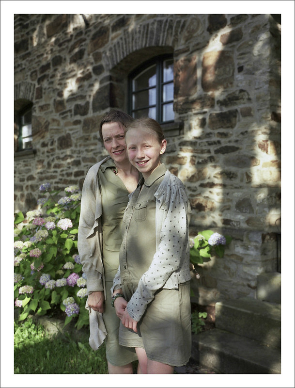

Sometimes ago I got a Tiffen Gold Diffusion FX Filter*1 (Light Loss: 1/3f:stop) for cheap - tried it a few times and I like it (it does a little warming and diffusion on the Fuji Pro400H).
FUJI GA645 - EBC Fujinon f/4 60mm - FUJI Pro 400H with Tiffen Gold Diffusion FX Filter*1

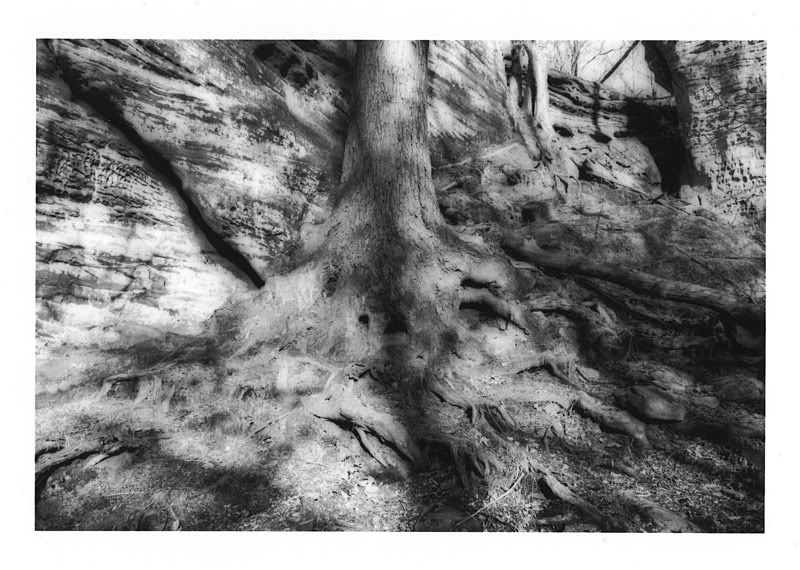

This is an example of what Jimgalli wrote above in post #13. I used a diffusion filter during the printing stage.
