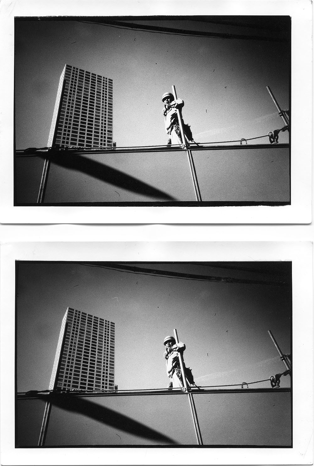

I have just upgraded to a Beseler 23CIII-XL with a VC head from a Lucky 90M-D which was a condenser enlarger with an opaque bulb.
I did a comparison, same negative in both enlargers with a 10 minutes difference between enlargments and developed in the same exact tray of developer. The whole experiment took about an hour.
Paper was Grade 2 from the same box.
1. The Condenser (semi diffused via the opaque bulb) enlarger had more contrast. It's a lot more evident when I hold the prints then just seeing the scan below. By the way the scan (which I know is a frowned upon word here - apologies) was done at the same time with the two sheets op 5x7 scanned in one go so no variations in tonality as it's understood by the sensor.
2. The Condenser enlarger printed the negative at f16 for 12 seconds and the VC head at f8 for 15 seconds. That's a little over 2 stops of difference.
Overall I liked the condenser but still having just gotten the Beseler, I let the Condenser one go. I have a tiny darkroom so only one enlarger can stay. I might shop around for a condenser head for the Beseler as I really like that enlarger minus the fact that focusing has no fine-tuning knob which makes it very hard to focus, specially with the head high up.
Questions (I just started printing 14 months ago):
- When using VC paper, I need to turn the filtration off for focusing and then back on for enlarging. This is a lever that does something mechanical (moves the filter discs below the light I assume) and this takes some force. It isn't hard but you definitely feel some resistance moving this switch and the head shakes a little. I assume the beseler is a sturdy enough machine not to lose focus. Is this okay to do or I better not touch the head once critical focus was set?
- When using the VC filtration, I can't see anything of an image projected through the red safety filter. I print large and my easel isn't perfect so I need to have the red safe image projected on the paper to adjust the placement of it on the easel. This again means I need to flip the switch to get the "white light" - use the red filter to adjust the paper - put the filtration back on again hence some shaking of the head. This relates to the first question but what I am wondering if there is a way to see a safe image projected on the paper with the filtration turned on?
- When enlarging to 20x24 paper from 135 film, i needed to print for 30 seconds @f4. Two things worry me here, f4 might not be as sharp as f8 and the 30 seconds time already seems long. I am perhaps just used to the condenser's quick printing times but if I wanted f8 at this size, I'd need to enlarge for 120 seconds and I worry this is dangerous for getting shakes in the head etc? I do stand still but still but anything can happen in the course of 2 minutes. I also enlarge wall projected sometimes where this 120 seconds would jump to be 4-5 minutes easily.
Thanks a lot,
Ben
p.s. Here is my enlarging example. Top is the Condenser. I choose a very high contrast image - ASA250 film shot at 1600.

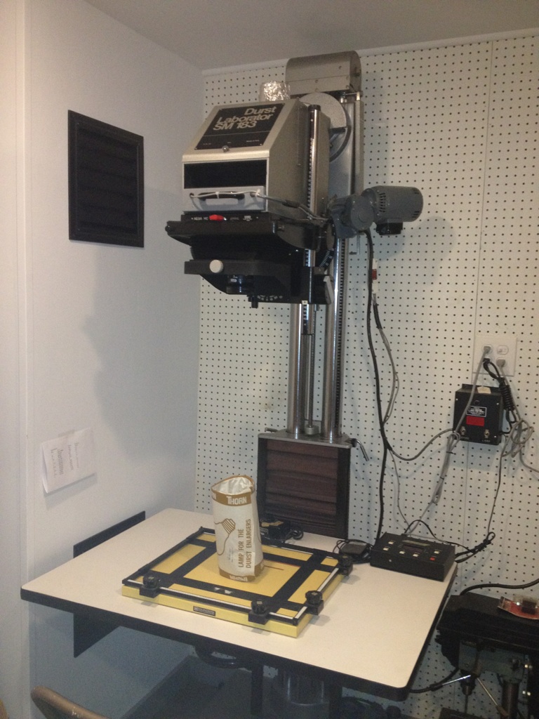

Oh gosh, Luis, somebody tried to give me one of those SM183's a couple months ago, but with a colorhead on it. No place to put it. I did bring back a
184 8x10 unit with colorhead, and now am into the final fine-tuning, having completely refurbished and rewired it. Hell to haul up two set of stairs in
a downtown industrial basement. Even worse to get into my lab. So one was enough. I already had four other large format enlarger, one of them
bigger than anything Durst.
