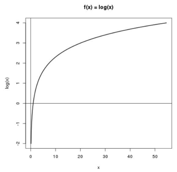

Diffraction is a significant effect for radio fading in and out at the limits of the range (what I implied but could have been clearer on).
So Nodda Duma (just if I understand correct what you stated here) - you also would descibe the procedure of defraction [you used the term "fade out - fade in"] like it is shown in the following graph :
You agree ? But then a kind of 3mm roule can't be much precise! Would you also agree?

No. I’m not sure why you’re showing a log plot but that is not representative of diffraction-affected signal strength. Look at the cross-section of the magnitude of the Bessel function (or sinc function). It’s the classic Airy disc cross-section in one-dimension with all its side lobes. You can research online. I just googled “diffraction signal theory” (no quotes) and found a ton of info that can explain it far better than I can typing with one finger on my smart phone. :smile:
If you’ll allow me the indulgence of repeating myself: when stopped down, diffraction isn’t the only thing that comes into play for determining what the blur is. However, the effects can be and are accurately modeled with the tools available to a lens designer. All of the discussion of approximations are just that: approximations. The closest this thread got to how it’s really calculated was the Bessel discussion which is way too mathy for photographers (no offense...it just requires a foundational knowledge of very complex math to derive the solution which even physicists outside of electromagnetics would struggle with).
If you really want to learn to model diffraction accurately, pick up the book “Fourier Optics” by Goodman. Diffraction is fully describe in there without approximation.

[QUOTE="Nodda Duma, post: 2170355, member: 61906" Look at the cross-section of the magnitude of the Bessel function (or sinc function).
If you’ll allow me the indulgence of repeating myself: when stopped down, diffraction isn’t the only thing that comes into play for determining what the blur is. The closest this thread got to how it’s really calculated was the Bessel discussion which is way too mathy for photographers (no offense...it just requires a foundational knowledge of very complex math to derive the solution which even physicists outside of electromagnetics would struggle with
If you really want to learn to model diffraction accurately, pick up the book “Fourier Optics” by Goodman. Diffraction is fully describe in there without approximation.[/QUOTE]
Nice play to tempt TRENDLAND to ever pic up a book again in his life.....Nodda Duma:kissing:....:D:laugh::D!
seriously - I noticed there is obviously a failure to the graph and that is obviously in regards of
failure of log - function :sad: = no log function:sad:! But what you stated Nodda Duma redirects back
to the Bessel function - indeed!
Thanks much for clearing up a bit Nodda Duma!
