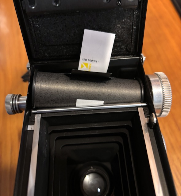

I'm not sure what's going on with my recently purchased Rolleiocord V, but I am having great difficulty removing the exposed film rolls from the camera.
After rewinding, I open the back and pull out on the spring loaded metal plug opposite the rewind knob. The film spool pops up on the one side as expected, but it really does not want to come out!! There is nothing much to get a grip on -- I've tried pulling up on the paper film backing, and trying to leverage it out by pushing and pulling on the raised end of the spool. But it takes way more force than is reasonable to pry it out. Is there something wrong with my camera, or am I missing something about the process?

To add to Matt's point on the position of the winding knob: There is a tab that goes into the end slot on the spool. To deal with each extreme position- if the tab is aligned top to bottom in reference to the camera, parallel to the film plane and lens board, upward rotation of the spool is limited. If the tab is aligned 90 degrees to the film plane, and lens board, has one end pointing backwards at you, then the spool has the most upward rotation.
Once you get it out, use the empty spool to run some tests. The winding knob is directly tied to the winding tab, so you could put a small drop of paint or such on the winding knob (side serration?) so you can orient the tab down the road.

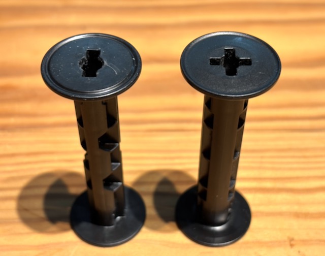

Looking at a handful of 120 film spools, I have two basic types. I believe the "keyhole" shaped holes (on the left) are from Kodak films, and the "cross" shaped holes are from Ilford/Kentmere films (need to verify that). Trying them out for fit in my Rolleicord V, the spools with the cross-shaped holes are definitely more difficult to remove than the keyhole versions.
Among the keyhole versions, some are easier to remove than others, but as a class, they are all easier to remove than the cross-hole versions.
I don't believe it is a difference in length that makes the cross-hole spools fit too tight, but I think it is the inner diameter of the hole which is gripping the shaft of the wind knob too tightly. After I drill the end holes of the spools with a 7/32-inch bit, they are much easier to remove!
So I prepared a half-dozen film spools by drilling the end hole with a 7/32" bit. Drilling the plastic leaves a semi-melted burr inside the slots which had to be shaved off with the tip a sharp knife (don't forget to blow out the crumbs). To save time, and to preserve a good fit on the other end, I drilled only one end of each spool, and marked it with a metallic silver Sharpie pen. Not sure I'd want to try this without a drill press; if you use a hand drill, take care to avoid injury!

Looking closely at the left-side spool knob, when I pull back on that, the entire shaft retracts, and no part remains inside the walls of the camera interior. In other words, in my case, there woud be no benefit in grinding off the end of the left-side shaft. I am convinced that whatever the problem is, the source of the problem is on the right-hand side -- something to do with the winding knob shaft.
As best as I can measure with my old-and-worn Eldi vernier calipers, the round part of my Rolleicord wind knob shaft is 5.5mm in diameter. And the round part of the recess in the end of the spools I have measure 5.1-5.2mm. My theory is, the undersize holes in the plastic spools are gripping the end of the wind knob too tightly.
