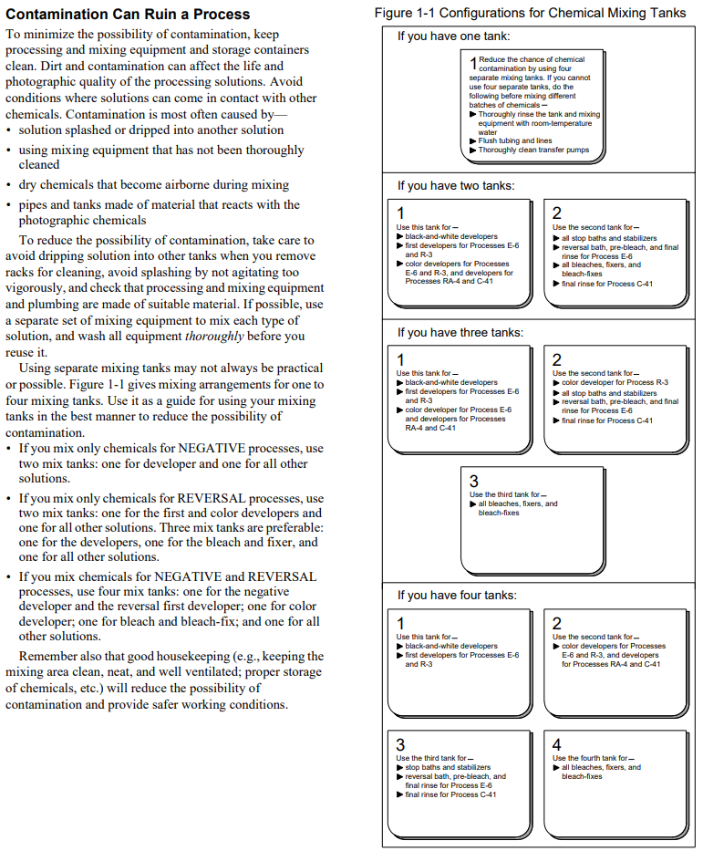

Kodak's recommendations for mixing BW, C-41, E-6:

This advice is obviously hinting at commercial labs with huge, static tanks.
In an amateur set up, any tank can easily be rinsed completely.
The Kodak advice understood your way would mean that in a chemical lab, utensils would have to be limited to certain reactions, whereas it is general practice to just rinse them and putting them into storage (concerning aqueaus solutions as we use).

Of course, nobody is going to keep 4 mixing jugs at hand. I use one jug for everything. But since OP already has more than one set, he might use the information how to use it best. And then there was a question on who the heck was stupid enough to suggest something like using more than one jug in the first place...

If one uses seperate jugs to line up at a processing run for the different baths, even marked, one of course could use them for preparing working solutions. Thus ones mind is at ease concerning jugs.

The mixing instructions are great advice for commercial labs. Probably just a few labs left with a need for mixing huge quantities. Keep a tidy darkroom.
