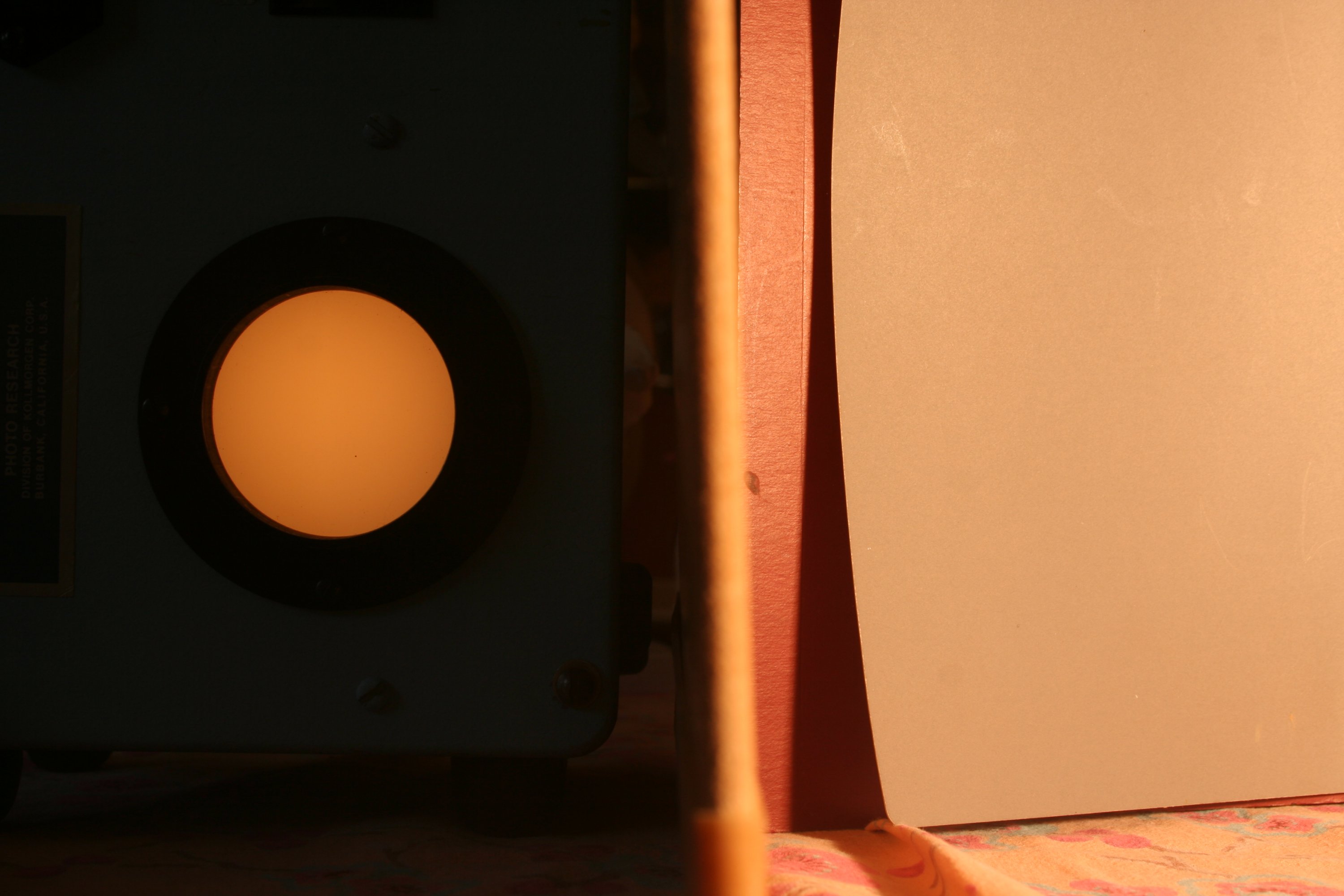

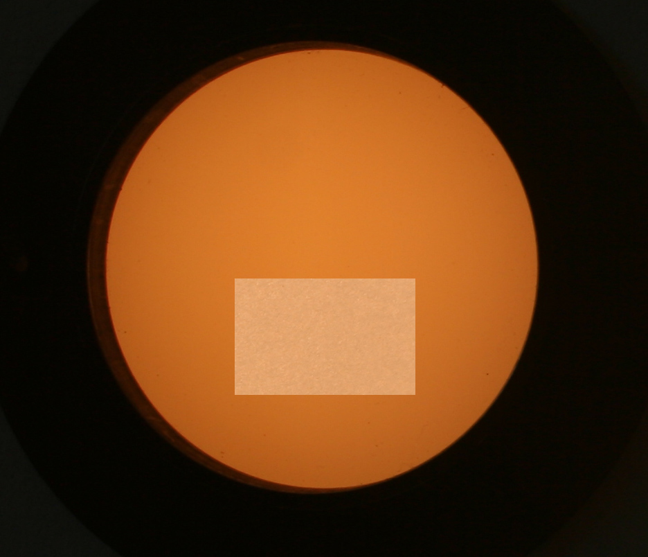

It's true the angle is important, wiltw has demonstrated that changing the angle can give almost any reading.
So I followed the Kodak instructions and moved my gray card so that it is in accordance with the angles recommended by Kodak: 1/3 from camera to perpendicular, 2/3 from card to light source.
Then I moved the light until the incident reading on the gray card side matched the spotmeter reading of the reference source.
Then I took a single shot and in Photoshop, I superimposed the results.
The gray card is the square in the middle. It appears lighter.
As a corollary experiment I moved the light until the spotmeter agreed between reference and gray card.
I had to move the light away farther. Then an incident reading indicated a lower amount of light, as might be expected when you move the light farther away.
Sekonic L758-DR used for both readings. Tungsten photoflood bulb. ISO 100, the meter reads 30 f/11.6 at the reference source with spotmeter (reference source is nominally 100 foot-lamberts). Then when spotmeter agrees gray card reads 30 f/11.6, the incident reading was f/11.2 with the dome retracted and meter aimed at light source, f/11.1 when aimed at camera. With dome out, it read f/11.0 whether meter aimed at camera or at light source.

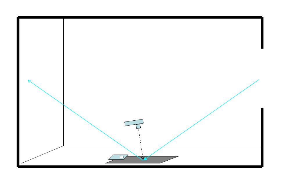

As Bill pointed out earlier, I had done a shot series showing the effect of angle on the perceived brightness of a gray card, as seen by the lens yet exposed with a single shutter+aperture combination, with photos posted on APUG in another thread. So consistency of method, such as you set up, can be important in a very consistent setting (the studio).
