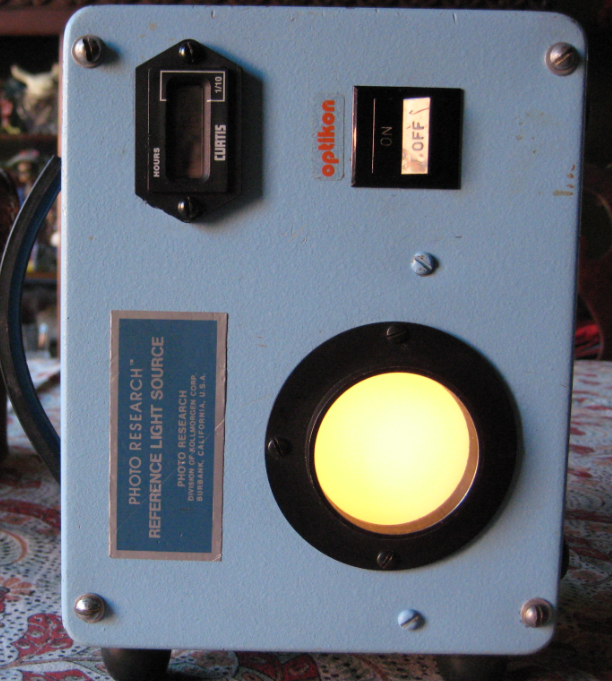

Meters are calibrated to something like this... which makes a more stable and reliable test setup... than trying to get the reflected light off a gray card to come out the same every time. wiltw has demonstrated how hard that is.
If I were to have my vote for purposes of discussion, a reading off the gray wall, if it were about 12.7% gray, would possibly correspond to the incident light meter reading.
But there are a lot of discussions about what the percentage is, why and what brand of meters that pertains to.
All within 1/3 EV, so just discussion points. If you want something practical, pick one or the other and run with it.
