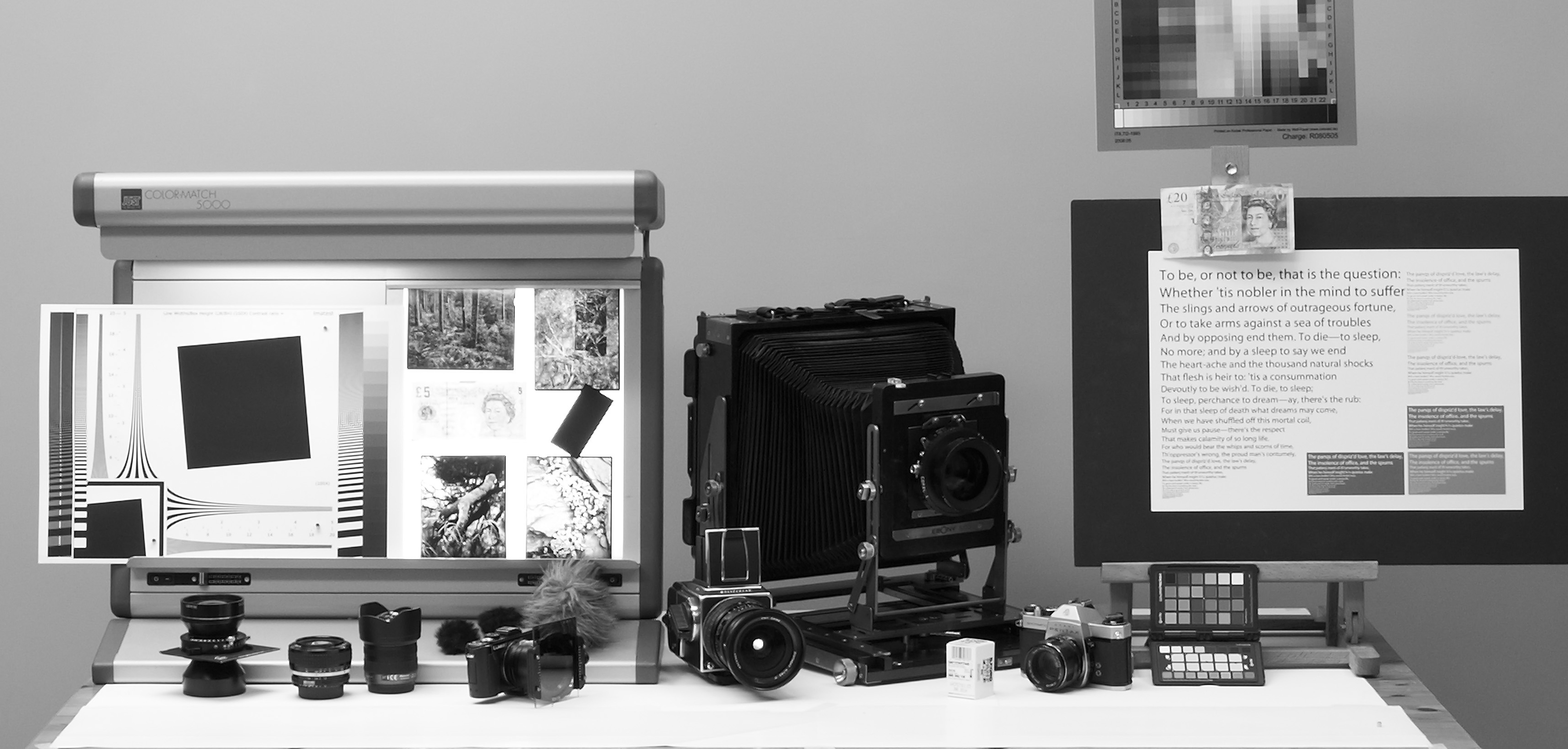

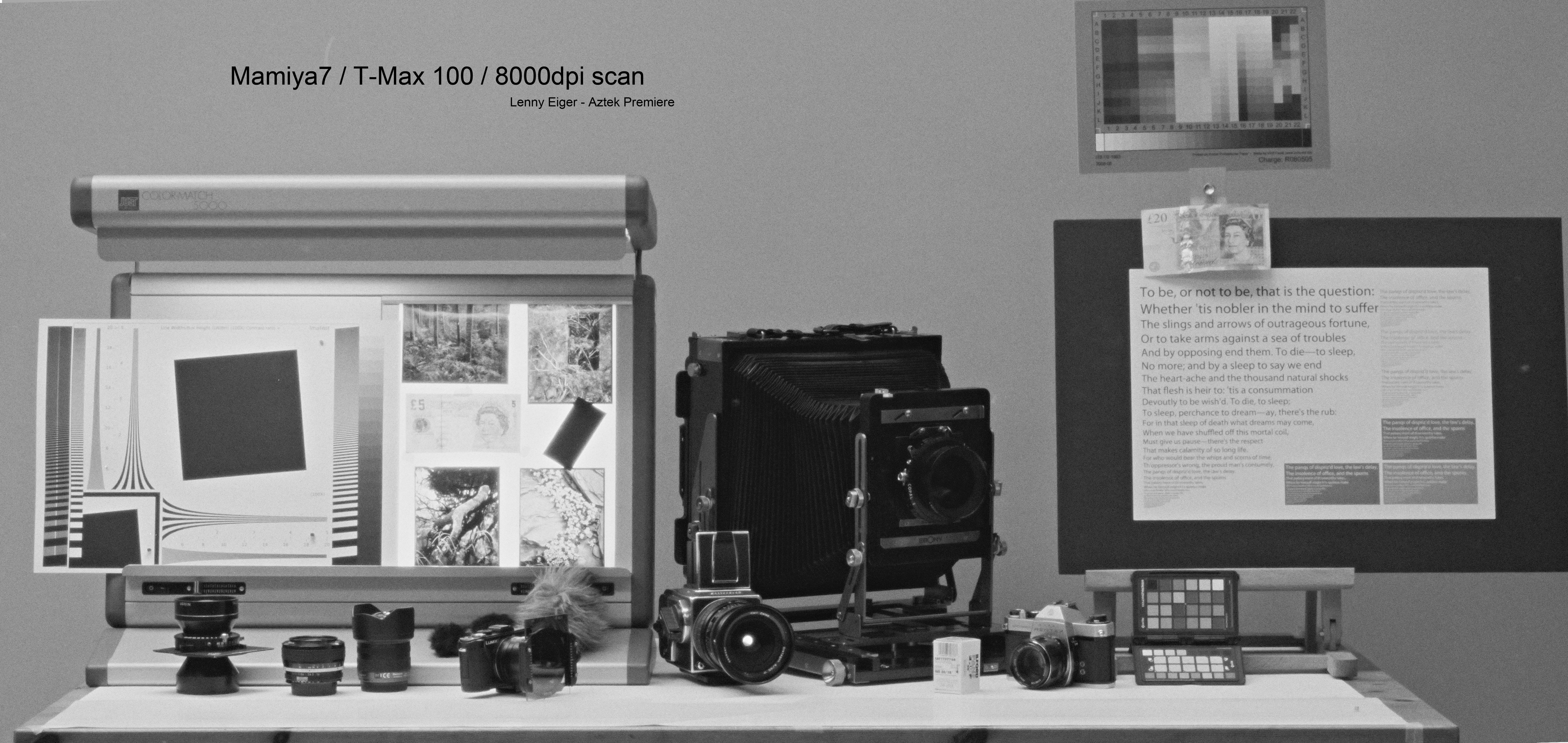

timparkin
Sep 2, 2006
212
Compared to a completely digitally acquired and proccessed monochrome image printed via the injet, are there advantages to using a scanned 120 format negative that would be printed digitally? Is there more dynamic range in the scanned larger negative? Can you manipulate the contrast, exposure, highlights/shadows as much with a scanned file?
http://static.timparkin.co.uk/static/tmp/d3x-bw.jpg
http://static.timparkin.co.uk/static/tmp/mamiya7.jpg
Now obviously the mamiya is scanned on a drum scanner but it's the potential of film. I imagine a Nikon or the new Plustek would get a result that still beat the D3X (or possibly D800) by a bit but then if you did find an image you loved, you could send off for a drum scan.
As for the film itself, colour portra 400 has about 5 or 6 stops more than the latest digital cameras (so about 16-18 stops) and black and white potentially gets that much with some trick developing - I think it would probably be about 12 stops at a push with normal developing (where the last few are in the shoulder roll off). I haven't tested black and white myself but have done so with the colour neg.
