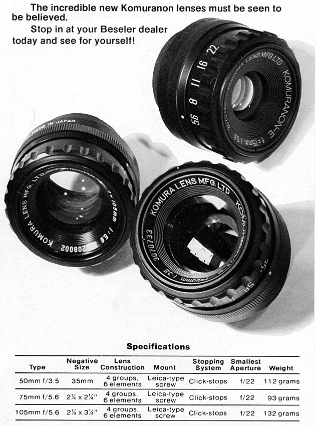

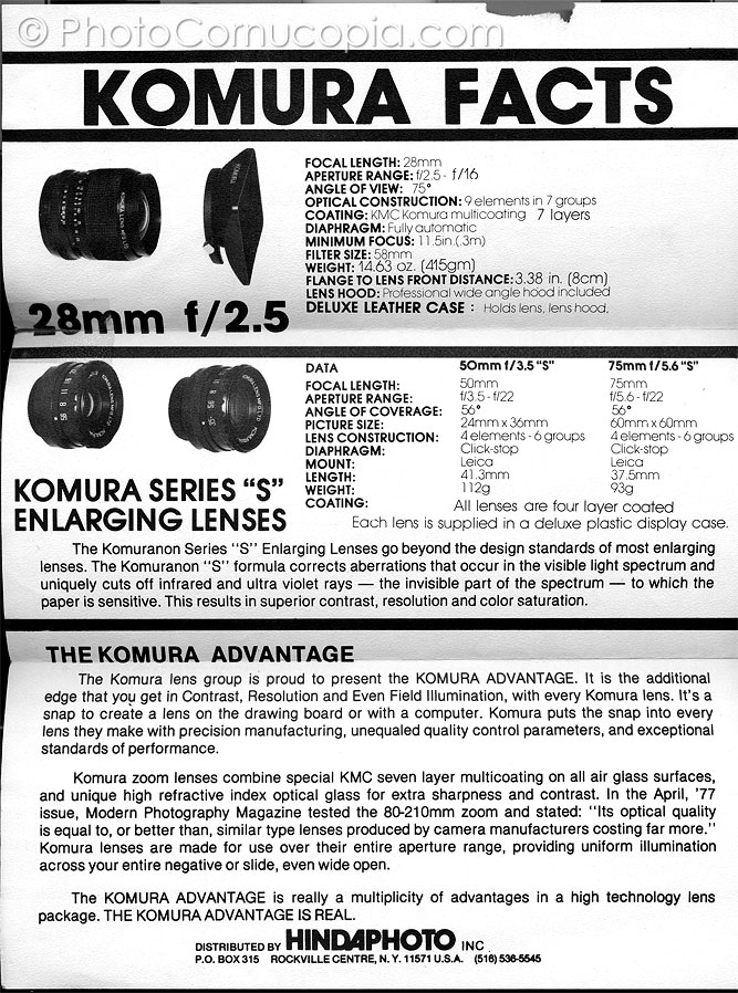

Note the typographic error in the brochure, “Lens Construction: 4-elements, 6-groups”
Obviously, this should read “Lens construction: 6-elements, 4-groups”
This is correctly stated in the table further down in the brochure.
The "S" lenses are six element in 4 groups. The E are not as well designed and cost less.
Brochure is wrong, they mixed up elements and groups. The box in which the lens is shipped correctly identifies the lens as 6 elements and 4 groups.
Same as what Ian just posted.

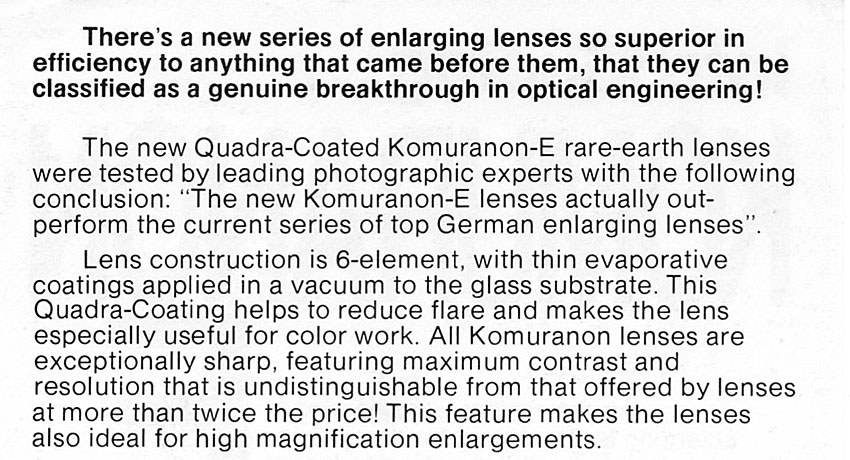

I started to write an article about the Komuranon-E lenses late last year but didn't have enough info to publish the page. Yesterday I published it inadvertently when I updated various other pages so I've left the page up (and uploaded the attached images and properly added it to the index page too).
Komuranon-E Enlarging Lenses
It doesn't add much to the question about these lenses and is a work in progress. I will add to it as I get credible info. But my suspicion is that the E and S lines are identical bar possible coating differences, but presently this is only conjecture on my part so not worth a pinch of anything.
I've seen (and have the image but can't post it because it's not mine) the box for a Komuranon-E 5.6/75 which states it is 6E-4G, ie same as Komuranon-S 5.6/75. The E and S lenses that I have appear to be of the exact same build (I haven't compared coatings) although I don't have E-S pairs to compare directly (I have a pair of S75, a pair of E50, a pair of E105 and they all look and feel the same).
Yes I think you are correct and I was wrong. I did find this picture with the "E" box showing "6 elements". I only have an "S" but no "E" to compare side by side.
