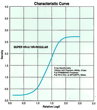

I haven't used either, but I did have a quick glance at the datasheets for both:
Super HR-T30: https://asset.fujifilm.com/www/uk/files/2021-05/5ab45153071d63774da94736378573d7/SuperHR-T30.pdf
Super HR-U: http://www.fujifilm.gr/src/Fujifilm/Downloads/SHR-U.pdf
The characteristic curves tell at least part of the story of the differences:
HR-T is higher contrast; its curve is steeper and it also shoulders off at a significantly higher density. The latter isn't very relevant for most pictorial photography where you'd probably be working at densities lower than 2.0 for the most part. For alt. process printing and in particular processes like carbon transfer, salted paper and new cyanotype, the HR-T might be preferable, but the HR-U will work (almost) just as well.
If you scan and/or print on enlarged silver gelatin, I'd expect you could produce comparable results from both films, but with slight adjustments in exposure and processing. You might have to give the HR-U slightly more exposure and development to obtain identical negatives.
