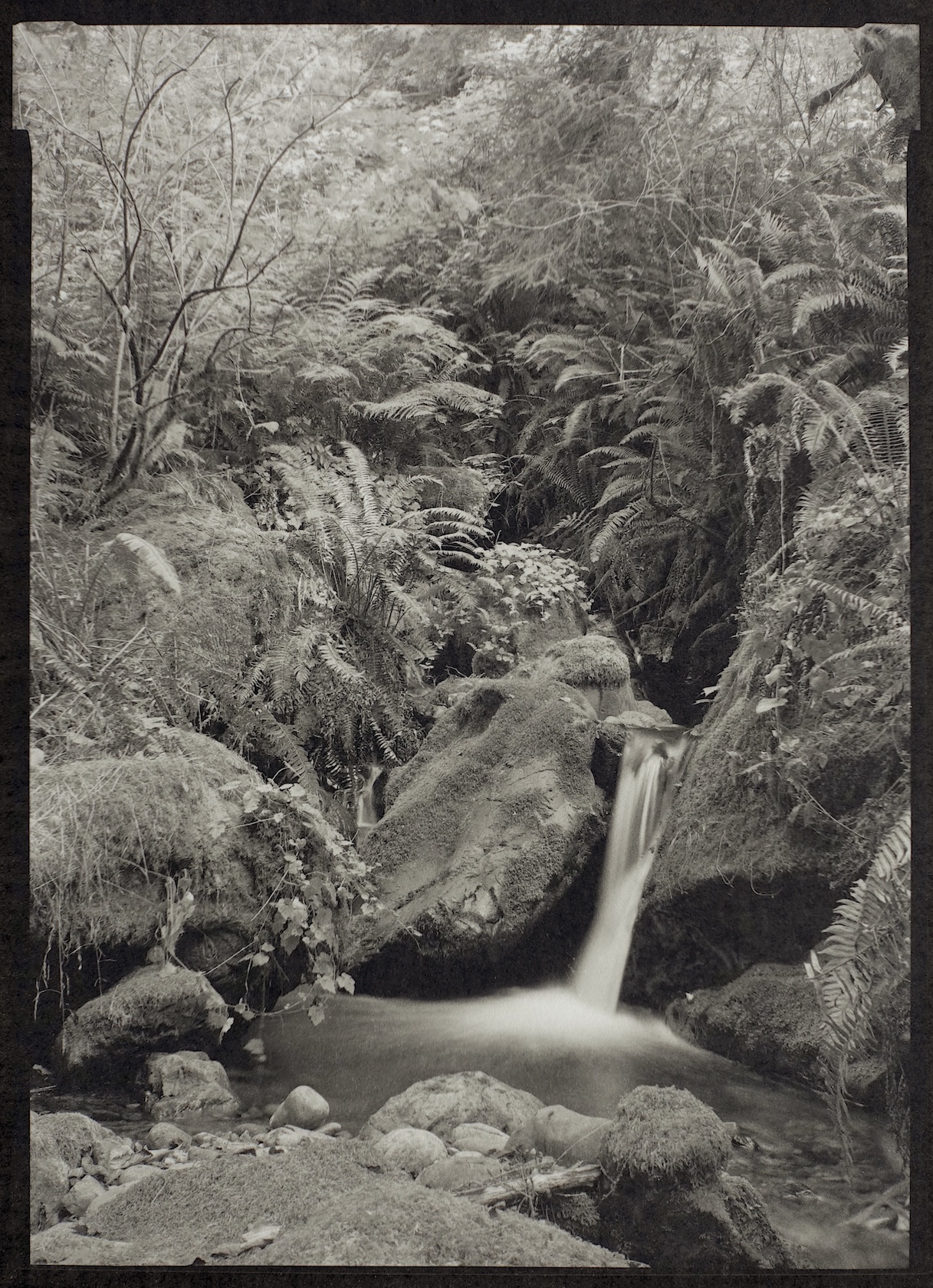

Ossagon Creek, 2020
5x7, 180mm lens
Platinum/palladium print
