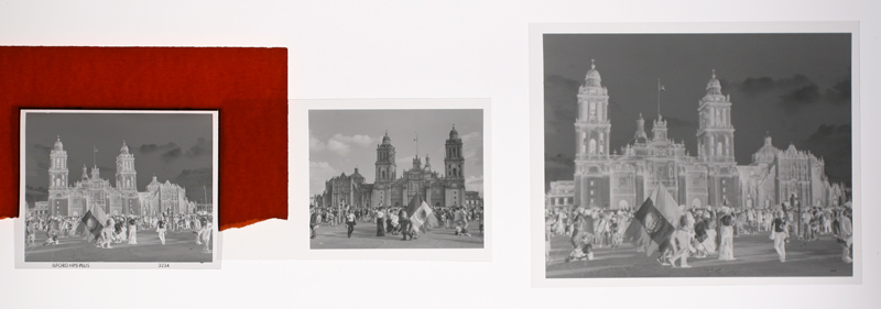

I'm making enlarged negatives using only Bergger BPFB-18 film.
It's not cheap but it works great for this.
I do this:
I do the interpositive by projection and I make it at the same size of the original, and then I enlarge the interpositve to the final size.
I use ILFORD MG developer.
Look what I get:
Juan Carlos
