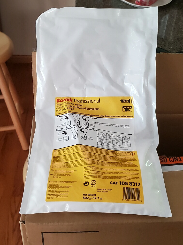

I received my HCA today, November 2019 mfg date. Looks like this was already in the warehouse at Unique Photo.
Huge bag.
