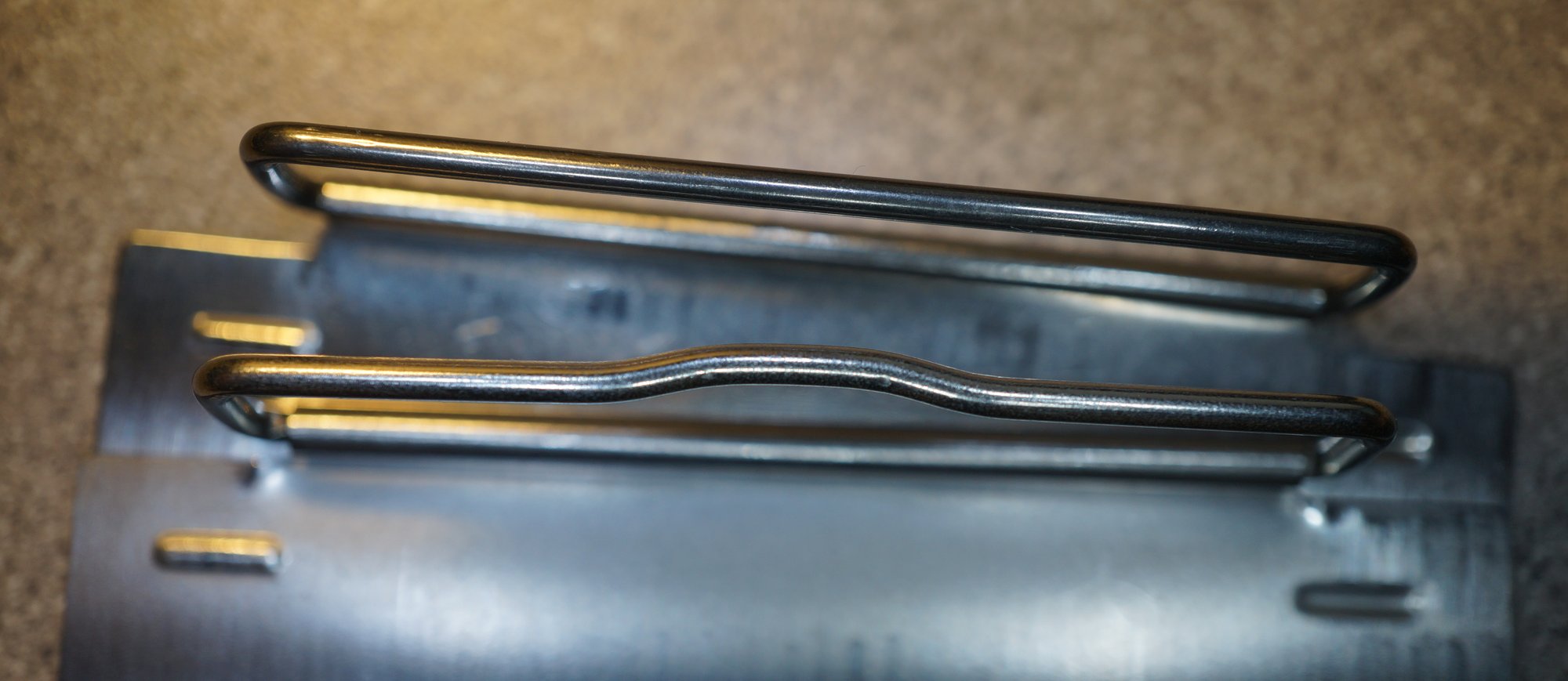

Besides the dark slides for the Polaroid and 70mm backs, did Hasselblad sell different versions of dark slides for their 120 film backs (A12, E12. A16, E16, A24, E24?) Does anyone know if they had different model numbers? I ask because I own two E12 backs, and they came with slightly different dark slides, and I want to figure out if they are both Hasselblad originals, or maybe one is aftermarket. The easiest difference to see is that the handles are shaped differently. On my first E12, the dark slide has a straight handle that fits snuggly in the dark slide holder. My second E12 came with a dark slide that has a "bent" handle with an indentation in the middle that prevents it from "clicking" into the dark slide holder and I want to buy a replacement.

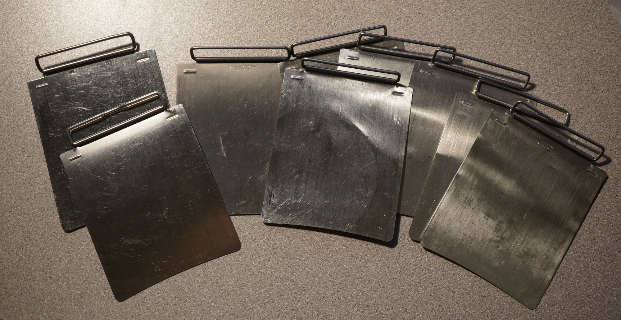

I have both types mentioned by Sirius
The 2 on the left have different handles

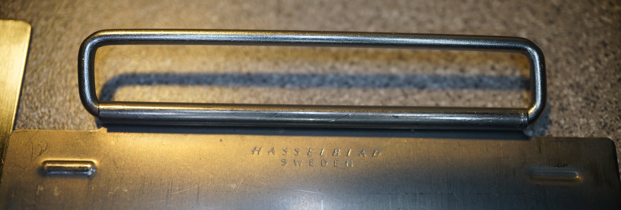

All original Hasselblad dark-slides are stamped "Hasselblad Sweden"
All the dark-slides pictured here are stamped thus.

IAll original Hasselblad dark-slides are stamped "Hasselblad Sweden"
Thanks! That's really helpful. Neither of the slides that came with my backs are stamped like that. I guess that means that both my backs came with aftermarket slides?

Maybe they're ones from a Kiev 88 ...
Kiev dark slides are slightly narrower than Hasselblad's, a Kiev slide will fit into a Hasselblad back, but a Hasselblad slide will not fit into a Kiev back. When a Kiev slide is in a Hasselblad back, there is a small amount of lateral play, but the slide appears to remain light tight (I have not tested this extensively, so don't use my word on this).
Kiev dark slides do not have the 2 dimples at the handle end of the slide. And obviously are not stamped "Hasselblad Sweden"
