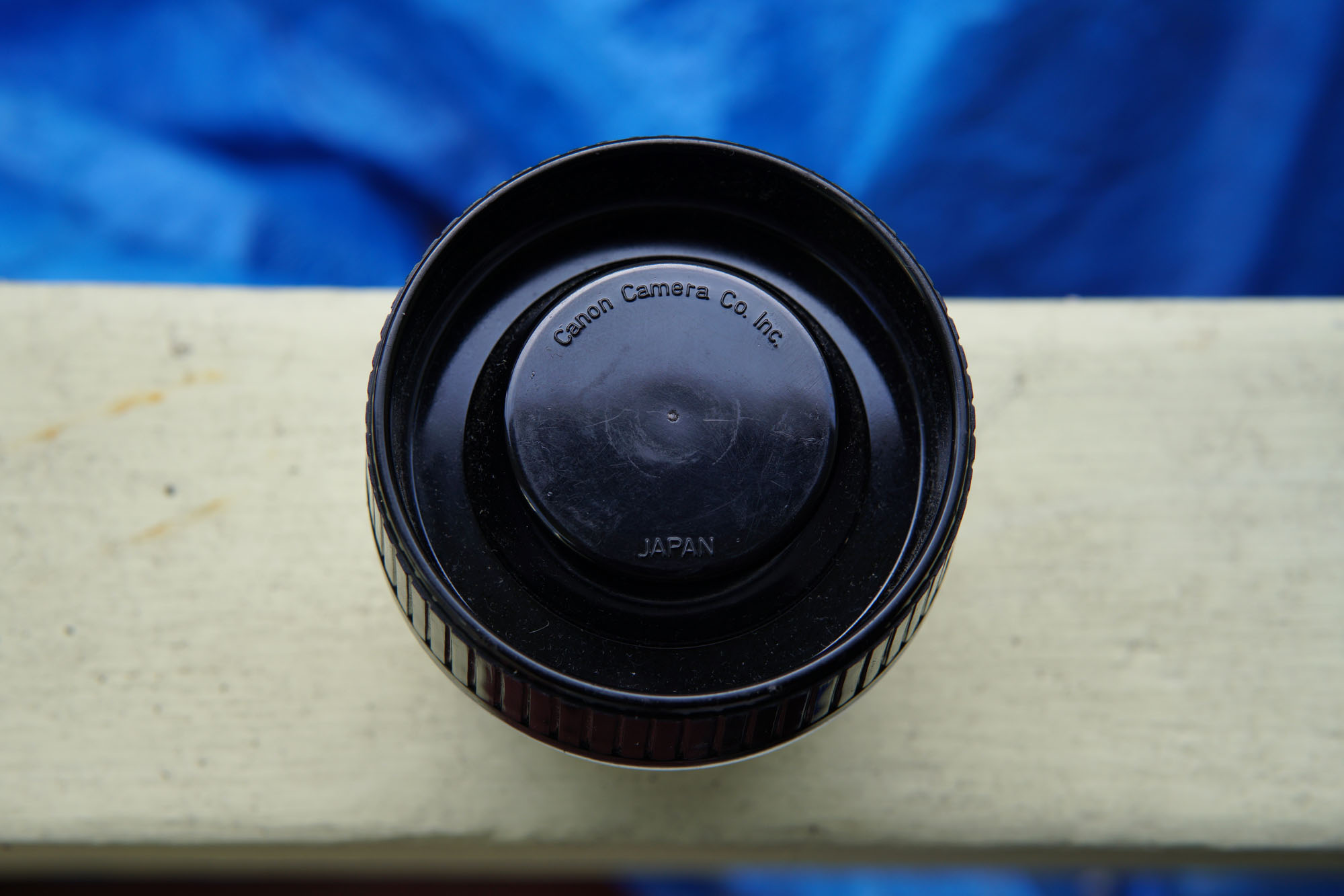

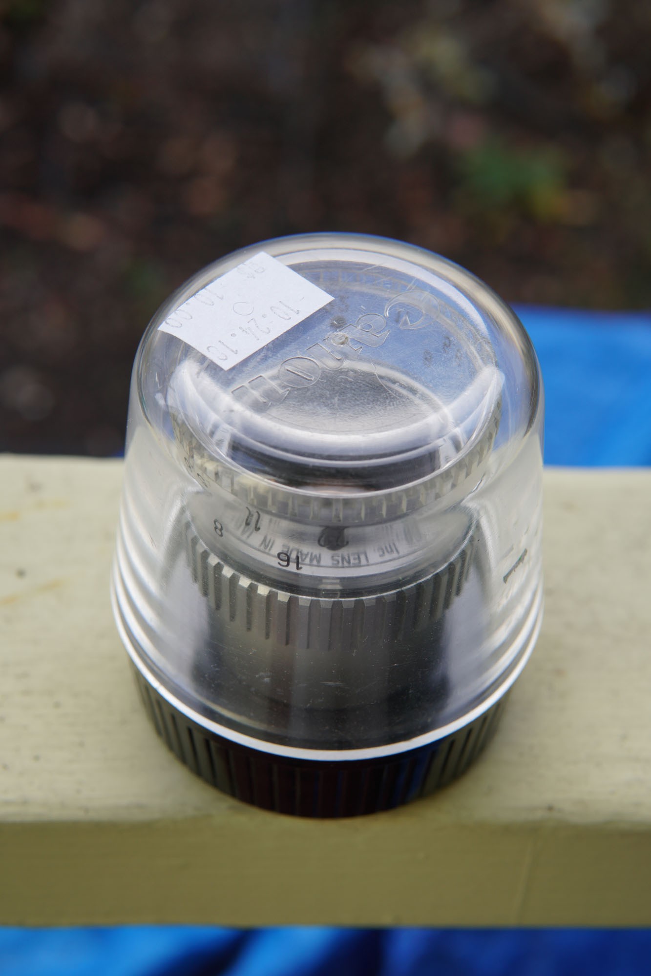

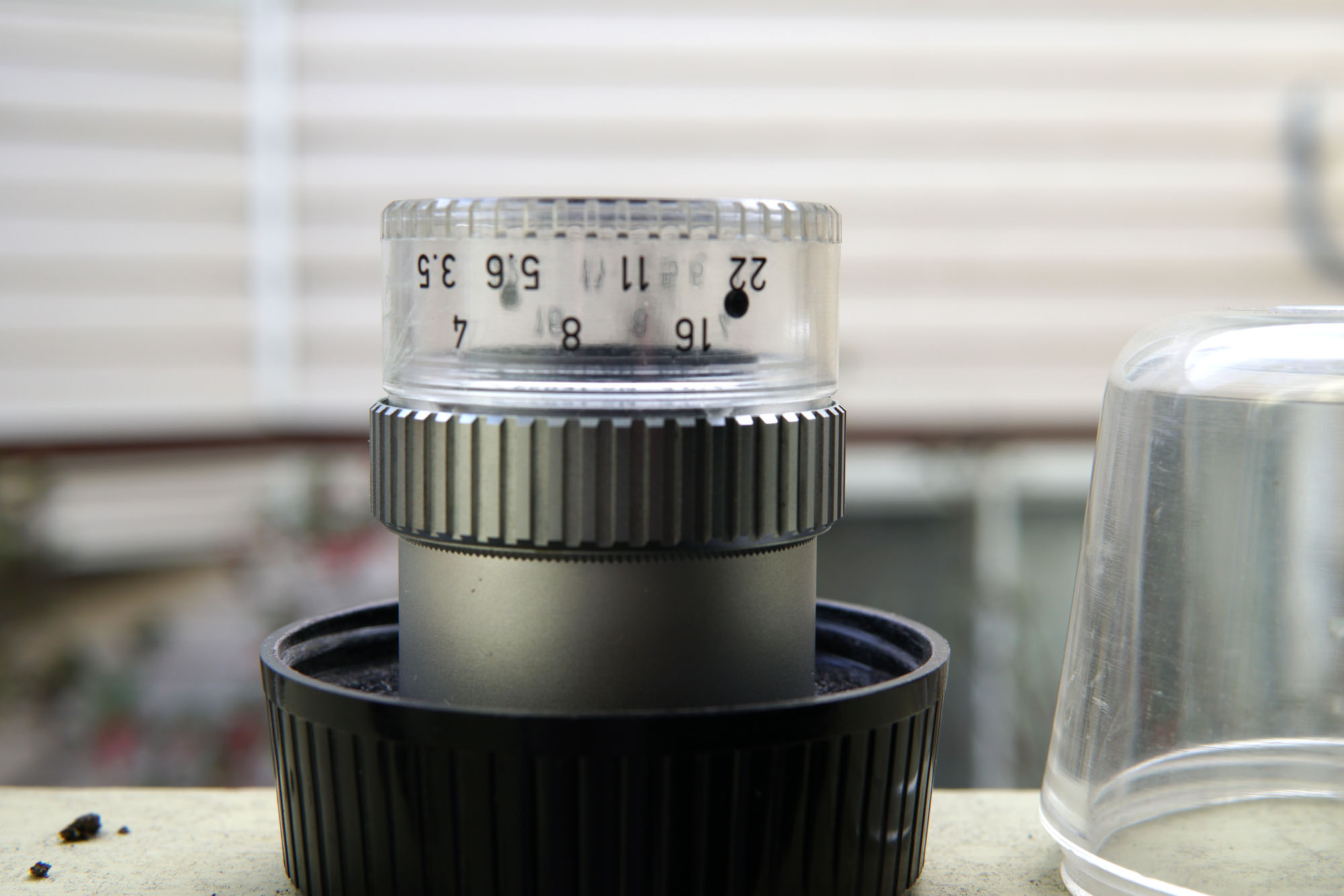

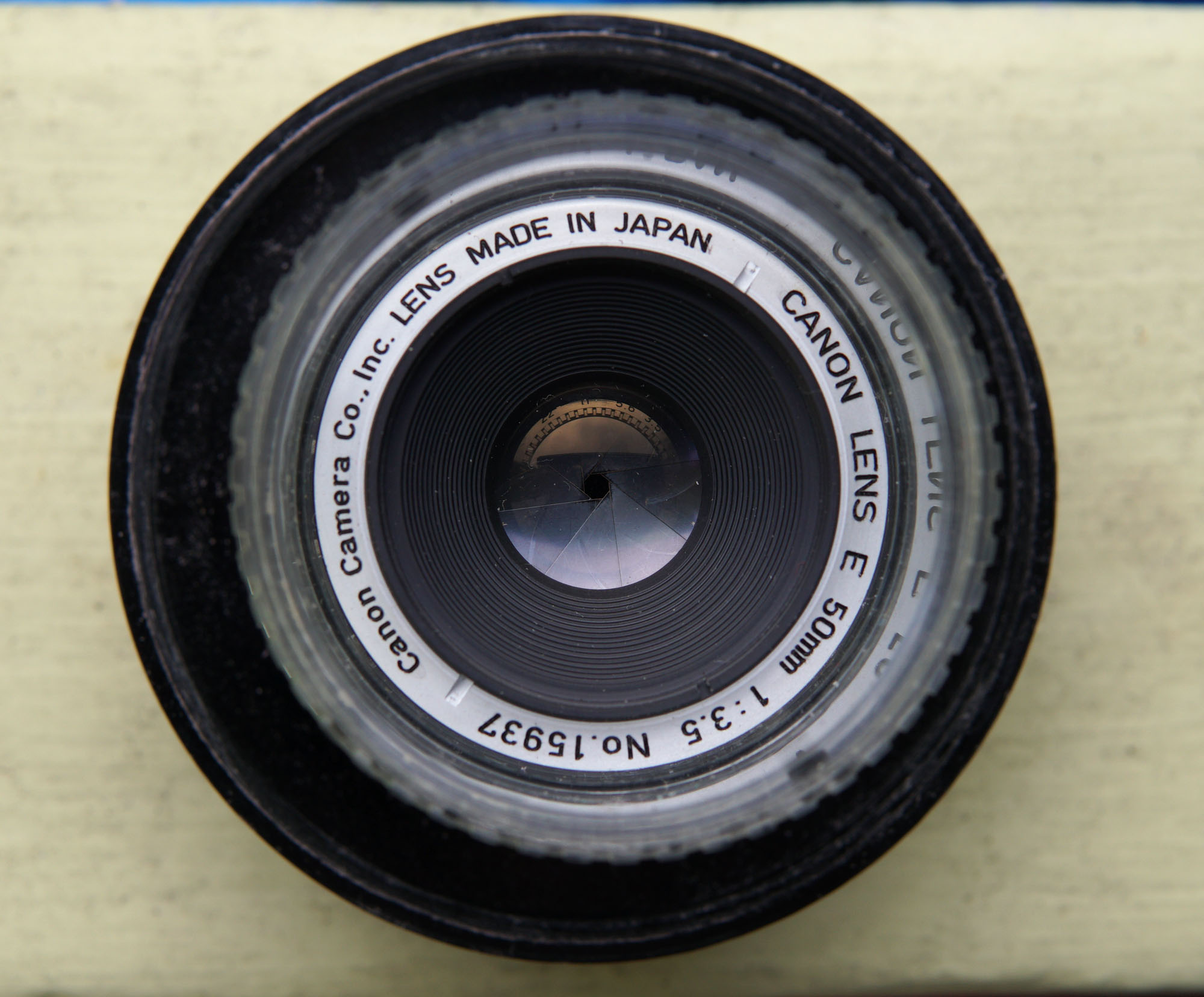

I stumbled upon this old thread researching the Canon 50mm f3.5 enlarging lens I just bought. There are a few really cool junk stores in the SF Bay Area- one of my favorite (East Bay Depot for Creative Re-use) had this very unusual specimen behind the glass. It's in one of those enlarging lens plastic storage bubbles that is stamped "Canon Camera Co. Inc" Japan. What attracted me to spend $10 on an enlarging lens for 35mm neg? I'd never seen nor heard of Canon making such lenses, It's silver (not that I really care about lens color, just that it's unique,) it has an extension tube for reasons I don't understand, and best of all it has this plastic collar with the aperture readings on it that I think would making reading in the D.R. very easy!
I probably own half a dozen, and I work in a college darkroom where I could use any of their two dozen or so 50mm this was just a fun purchase out of curiosity.
Photos to follow.....
halberst
Jul 12, 2005
14
Alameda, California
(here are the photos...)

Yes, I've seen that one. I wonder how the aperture works?
Mackinaw
Jan 2, 2005
706
One hour sou
Peter Kitchingman has a nice write-up on this lens in his Canon rangefinder lens book. To quote, "The aperture markings are on a clear plastic front section, which also has a set of opposing aperture stops with two large black dots on an internal fixed plastic ring. The outer plastic ring adjusts the aperture settings, while the black dots indicate which F-stop is being used."
BTW, the lens in the picture shown is a Tessar-formula lens produced from 1964 to the mid-70's. There was an earlier Seiki-Kogaku lens produced in 1945. Those are very rare.

Hansa Canon made an enlarger before WWIIso I guess they sold an enlarger lens with it most likely a Nikkor lens at that time. I have the adverts in BJP Almanacs.
Later Canon E 50MM f3.5 Enlarger Lenes do surface very occasionally in the UK, they don't sell for much. One sold in Canada on ebay last month for $3.25 (US). They aren't desirable, buy one if you want you won't need to spend much and just don't expect a lens up to modern standards..

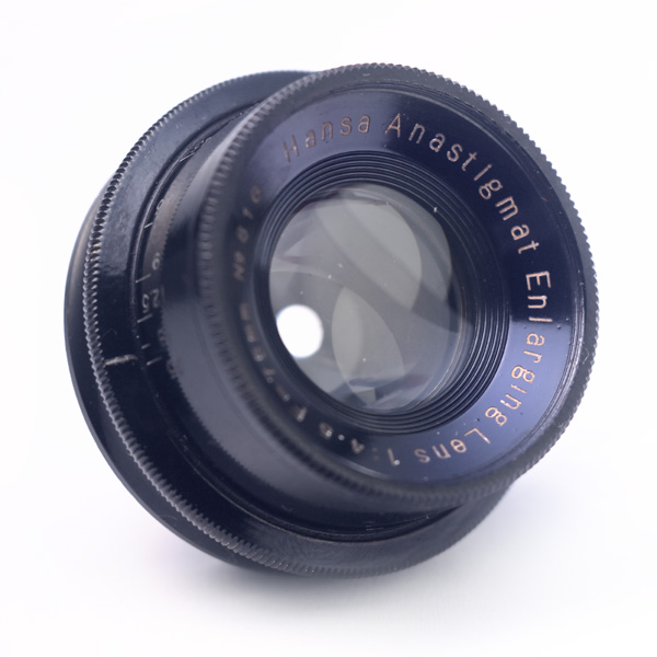

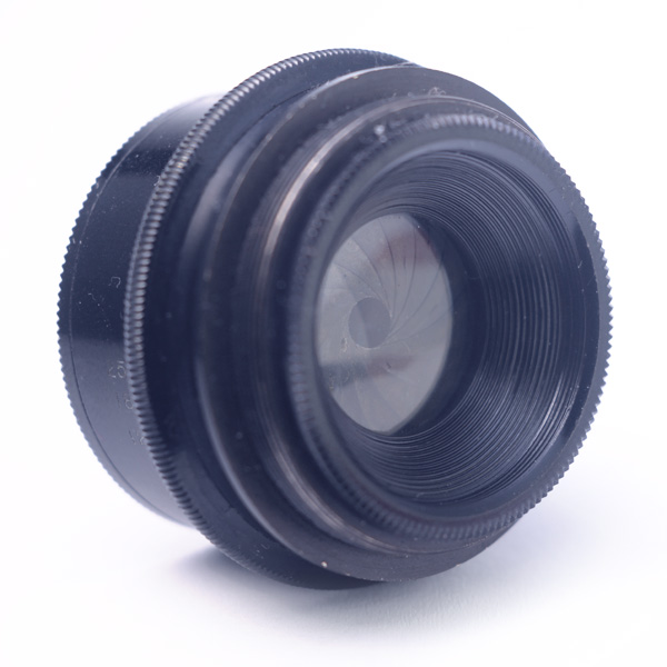

Sorry for digging up this older thread... I'm sure the general interest in this niche Canon enlarger lens isn't too great, but I'm very curious, because I recently adapted one of those and used it as a taking lens, and it's significantly better, than I expected
And because I got a significantly older enlarging lens, which probably was on a Hansa enlarger originally, I was also wondering, if you could perhaps share those adverts you mentioned to see if it's possible to recognize the lens on there. Would be very interesting to know because I still have no idea of the maker. The lens is only labeled "Hansa Anastigmat Enlarging Lens".

That's a great shot simplejoy. I clicked on the photo and looked at more of your enlarger lens macro photos. Yes, that Canon lens seems to be the pick of the litter, at least for use as a macro lens.
I'd like to see how it performs w/ a wet print. All the 50 lenses I've used to make prints worked well, even the old Nikkor 50 4 w/ scalloped edges. It made very nice prints stopped down. My 6 element Beseler HD 50 2.8 lens was sharper on big prints, but unless the 2 prints were side by side you would probably not notice.

Thank you very much - glad you think so! As you mentioned for now there are only a couple of macro-shots on Flickr, because I haven't used it a lot. So overall it's kinda hard for me to say right now where more severe limitations might start to show, but I'll continue testing it and upload a couple more shots, perhaps even some at distance, where it looks like it might do pretty okay - for an enlarging lens that is!
No idea how well it might work in its intended field... For the most part people seem to put Tessar ELs a step below 6 element lenses, but I've heard pretty glowing reports about the Taylor Hobson Ental II lenses (at least the shorter focal length lenses are Reverse-Tessar designs as far as I know) for example, putting them at equal footing or even above many of the 6 element ones. But I'm sure it depends on many factors (some already mentioned in the thread) I don't know anything about...

That's really interesting - thanks a lot! I'm quite fascinated with the shared history of these two companies because for some time I also only knew about the generic Hansa enlarging lenses, which exist with a variety of other labels (like Soligor, Prinz, Computar, Saunders etc.) on them. But the one I've got seems significantly older. It might really have been on one of the Hansa enlargers around the time they released the "Hansa Canon". So far I'm not convinced that whoever made the newer ones (which are mostly Triplets as far as I know) was also responsible for the manufacturing of this earlier series of lenses.
This is how it looks like:
As far as I can tell it's a Tessar. There's no indication on it that it was made in Japan, but I would assume it was.

Interesting that you think so - that's what the creator of this thread seems to have wondered about as well, and after trying the Canon Lens E 50 mm f/3.5 (as a taking lens on a modern camera, mind you... so I can't comment on its qualities for enlarging) I'd say it's a real pity. It's significantly better than I would have expected:
Here are a couple of shots taken with it.
