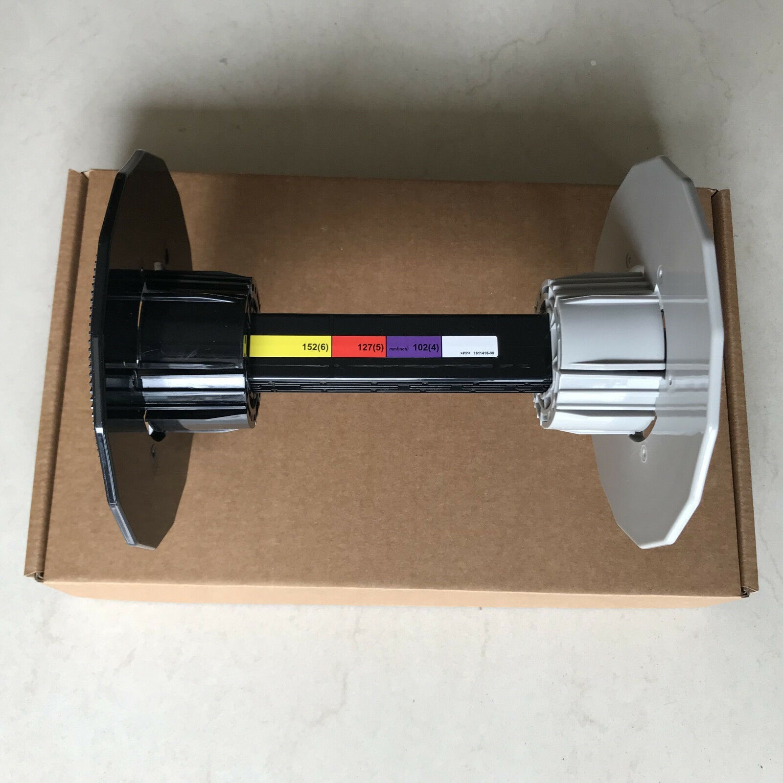

Hello everyone, I've a question. What is the diameter of the roll spine for Fuji Crystal Archive Type II and Kodak Endura Premier? I want to buy a paper dispenser like this to ease cutting, but I'm not sure if I can mount the roll into it. I looked up the datasheet but can't find information about it.
Thank you

That Amazon kraft paper "cutter" looks ridiculously underbuilt for RA4 paper use. It's really a thin paper tear-off device rather than a true cutter. It's going to give you crinkles and lack of squareness, if it can even handle the weight and thickness of photo paper, which is unlikely.
It won't work as a cutter, but if you line it up with eg a rotary cutter (so that the amazon product basically is only the spindle that holds the roll), it may work. But it looks to me that the spindle is too thin, and also that the legs/mounts are too close to it to hold a full roll of paper. So it's a bit of a problematic product for this purpose without extensive modifcation.
I wasn't planning on using it as a cutter, I've a rotary cutter. I just need it as a holder to dispense. If you know a better dispenser that would work please let me know, thanks

Ideally, you should have a spindle that will fit and support the core and that has a side (or two) so the paper doesn't unspool crookedly and you can also rewind the paper back in line with the roll.
Maybe something like this, but homemade.

it's Fuji Crystal Archive 8Inx295Ft
and another one Kodak Endura Premier 11Inx288Ft
Is the one in the picture coming from a lab machine?
Yes, if you search ebay you can find them. They are designed to fit a minilab paper cassette so they are designed to sit into a groove rather than be threaded onto a spindle.
