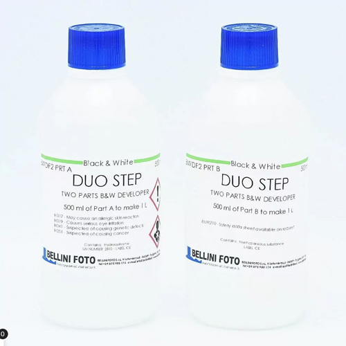

I came across this and wonder what do you think of it?
https://www.retrocamera.be/en/darkr...film-developer-part-a-500ml-part-b-500ml.html
I think that you should buy raw chemicals because 18,95 for a diafine type developer is a steal. i could make the same for 10 times less or even less if i used Sodium hidroxide+borax to make metaborate
but it should work as supposed
I had seen this at Nik and Trick in the UK as well. The price seems quite good compared to Diafine. I thought about ordering some to compare with my developers.

That appears to be a concentrate in the divided D-23 family. Calculating out from the lower volume it seems to have about 25% less sulfite and about 30% more metol than Barry Thornton's two bath. Given the testing that @gorbas did in the thread I started, this developer will have even more carryover issues than BT's 2 bath because of the higher concentration of developing agent in A. This is then worked around by the recommendation of using a one-shot bath B from cheap carbonate concentrate, which is a good solution. I expect it will be sharper and grainier than BT2.
You're right. I find it cheap and cheerful as the A bath will keep for a long time. No problem with slightly grainy results.
Yeah, my own 2B-1 two bath has even less sulfite so I was not throwing stones, just attempting to assess from the formula. Have any results you would like to share?
