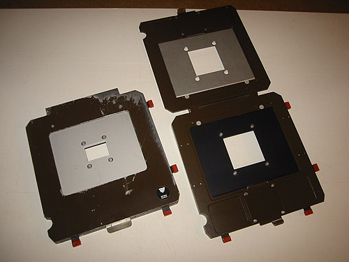

I am asking this because it seems I have an older chassis de vere and I am not sure if the carrier I have shown will fit my de vere enlarger.
For now I have this one
and I want to buy the other one called master negative carrier...
Sorry for a bit late reply, but looking at the neg carrier you are showing - I have to say I am unsure. I assumed that the neg carriers for all the DeVere were of the same construction, two flat boards with a hinge in the back.

but finally I measured both carriers and they seem to have the same sizes for the glasses so I think the latest version of the carrier fits the older deveres
