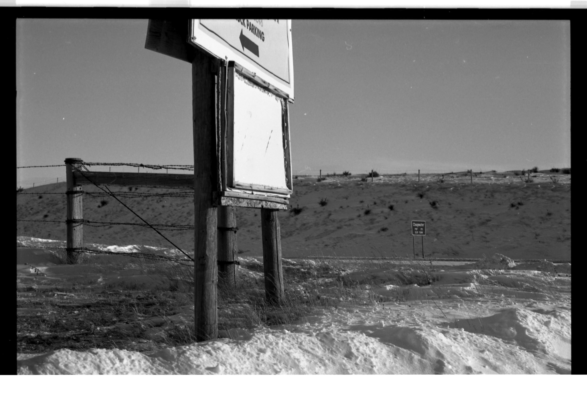

I have encountered an issue recently on some Pan-F 50 but also have noticed it lightly on some other films of uneven development mostly along the vertical edges on each side of the frame in the image area. There is essentially a lighter band (developed longer) right inside the frame edge. I would suspect this has to do with not enough agitation causing the developer to migrate, but it seems to occur just inside this area. This isnt really something I've encountered among hundreds of rolls I've developed, or at least not bad enough to notice like this. Any thoughts?

It does seem to look more like a light leak, but does occur on both edges of the film too, and I dont see it outside the frame at all

The only thing that makes sense to me is a slight light fogging along the edges of the film during exposure. I might detect a very slight banding along some of the top edge as well. I’m not certain of this.

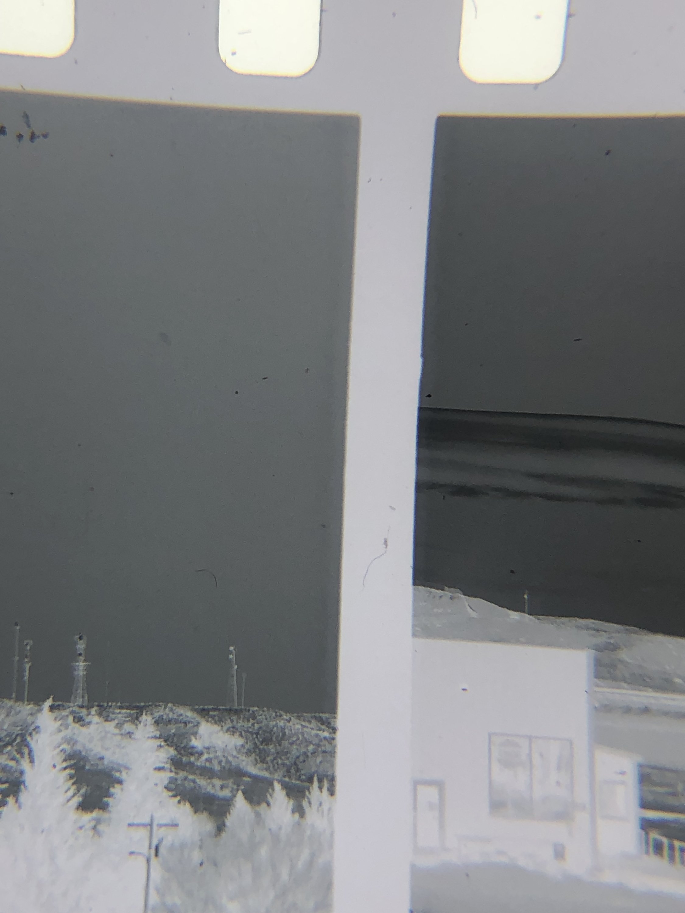

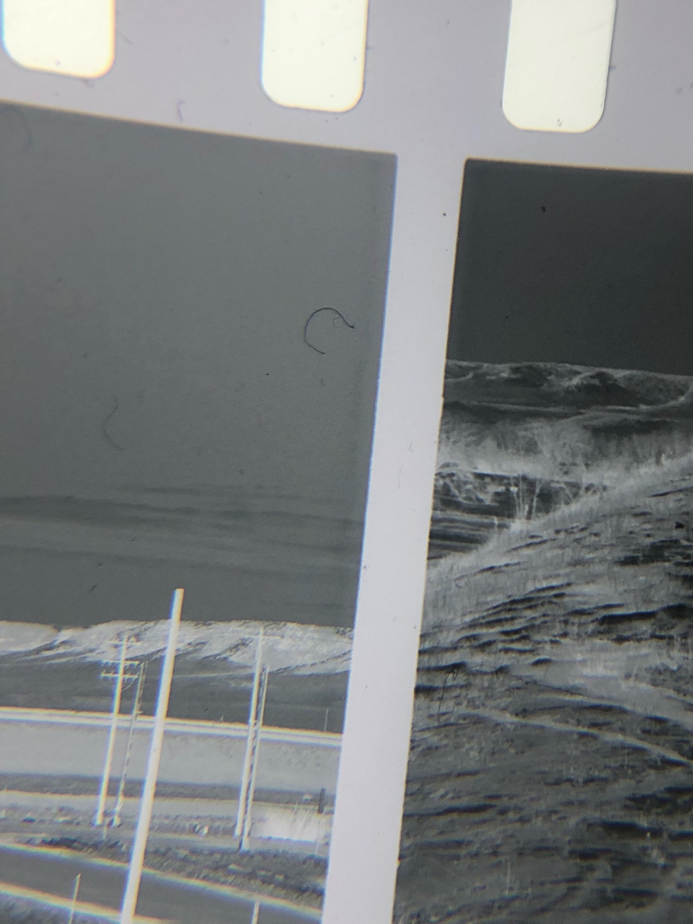

This is a scan of the negative, its not readily visible to the naked eye, but on some I can absolutely see a darker line on the negative itself. I still think the blotchy nature of it rules out a reflection, when I do get issues with the scanner they are often horizontal lines and consistent across the frame
Would you please photograph the negative, not scan, so we can eliminate any scanning issues.
That looks like the result of some sort of flare or reflection within the camera.

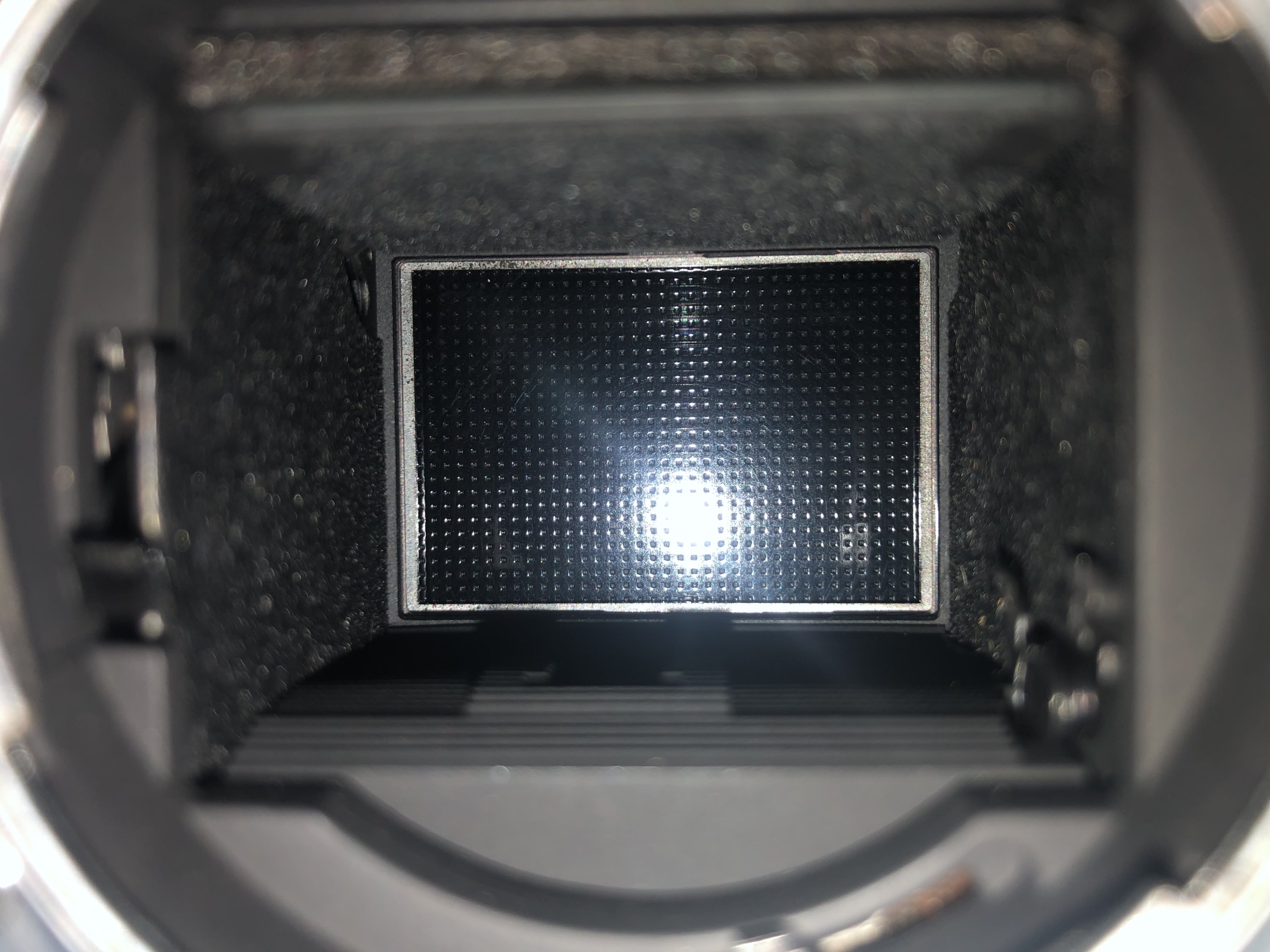

If you take the lens off and open the shutter can you see any shiny surfaces near the edge of the film gate?

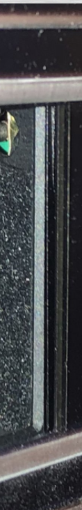

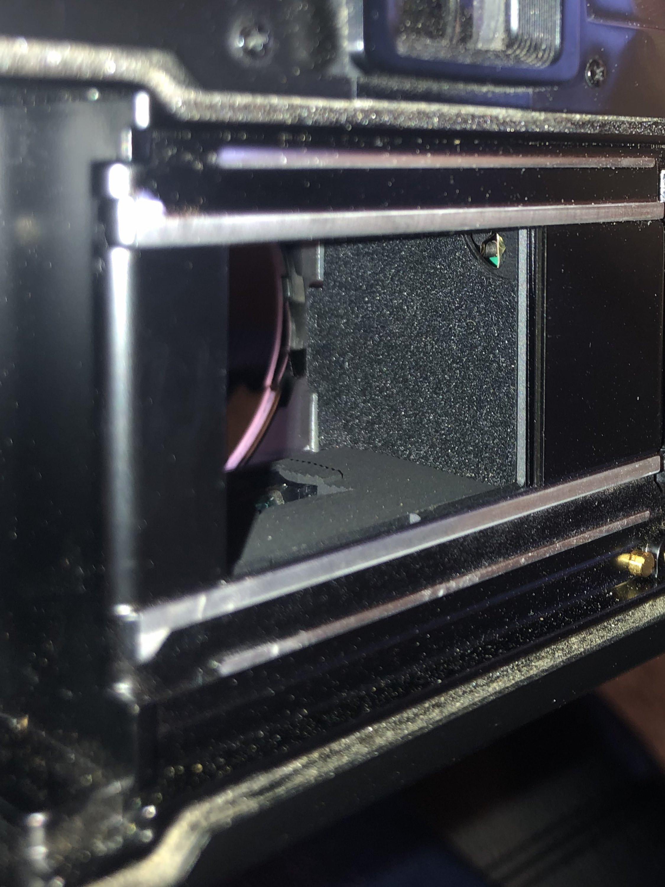

Heres what I found. It looks very much like this could cause reflections, but wouldnt this be a widely known issue with the Nikon FG if that were they case??
absolutely. If this is the cause, what is the remedy, and why is it not widely known?

I think that it is the bit shown here that is causing the problem. Perhaps that is supposed to be blackened.

Interesting question, and now looking inside the camera it appears that it may very well be reflection. But why would such an obvious issue be not well known in the FG is what I am wondering now if it is the cause
Lacquer the edges with antireflective varnish (matte black or chalkboard) and see again.
