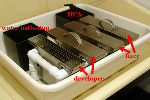

Does anyone know what item, made by whom...that I've purchased? I've turned up nothing by googling. Maybe there are makers marks on them...I may have to wait and inspect them.
jstraw
Aug 27, 2006
2,699
Topeka, Kans

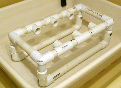

I'm pretty sure these tanks are a one-off design, either homemade or custom made for someone. Here's a picture and a picture of the rack I made out of PVC to keep them from moving around or falling over.
