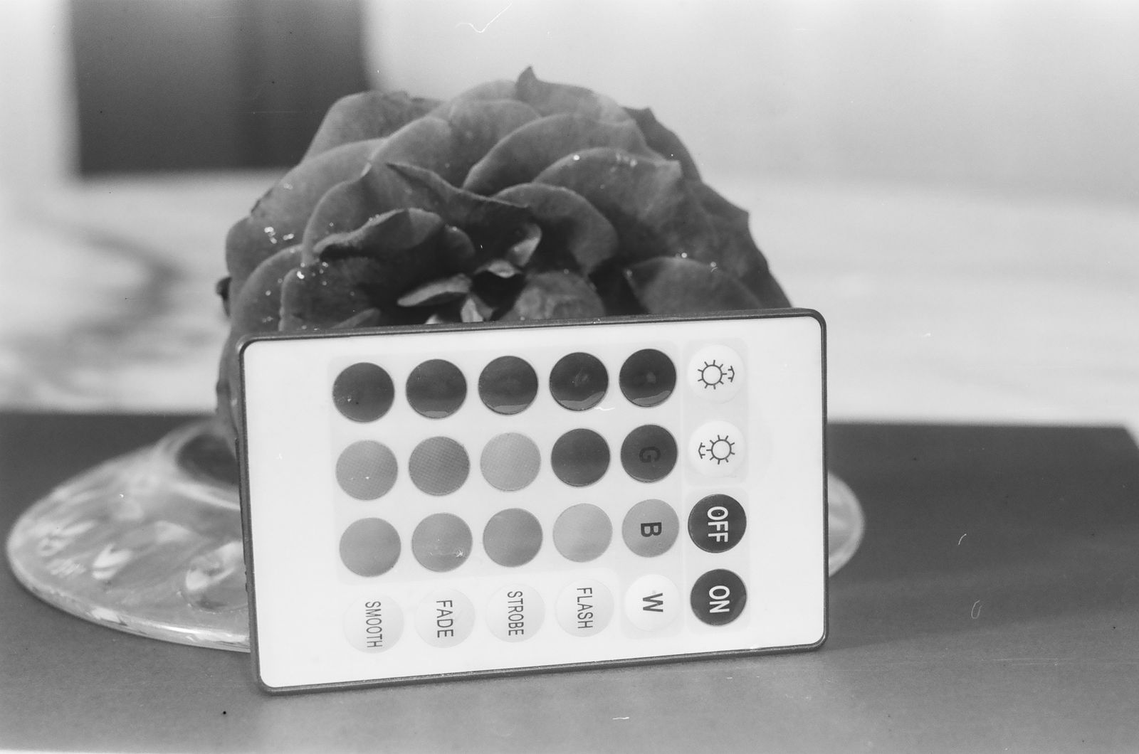

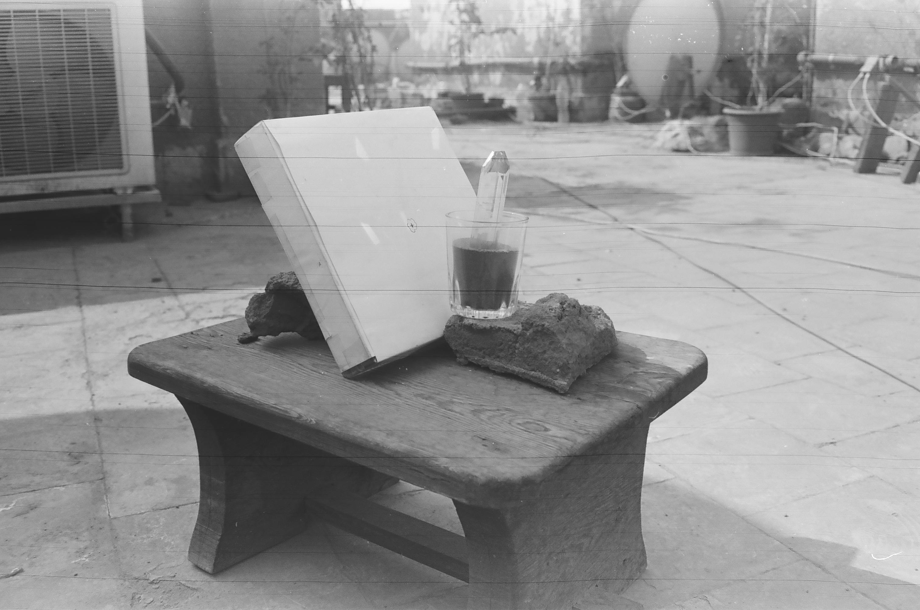

Regarding “Kodak 2612” and whether it is sensitive to green or not: I couldn’t find a reasonably priced color chart yet but I had this color labeled remote control for a strip of RGB LEDs, and I couldn’t help but trying to see if it would serve as a quick (even if less accurate) alternative in determining if the film is sensitive to green or not.😅
I shot a test roll using it and several other multi-colored objects from around the house and I got the scans today. If the attached scan is not completely off, I think the film might be partly sensitive to green. What do you think? I have more scans from this roll to share if needed.
Unedited scan (compressed using WhatsApp) Kodak 2612, shot at EI 3, Developed in Rodinal 1+100 for 18 minutes @ 20°C
iPhone photo of the frame for color reference

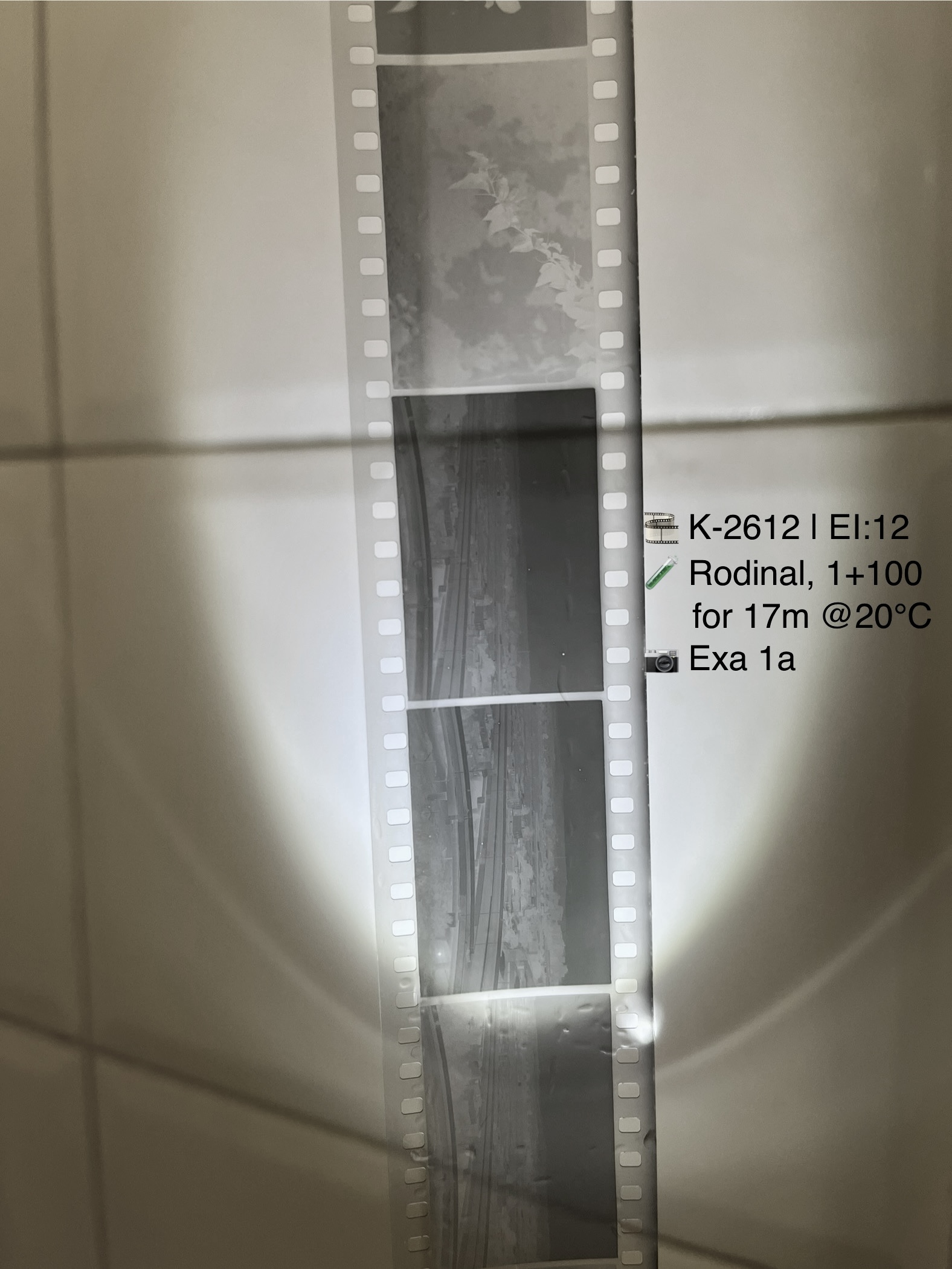

A section of the negative to show the issue of fog around the perforations, associated with developing in Rodinal for 18 minutes.
I managed to decrease the fog to almost nothing in later tests by estimating ISO at 12, shooting in broad daylight and reducing development time to 17 minutes, as shown below:
I think your experiment has a fatal flaw that renders it virtually useless. The 'green' you see on printed media (including your LED remote) is composed of (mostly) cyan and yellow ink. The reflection spectrum of the cyan ink can be sufficiently broad as to give the impression that the film 'sees' green, while in fact it doesn't. Note also how the halftone dots on the green buttons show up:
If anything, this demonstrates that the film images this mixed green color (which really is only green to the human eye, not an actual green like e.g. chlorophyll) quite differently from how it appears to your eyes.
So no, the experiment doesn't show what you think it does, and in fact leans more in the opposite direction.
You can fairly cheaply get a prism on e.g. AliExpress, assuming they will ship to Egypt. Or any other outlet of mass-produced Chinese stuff.

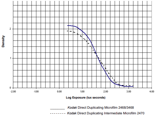

Great examples, thanks for posting those @Yezishu. I googled a bit and found some data for 2468 here: https://www.shopscan.com.br/wp-content/uploads/2011/02/D-32.pdf
Note its high UV-sensitivity and otherwise somewhat fluctuating orthochromatic profile. This seems to be reflected in the sky of the second image, that struggles to make good contrast with the buildings in the background.
Looks pretty steep, too:
So again very much in line with what you report.

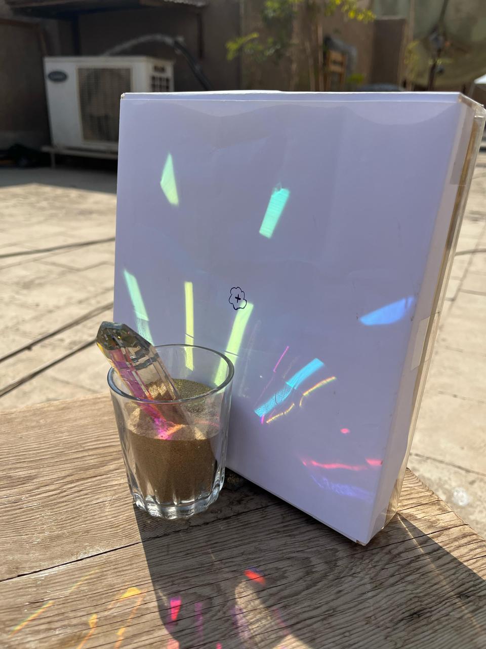

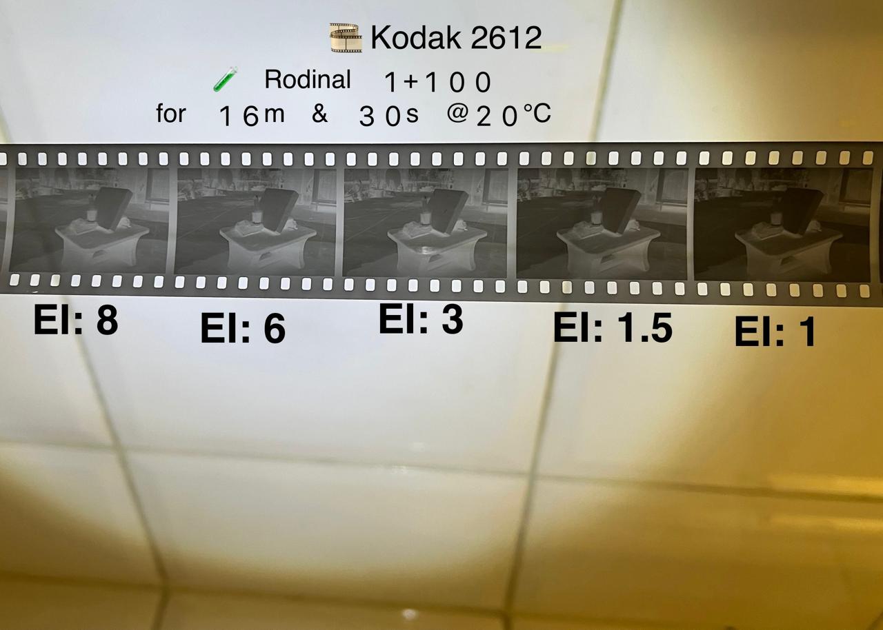

Following up on my experiments with Kodak 2612 and Rodinal:
I found a glass crystal that breaks down sunlight in a somewhat similar way to a prism, but I’m not sure if that’d be good enough to determine whether the film is sensitive to green or not, i decided to use it anyway until I find an optical-glass prism. I located a shop that had it but it was currently out of stock so, i'm waiting for them to restock.
Meanwile, I shot a bracketed test roll between EI: 01 and EI: 12, as a means to re-estimate the optimum ISO of the film in daylight that works with the 16.5 minutes of development that proved to decrease the fog to a minimum.

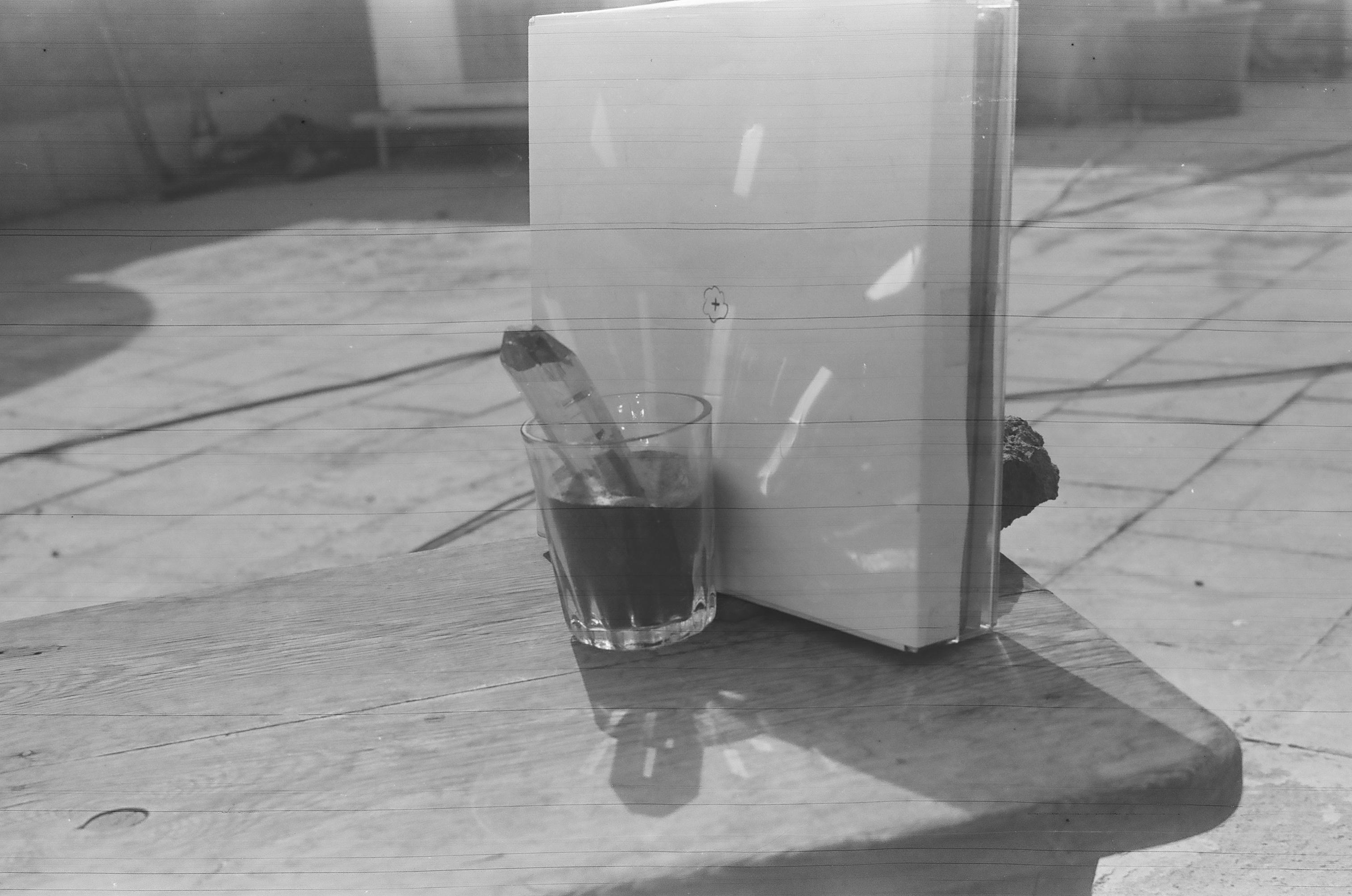

Annotated shot of the negative to show density difference and fog level
Unedited scans of the entire roll can be found here:
While the test might not be decisive in terms of green sensitivity but It seems to me that both EI: 1.5 and EI: 3 gave usable results in terms of achieving a better tonal range.
iPhone shot for reference
EI: 03
EI: 1.5
EI: 03
EI: 1.5
