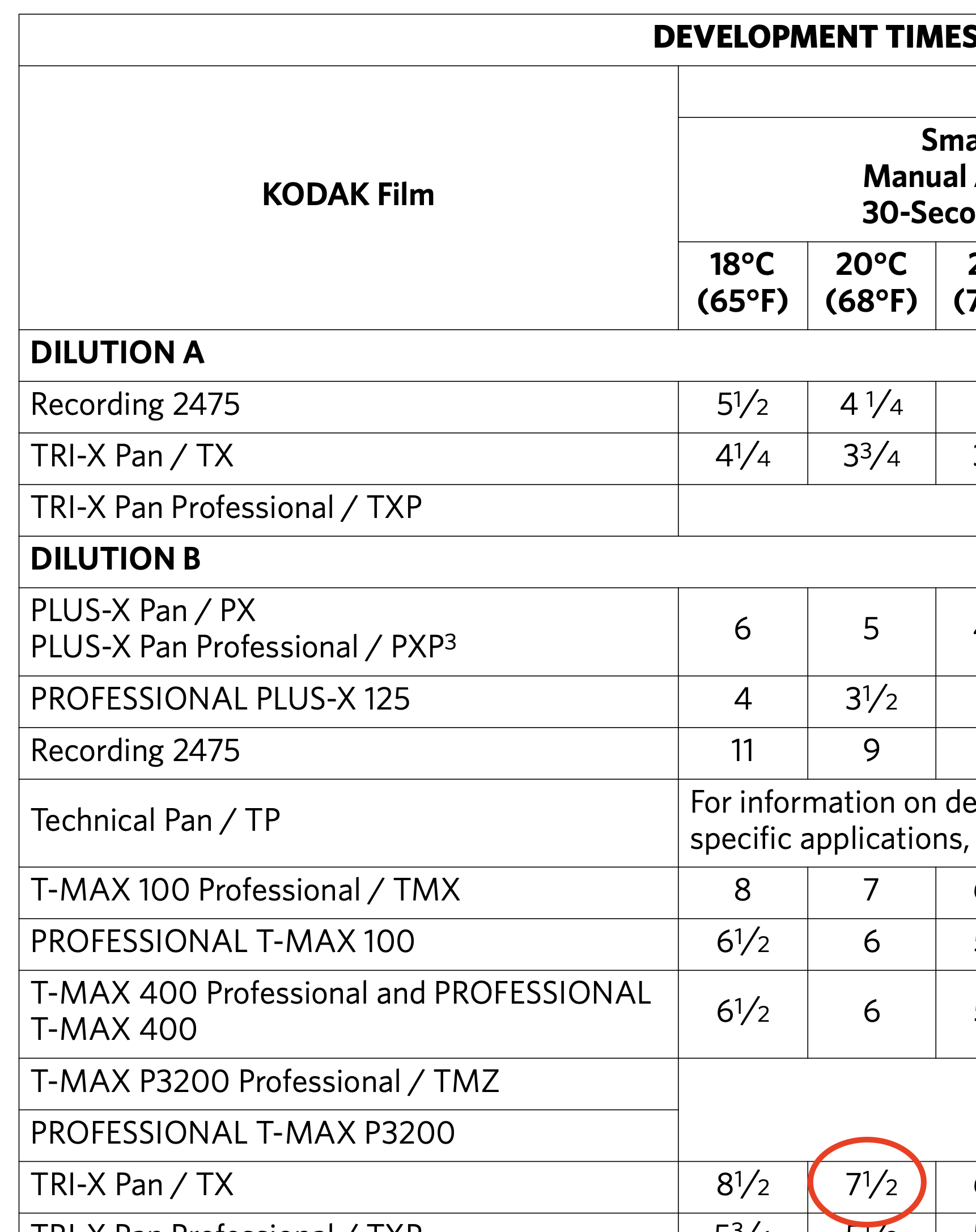

Might try this chart from Kodak which indicates 7.5min:

Yep, Kodak got the development time(s) wrong on the tech sheets for the updated Tri-X films years ago and have never corrected it (their recommendations are no longer trustworthy AFAIC). Use a different source. The older recommendations ic-racer posted above are likely a good starting time. Then adjust as needed.
