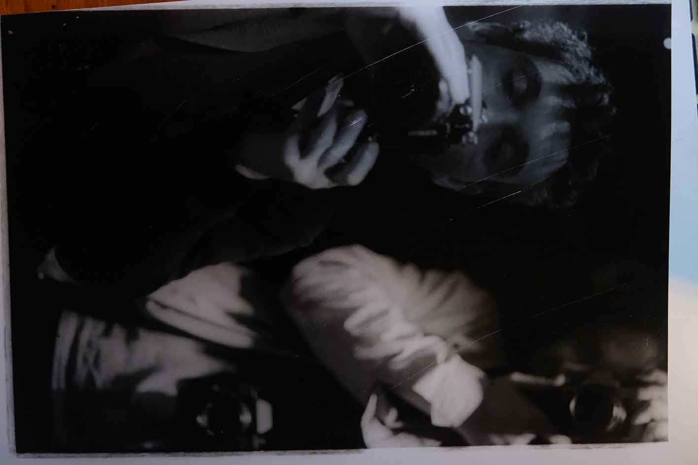

Here's what i got from print.
OK I think you think this is a form of police investigation so I will end my investigation by saying that if my statements on your aperture, filtration and additional C filtration are all correct then something is clearly not right. Yes you may have rescued the print but I thought that the best solution was to investigate why you have had to do what you have had to do to get a print and then give advice as to how darkroom printing can be made better and easier.
