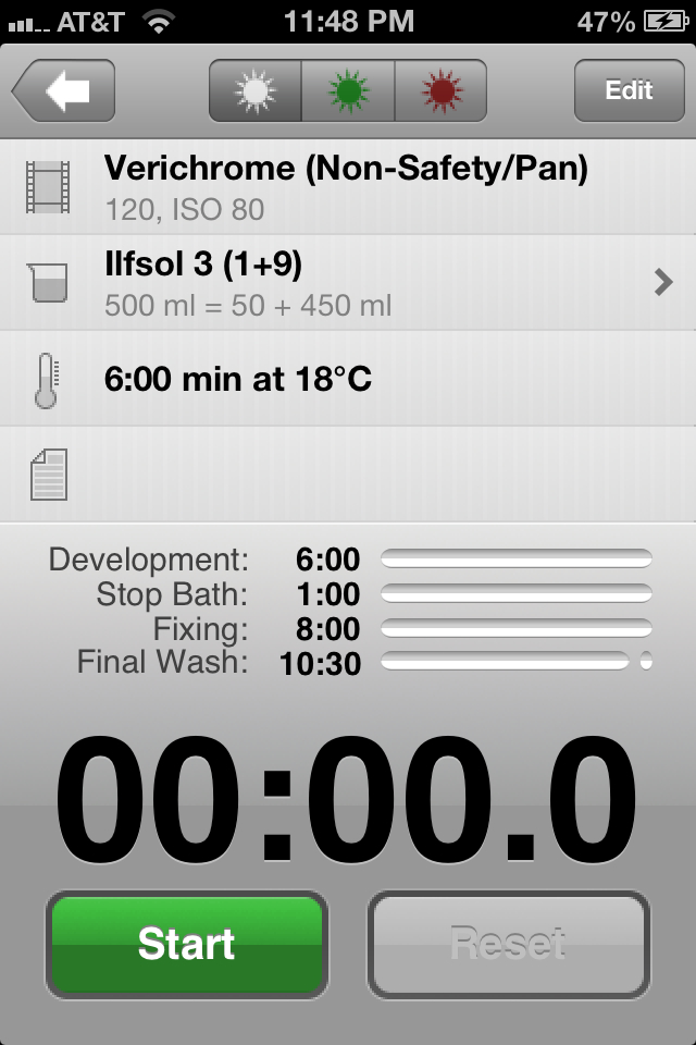

I started with the time listed for Plus-X (what Ilford's sheet calls Kodak 125 TX), which was a base of 5 minutes at 68ºF. Dropping the temp to 64ºF gave me a 6 minute development time. Ilford Rapid Fixer calls for a 5 minute fix time—I increased that to six minutes as well.
StoneNYC
StoneNYC
Aug 5, 2012
8,345
Antarctica
8x10 Format
Sorry 'bout that…
So 1:9
64°
6 minutes :smile:

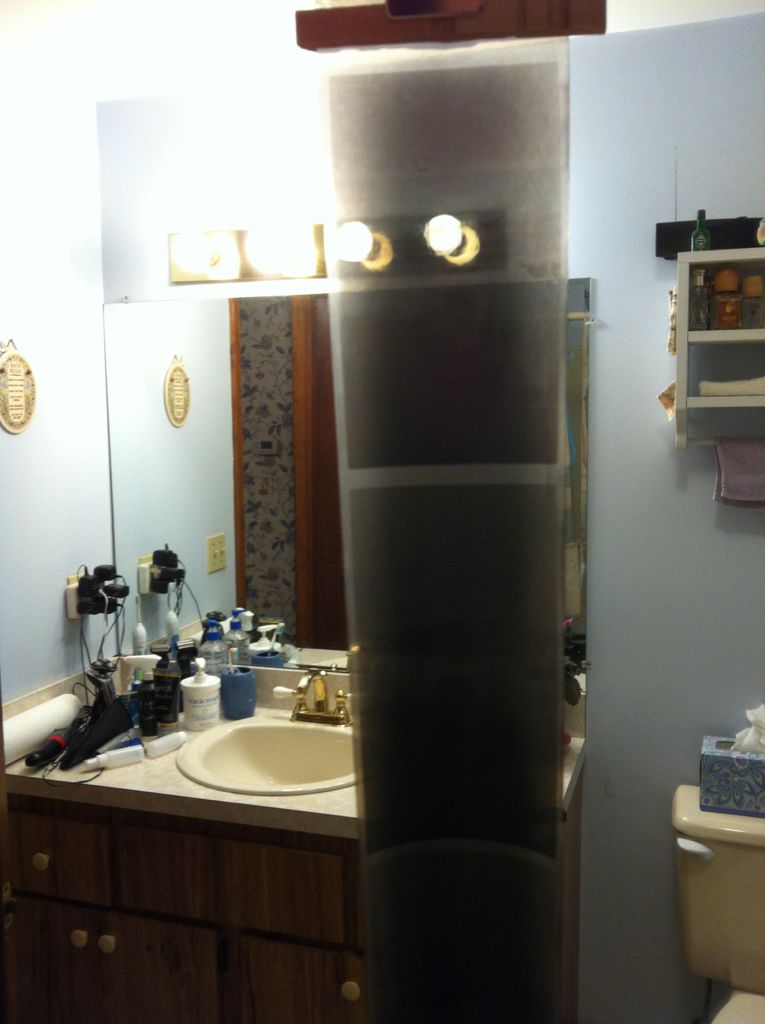

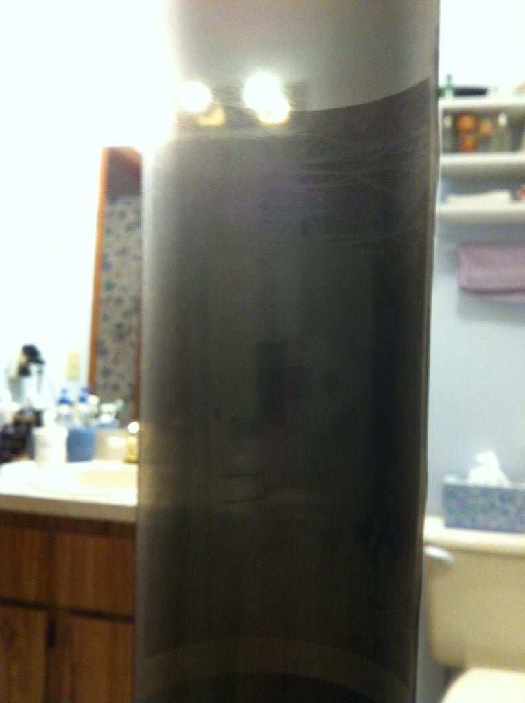

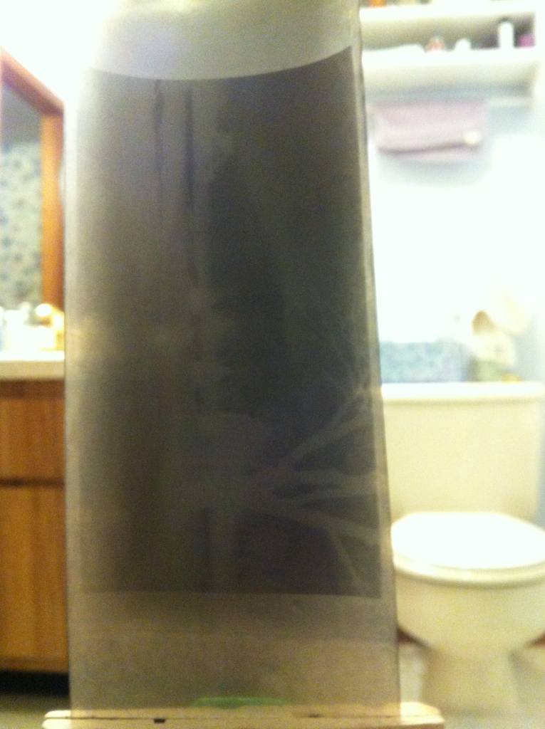

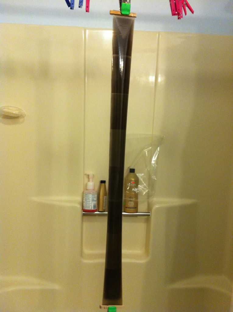

Instant Gratification!!
I can't believe some of this...
1947!!!
Super curly film...
I'm actually impressed with the fact the film is so curly but the pressure plate seems to have kept everything nice an flat even at the corners (something my No. 1 Autographic seems REALLY bad at) then again this [EDIT: Kodak Jiffy Six 16 :END EDIT] is a much newer camera... Probably closer to the age of the film, the No. 1 is around 1915/1920's
Some base fog for sure, but my calculations for exposure seem fairly on track, the two shots I took at the "I" setting are blank, so I'm glad for my 30-ish second exposures.
Well that's it, thanks to the above poster for the info on process times, I think I may try the other developer, but I would like to see the other posters results as a film and print/scan to see how they differ to the ID-11 developer image as perhaps the base fog is better with Ilfsol 3.
This was fun...
I extended the fixer a lot just to be sure. Final times...
Yay APUG!

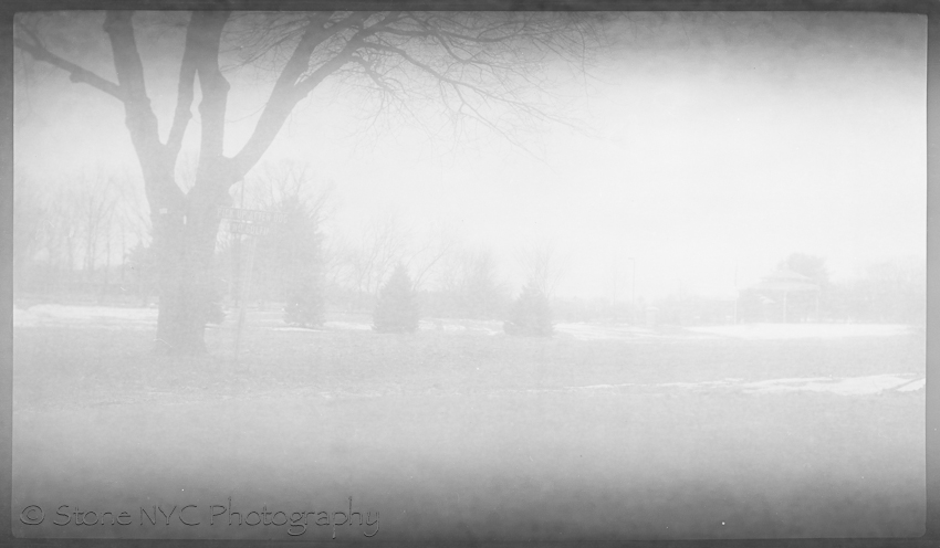

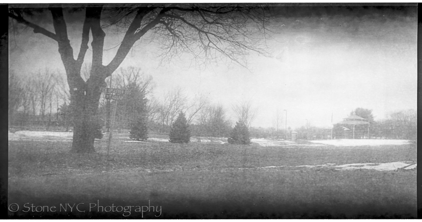

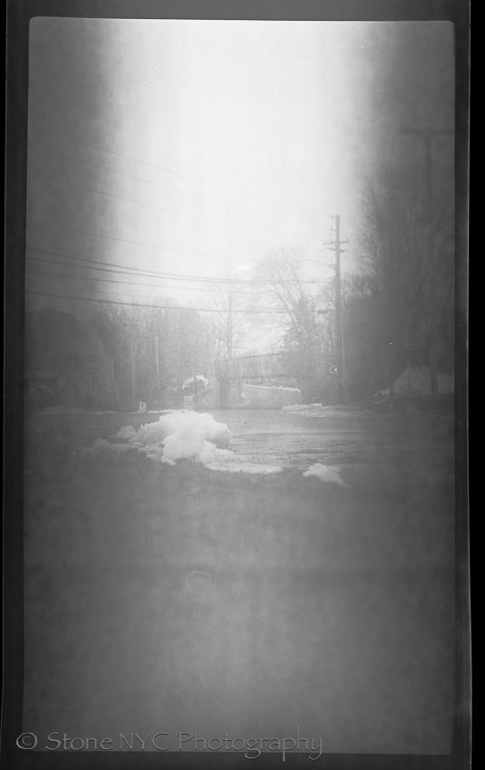

Results... sort of...
This isn't the final scan, but I wanted to do a test run and "show off" hehe. I'm going to play with the height if I can figure out a good way to, as they don't make (or I don't know where to get) a 116/616/70mm holder for my epson, I have to use the 120 betterscanning holder and glass and sort of fiddle with it and put it in funky places... it usually seems to get me something better than nothing, this seems to be severely "blurry" but I can't tell if it's just the focus point, or the emulsion that because of the age doesn't take to light well, or what, so I give you the
"RAW Scan"
And also a slightly touched up scan using Lightroom 4, but nothing I couldn't have done in the printing process if I had (and knew how to use) a darkroom.
Thanks to everyone, this was a really amazing day for me!

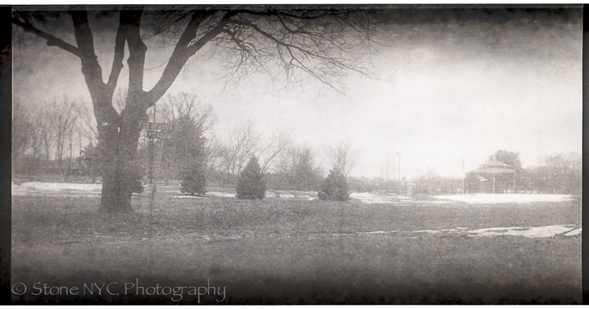

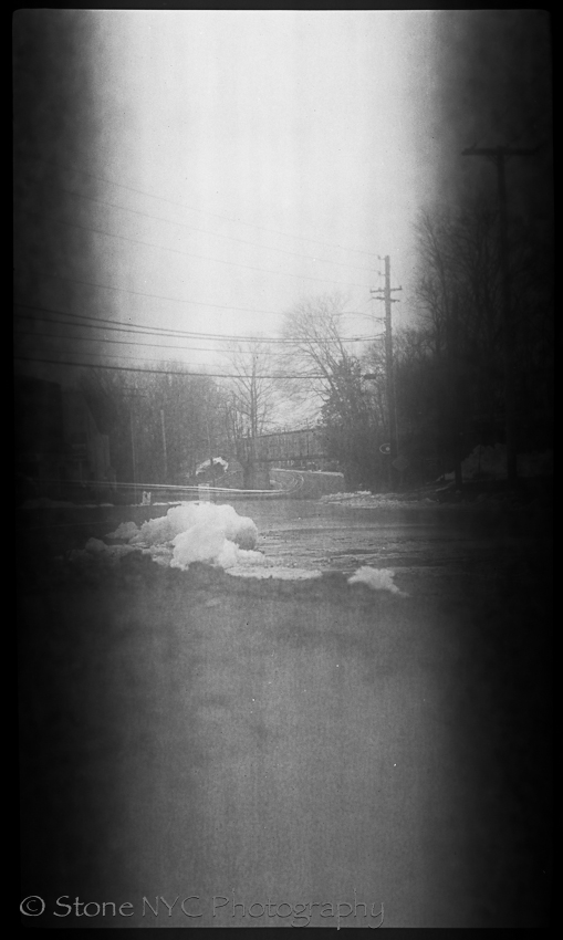

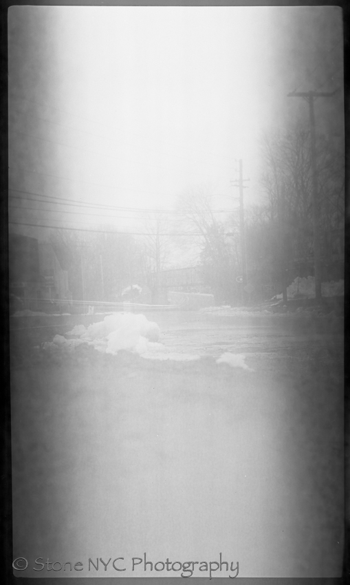

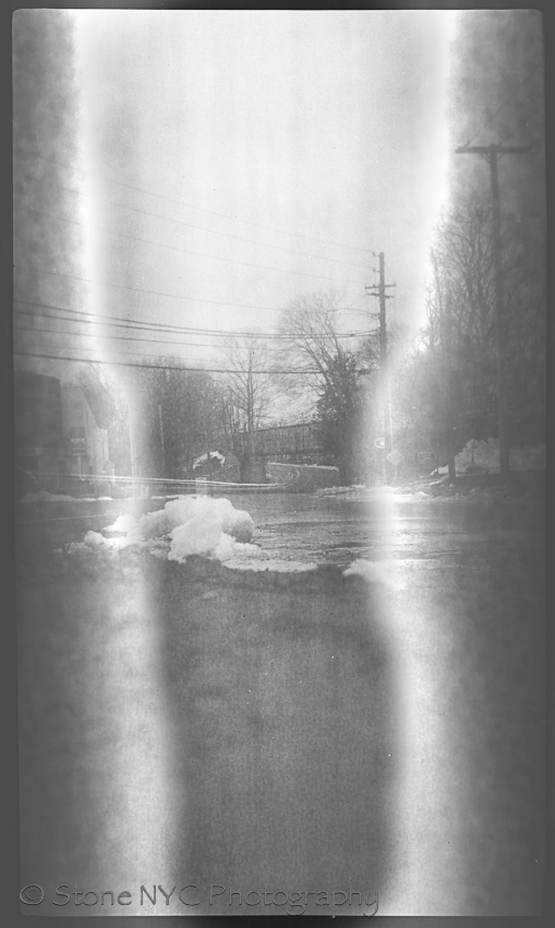

OK second scan done, this time for some reason the image was even more blown out, the distance from the lens was less and I can now actually see the grain so I know I'm at the right height-ish but I'm actually using the Epson scan program, I can't understand how to use SilverFast, someday, but this means I had to edit the photo again in Lightroom 4, this time I can actually read the sign post, however just FYI in the larger versions this is much more obvious that there is an issue, but as we know APUG doesn't allow large image sizes so this is the best I can do... again...
RAW scan...
And the adjusted scan...
Thanks again everyone! this was fun, now it's time for bed and ice cream!

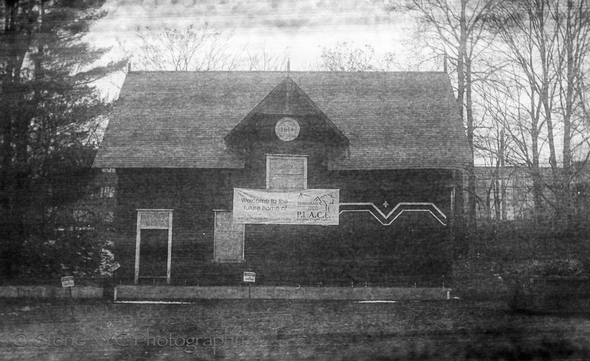

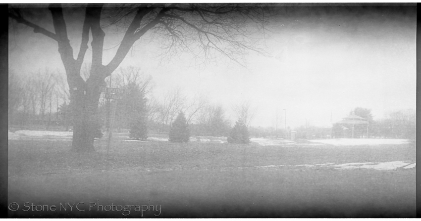

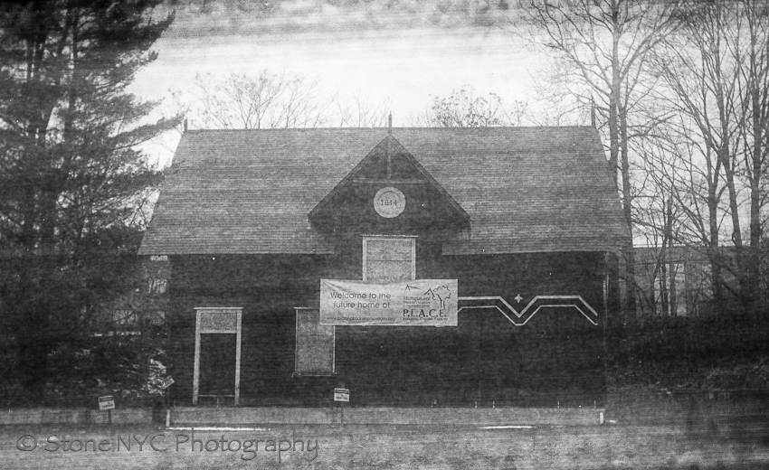

Sorry to multi post, but this is exciting to me, the next two are a different location, they actually didn't need any real adjustment at all, the scan came out "great" so this one was on my car roof so it wasn't quite level so all I did was crop the image to be straight.... two shots at different exposures 20 seconds and 30 seconds, I guess because of reciprocity failure/age or something similar, it didn't make much difference, they both look about the same in exposure.
OK three more to go, the next ones I did in the middle of the road (on a mini island) in the morning, curious to see if any passing tail lights showed up...

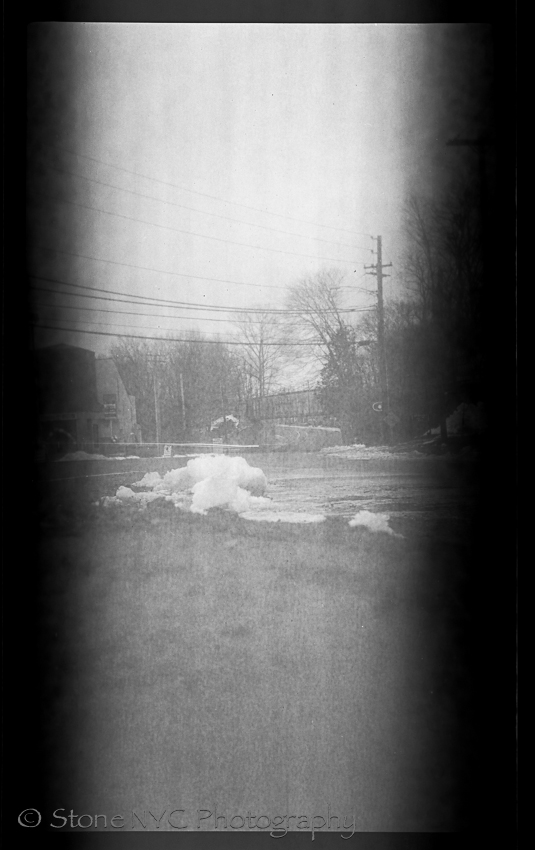

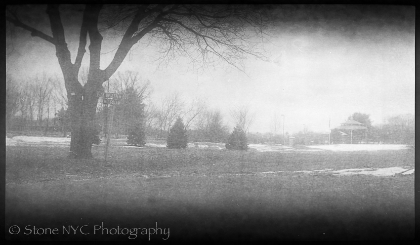

OK last 3 scans, now I'm not sure how OK this is with the APUG guidelines but I want to be clear I'm only showing different versions because the film is so old I thought it would be good for people to see just how messed up the film is and how much damage has been done by time.
These first two are almost direct from the scan with just a hair of an exposure lowering (maybe a half a stop), and the second is the second image with a lot of exposure adjustment and some contrast and dark's pumped up to make the image more clear. As you can see the edges of the film suffered the most damage from I assume the oxygen/atmosphere/industrial revolution haha, so there's a really bad fog, whats strange is that it doesn't seem bad by the naked eye, it's only in the scan that it shows up heavily, and worse when adjusting the dark/shadow levels. I'm not very experienced with this so I don't know how badly this would take effect in an optical print, but I would assume it would be similar.

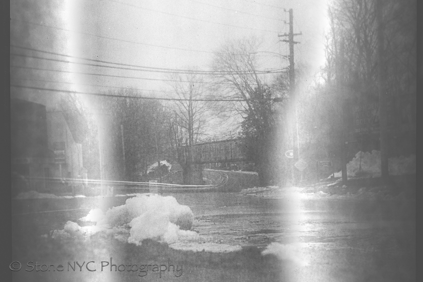

And last but not least, the final image... there are 6 images preceding... this is the one I'm worried the moderators will be upset with but since I can't dodge and burn the old fashioned way, I"m trying it this way (and mind you I only learned ANYTHING about Photoshop YESTERDAY via a phone call to a friend who guided me through a few steps to get rid of dust and bad color saturation, so it's a MESS. But I wanted to show through dodging and burning techniques that even the edges of the film could be salvaged. I did a terrible job and there's a really bad "line" where the edge of the natural image drops off and the heavy burning begins, but hey it's an example. The last image is an almost 1:1 so anyone curious could see some of the grain if interested. So in order...
RAW scan...
Adjusted blacks and highlights and exposure level for "optimum" image
Exported from Lightroom to Photoshop and upped the exposure slightly and "burned" the edges in.
Sent back to Lightroom and brought back levels to "optimum" image settings. (notice 2 and 4 here in the center area are now the same exposure).
Now this image is sort of what I had actually wanted to shoot, but the Kodak Jiffy with its 110mm lens didn't actually have a tripod mount so I had to shoot far away or get run over by a car. The image size is so large so I can still crop it a LOT with 'good' image detail.

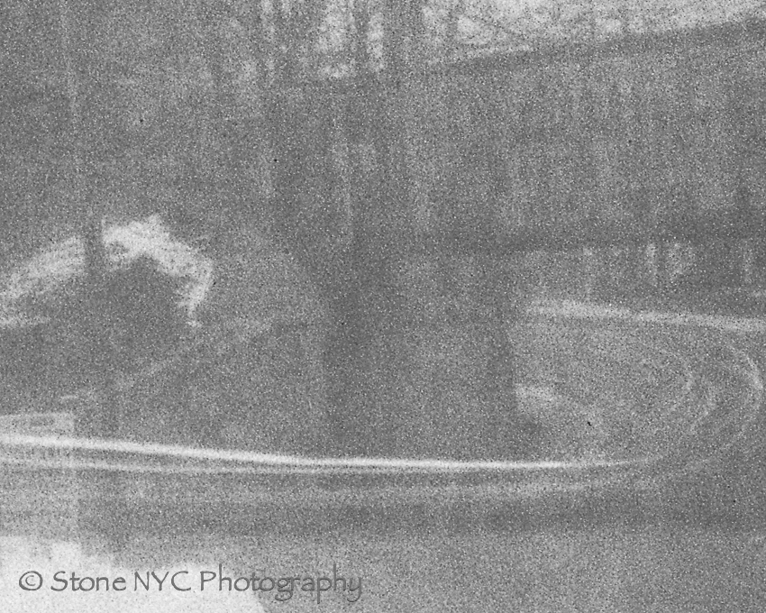

and for the pixel peepers... an (almost) 1:1 of the scan at 2400ppi ... it's not fully 1:1 because the 850 limit made the image slightly smaller than the crop I had made and I don't feel like re-doing it just for this, it's close enough you can see the grain...
ok that's it, I'm REALY going to bed now. I'm leaving this open for questions/comments etc. Mods don't be mad, it's not every day you get to see 60 year old film newly shot, I'm sure this will aid in actual darkroom owners techniques with expired film (I hope so).
