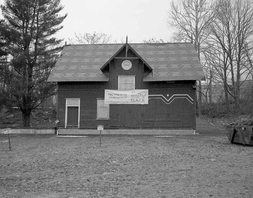

Yay! That curl was about what I saw on my Verichrome Pan roll. The neg scan I attempted was absolutely terrible since I don't have a transparency scanner; I didn't feel good about posting it at all. If I could get a couple of pieces of AN glass, though, I could run them through the enlarger.

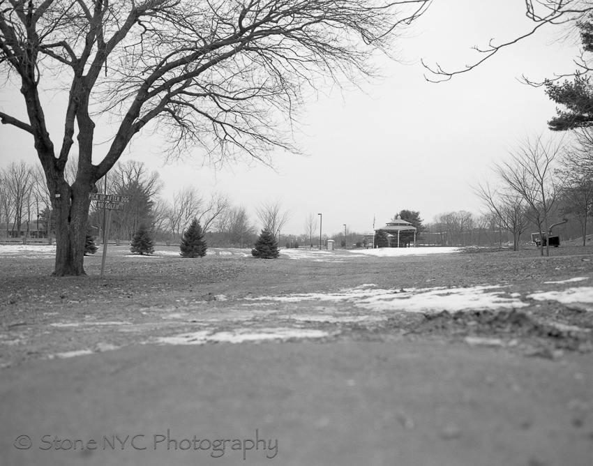

Thanks! I wish I had something more interesting to photograph, I also can't figure out if the light image is due to over exposure or over processing... Or both, I don't think I under exposed... But I don't have a lot to play with here.
Side note, I took a snippet outside and lot a match too it, it went up super fast, so I THINK it's Nitrite film, so I put it in a ziplock bag and stuck it in my Freezer. Does anyone know for sure?
Any suggestions and advice would be good, I would prefer NOT to throw it out...

More on the Verichrome Pan roll
So I finally made a contact sheet of the roll of Verichrome Pan I shot and developed. As I'd mentioned earlier, the film expired in 1965 and was unexposed. I exposed it using EI 125 as my reference in a Kodak Tourister. A 3 minute (or so) presoak at 64ºF preceded development in Ilfosol 3 1:9 for 6 minutes at 64ºF, stop bath for a minute, and fix for 6 minutes at the same temperature. The print was made with the negative strips in a file sheet, on Fomaspeed Variant 311 using a Beseler m20 filter under the enlarger lens for 8.5 seconds. I'm guessing that gave me about a grade 2.5.
Fifty Year Old Film by hgernhardt, on Flickr
I don't recall the exposure info for the first frame.
The second, seventh, and eighth frames were shot in a darkened room with the shutter open and the iris set at f/11 or f/16. I held a Vivitar 283 in hand and fired it manually.
The third, fourth, and sixth frames were exposed for 1/100s at f/32 in sunny sixteen daylight.
The fifth image was exposed for three seconds at something like f/5.6 or f/8. The light was provided by three LED lamps providing something like 60W tungsten equivalent.
The curl on these negatives is still significant. I've taken advice from another poster in this thread and rolled the sheet into a tube such that the strips are emulsion side out. Hopefully by tomorrow or the next day they'll be flat enough for me to work with them in my flimsy card stock negative holders.

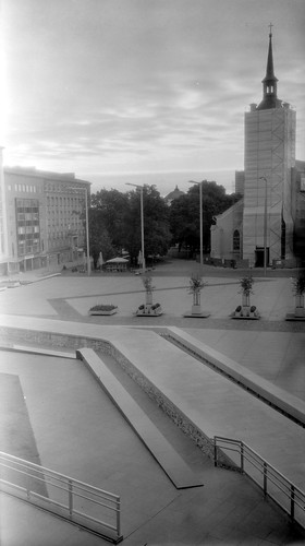

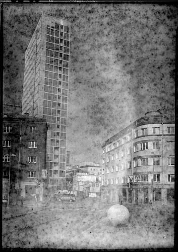

Old film can amaze at times for sure. My adventures with the 40's stock:
1949 expired 5x7 Kodak Super-XX, exposed and developed 2010
and
1944 expired 5x7 Gevaert Ultra Panchro
Super-XX is basically fine, just ruined a bit by interleaving paper, which probably got some moisture at some point in time.
and
Wow those are fantastic, especially the super-xx it's too bad shoot the paper splotches because the buildings look great! I like the crispness of it.
The Gaevert is sort of foggy like it was a soft focus shot, and obviously one side was exposed to light over the years. Thanks.
Were either of those Nitrite based emulsions? I am REALLY curious about any knowledge on this...

Just a note that there was Verichrome, an ortho film, before there was Verichrome Pan and I don't recall when the transition occurred, but I think it was about 1950 +/- 5 years. I also don't know if there was significant difference in how they responded to processing. But it might be someone's experience with a roll from the 60s might be different from one from the 40s or early 50s due to other factors than age. (Just sayin!)
But it's pretty impressive the stuff works at all, definitely a cool experiment. A couple of years back I discovered, in an old camera here, a roll of Verichrome Pan that had exposures on it (learned to be from 1981 after seeing the content) which I was able to recover to a surprising level of viability with HC110.
You are correct my film is Verichrome the second poster is using Verichrome Pan. I'm only aware because I have a bunch of Verichrome from different time periods.
I chose the worst roll to start with, this one had the box ripped open and the wax paper bag the film was in had been torn etc.
I have another 1947 & 1948 Verichrome in 616 and a 1951 Verichrome in 116 and a 1966 Verichrome Pan (Safety Film) in 116.
Seems the name Pan was added when it changed to Panchromatic from Ortho but I really want to know about the base, if its a Nitrite Base film... There is some foggy detail in between where they may have switched away from Nitrite but not quite used current Safety film, I just wish PE would cue in here and give more info, I wish you could "tag" people in posts here haha.
Either way the Ilfsol 3 worked even if badly(partly due to user error and age of course, I THINK I over exposed). Maybe I will buy some ID-11 and try that but I hate to experiment with new developer that I've never used before....
*Edit* it should be noted that the dates listed are the USE BY date... I don't know how long film was given from date of actual production but I assume 2 years?
Gevaert is foggy because of stand development in Rodinal plus possibly an overexposure. Never do the stand dev with aged film, it digs up any base fog you possibly have.
This one side was not exposed to light, it was ruined by me by squeezing the 5x7 sheet into 2-reel jobo tank for stand development.
Both are safety films, not Nitrite.
Cool, thanks! I don't do stand development in general but good to know about the base fog.
I wonder if that's why Ilfsol 3 worked ok, because its such a faster developer there isn't time for the fog to be pulled out....
Yes, my conclusion so far is to expose generously and use some aggressive developer with the films with known high fog. Paper developer works the best for me (Orwo N113 for 2-2:30 minutes), with 120 and up formats. It gives more grain but much more usable negative tonally. With 135 the grain will be too excessive.
