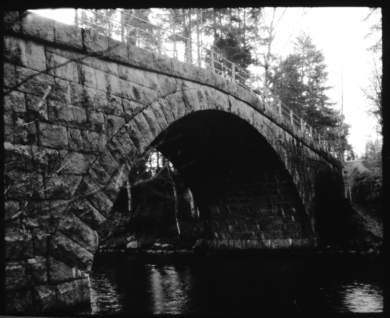

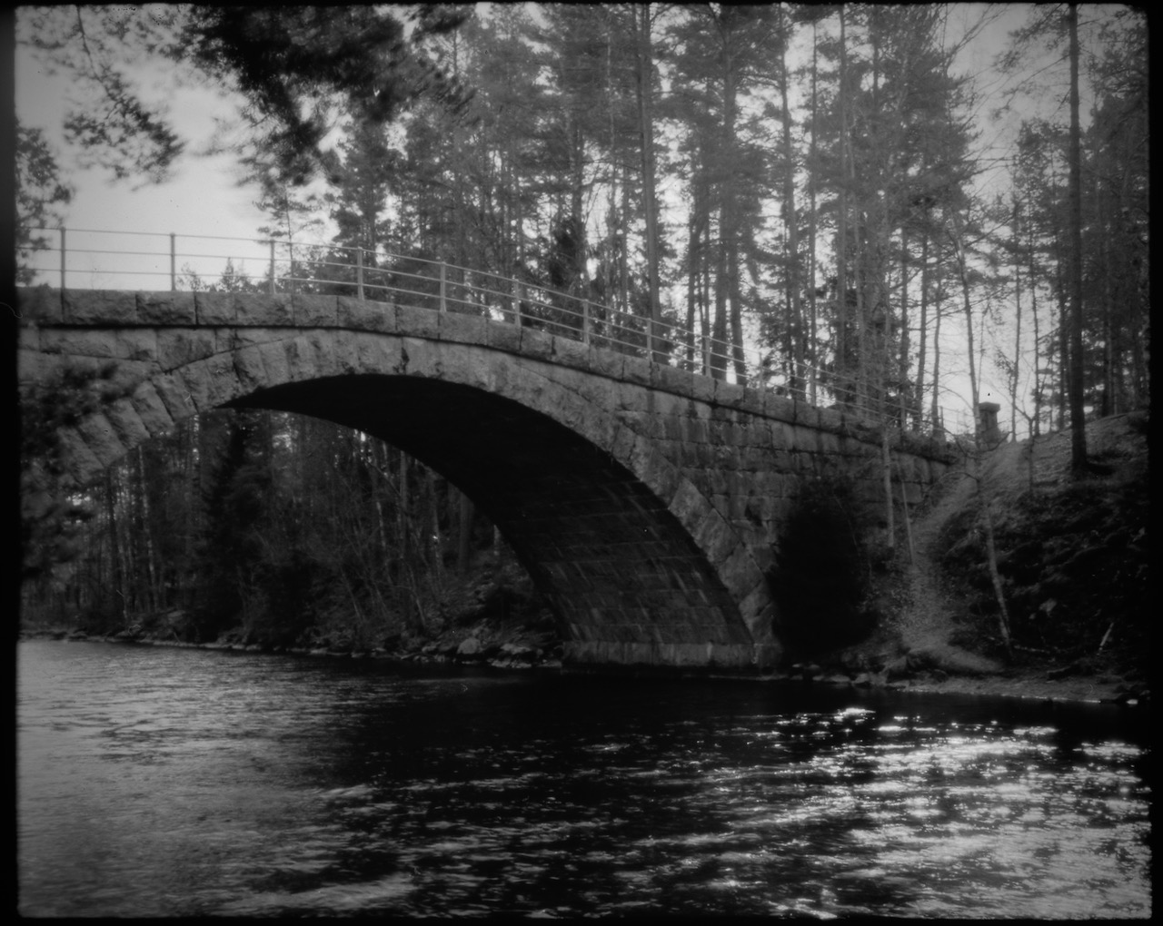

Here are my first out of the studio shots with RB67 on Ilford MG IV pearl paper developed in Ilford Multigrade developer:
Really worth shooting more and play around. Having another back loaded with paper is a fun twist to the game! (I was shooting the bridge with film back too)
I only shoot with obscuras and they tend to take high contrast photos as far as I experienced.
Your photo looks gorgeous and you can open up the lens on your rb67 so it won't pick up that amount of contrast and it's a really healthy looking experiment, a fun. What I attached is a disaster that's why I called it gambling and still don't know how to solve the issue.
