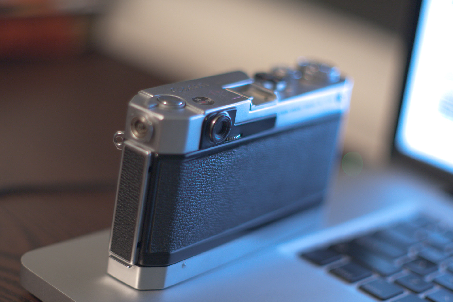

Thought I would experiment this evening. So, we wrapped the first test roll from my new Canon IIS2 around the outside of a plastic bottle that once held windshield washer fluid. Held in place with Duct-tape at each end, the tape adhered fantastically well through the developer, stop, and fixer. There were no scratches to the film since the bottle was wider at the top and bottom. The bottle also floated on the chemistry in open trays, as I spun it by it's cap-end. It worked quite well, with no surprises.
