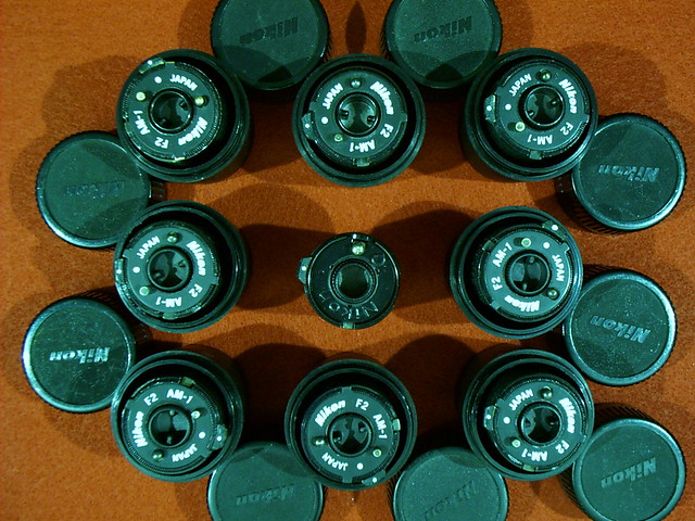

Once, I ran into a problem with scratched film when I was shooting a very thin emulsion black & white film.
To avoid scratches in the film I bulk loaded, I used Nikon felt-free cassettes in my Nikon F and F2.
Nikon F2 AM-1 Film Cassettes +1
by Narsuitus, on Flickr
