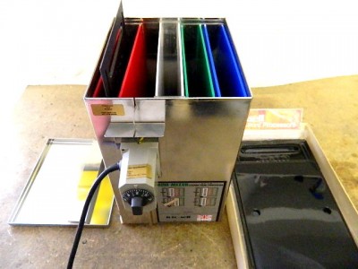

Ok, so I'm down to a few solutions. Due to space, huge trays (whether purchased or homemade with plywood and plastic sheeting) is out of the question. I have a hard enough time fitting 16x20 trays on my wet table. What I am considering is:
1. hand-rolling (like a scroll) the paper back and forth in wallpaper wetting trays.
2. The Deville system (more advanced, mechanical version of the wallpaper wetting trays).
3. Building a big slot processor similar to the Nova processor.
With that said, I'm a little confused as to the actual mechanics of hand-rolling. I've read numerous descriptions online, but I am a photographer and rely on visuals more than text. I can't seem to find a video anywhere, so if anyone knows where I can find some visual information to go along with the text, I'd really appreciate it.
The Deville system looks nice, however, likely very expensive, and again, there are few resources out there to deconstruct and DIY. Also, the same problem exists with the Nova Slot processor. I'd love to DIY one of these with thick acrylic or heavy plastic, but I'm struggling to wrap my mind around how the device actually works. Has anyone build their own slot processor?
Again, with building my own slot processor, I am concerned about the pressure the liquid places on the acrylic walls, and I have no drainage in my darkroom if disaster struck. What I am considering is something akin to the FOTOCELL MINI MIZER found on http://www.secondhanddarkroom.co.uk/. It looks to be exactly what I'm looking for, but much smaller. A metal container with heating element to allow for color processing and to hold all the chemical containers together in the event that disaster does strike and one of the containers collapses. Has anyone had any luck creating something like this, or has any advice to create this?

I built my own slot processor a while ago when I had a small bathroom for a darkroom. My homebrew was big enough to do 11x14 prints. I built it out of 1/4" plexiglass for the walls and 1/2" plexi for the bottom. It had one big design flaw in that I never factored in some kind of drainage system, so to dump one chemical, I had to dump them all and could not re-use them. That problem would have been easy enough to overcome with a bit more planning and experience in fabricating something with plastic. Mine was made of clear plexi, so it was not suited for color printing, but that could be solved with a simple change from clear to black. My design had no method of temperature control, but again that wasn't a problem as I was doing b/w printing at room temperature.
I currently own a Nova 16x20 vertical slot processor. The Nova has waffle-textured walls to the slots so paper doesn't stick. It also has a water jacket to the slots combined with a thermostat to keep the chemistry at working temperature. I THINK Nova made vertical processors as large as 20x24 but I could be wrong, and 16x20 was the biggest. Due to weight and physical stress issues, I don't know you would want to build a vertical slot processor bigger than 20x24 - when the 16x20 is full of chemicals and the water jacket is filled, it weighs in at something like 70 lbs, perhaps more. As annoying as the wallpaper tray thing is, if you're going bigger than 20x24, I think that's really the best way to go.
